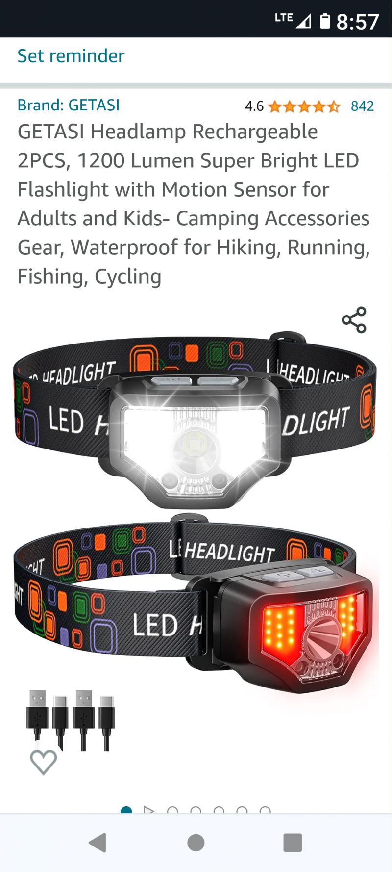

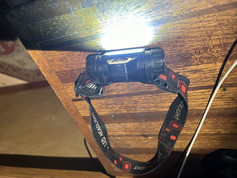

I got 2 of these. Very similar to the ones that Nobs posted. Very happy so far. Only 13 bucks on sale.

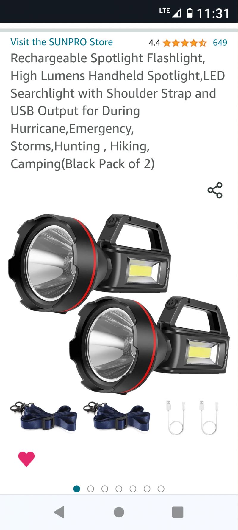

Also posting a pic of a rechargeable handheld that I've had for a while. Really great spotlight, and cob floodlight. Plus you can use it for a cellphone battery charger/backup.

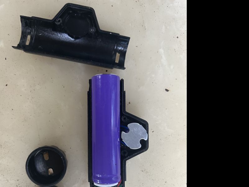

One of my rechargeable light (pictured above) wasn’t fully recharging so I pulled it apart to find an 18360 battery, surprised because it’s so small and light. Luckily I just bought a pack of 10 on EBay (you guys still use EBay or has it fallen from favor?). Anyway, just got an email from them warning about the dangers of messing with 18360s.
https://www.cpsc.gov/Newsroom/News-Releases/2021/CPSC-Issues-Consumer-Safety-Warning- Serious-Injury-or-Death-Can-Occur-if-Lithium-Ion-Battery-Cells-Are-Separated-from-Bat tery-Packs-and-Used-to-Power-Devices?mkevt=1&mkdid=4&mkcid=29&bu=43151842137&trkId=13 6032051004
# Posted: 13 Nov 2023 12:45pm - Edited by: ICC
?? In the photo, the cell appears to be an 18650 size.
18 = 18mm diameter, more or less, it can vary slightly
65 = 65mm length, can vary depending on + terminal type (flat or button) and if there is a protection circuit incorporated.
0 = a cylindrical shape cell
There are 18350 cells. 18mm x 35mm long, cylindrical
All the warnings are valid and aimed at people who may do stupid things; like carry a bare cell in a pocket or toss it in a silverware drawer. If, for example, there are conductive items in your pocket along with a cell and a short circuit occurs, the cell can very quickly get hot enough to burn you, burst into flames, and start a fire. Very fast! Li-ion cells have low internal resistance and can supply a large current instantly. Just don't be careless or treat them like ordinary alkaline cell.

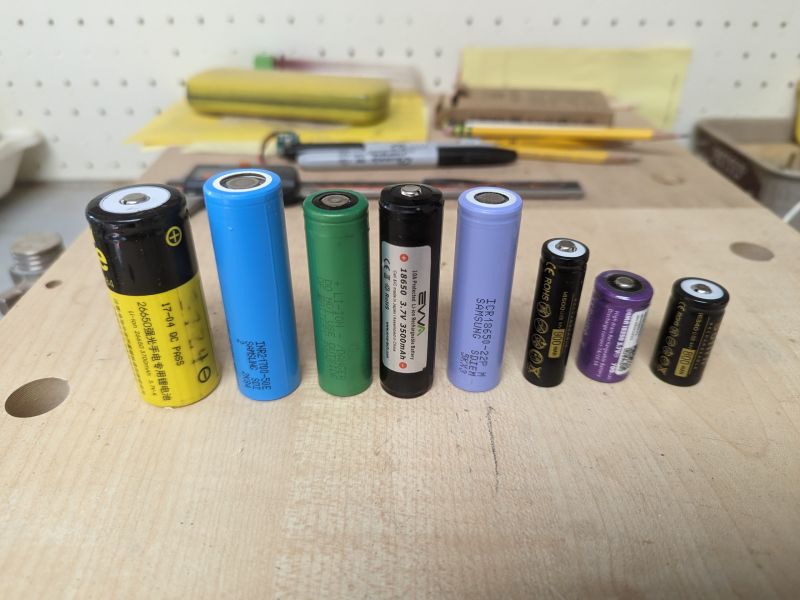

# Posted: 13 Nov 2023 01:07pm - Edited by: ICC
L to R
26650 button top
21700 flat top
18650 flat top
18650 button top protected
18650 another flat top, should have been a button top but I messed up
14500 button top (same physical size as a AA, but 3.7 volts
18350 button top
16340 button top

# Posted: 13 Nov 2023 01:22pm - Edited by: paulz
Quoting: ICC
Hmm, well I hooked up an 18650 on pigtail wires for a quick test Spent my one night a week at the city house, I'll be back out there later today. Maybe I'll just tape it on..

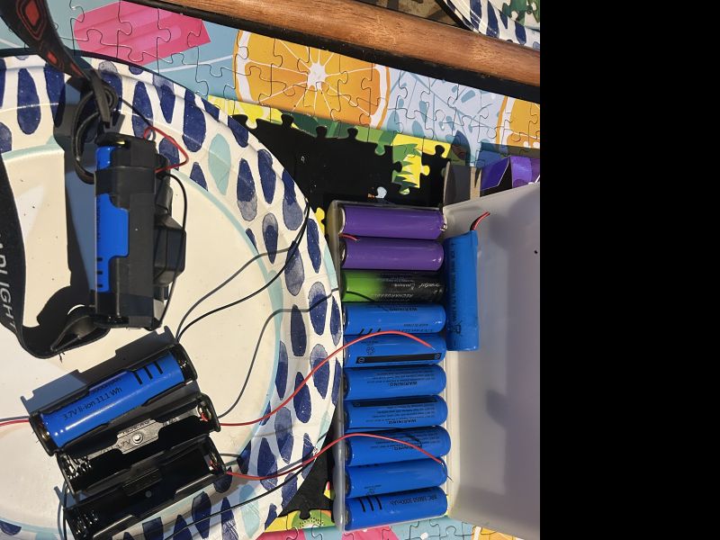

# Posted: 14 Nov 2023 10:33am - Edited by: paulz
Quoting: ICC
Right, 18650s. I wrote that at my city house, empty handed. My whole life was AA, C, D batteries, still getting the hang of this.
The bat I took out had attached leads, like most I have come across. The new ones I bought are plug in. I did solder leads on one once, which worked, but this time I heeded to the stupid people warning and used a plug in adapter. Taped the leads to the cut light leads and attached to the outside of the light. Next time, if there is one, simple swap out.
# Posted: 14 Nov 2023 02:35pm
A potential danger to soldering wires directly to the positive or negative ends of a lithium cell comes from too much heat being applied. A bigger and hotter soldering iron that gets the job done with a quick touch is better than a smaller iron that takes several seconds to heat up the spot to solder the wire to. And use extra flux, don't depend on just a flux core solder. Use only rosin flux, no acid fluxes.
Better is to use cells with nickel plated steel tabs that are spot welded to the ends of the cells. Those can be easily and safely soldered to.
Note that if a device uses a button top cell it may be dangerous to attempt using a flat top cell. The flat top might cause a short, depending on the design.
Flat top cells can also be difficult to tell which end is positive. Inserting incorrectly can be dangerous in some devices.
