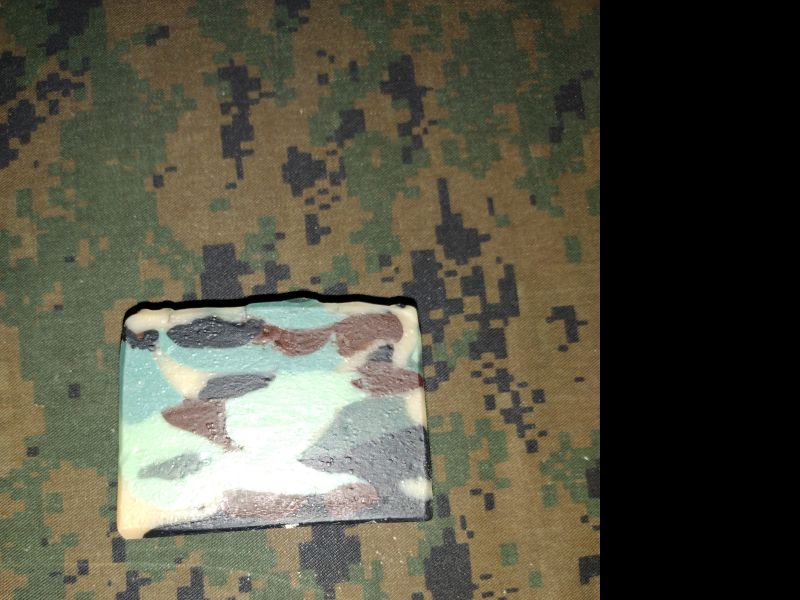

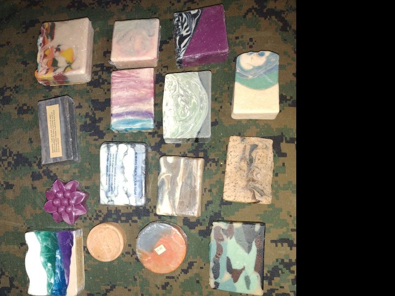

My sister does year round. It's an amazing skill.
She made me some camo unscented to use before hunting. But also makes an endless selection of custom scents, and shop soap with pumice similar to Lava.
Luckily we get the bars with imperfections.

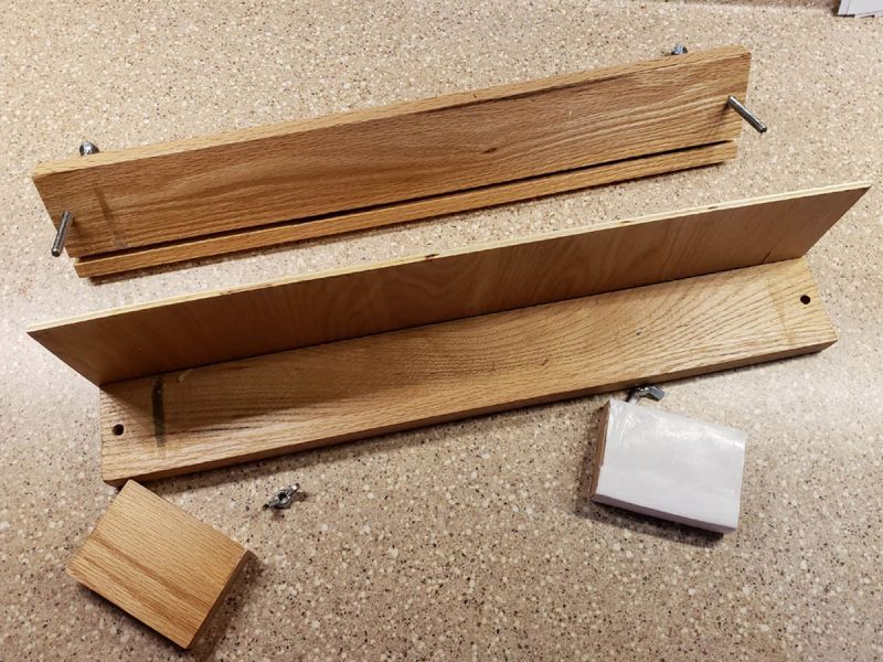

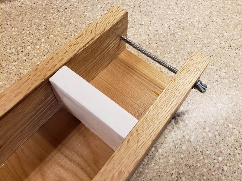

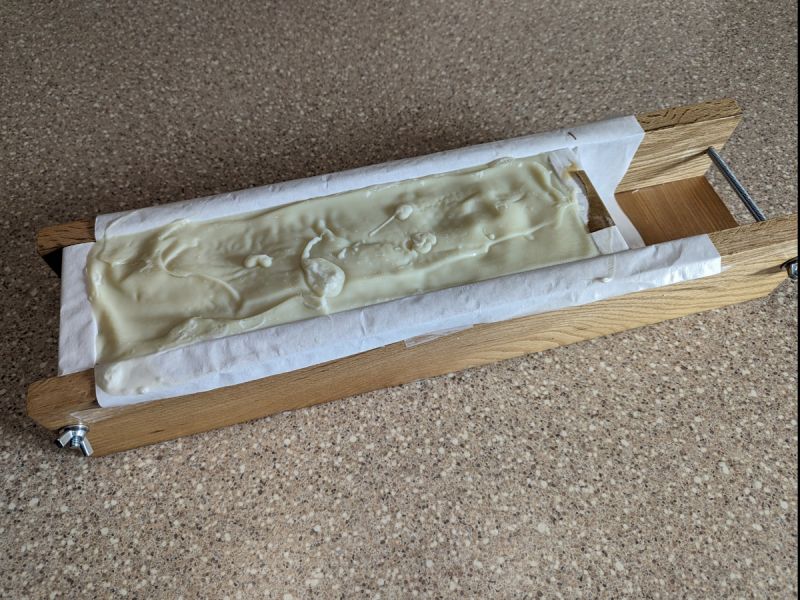

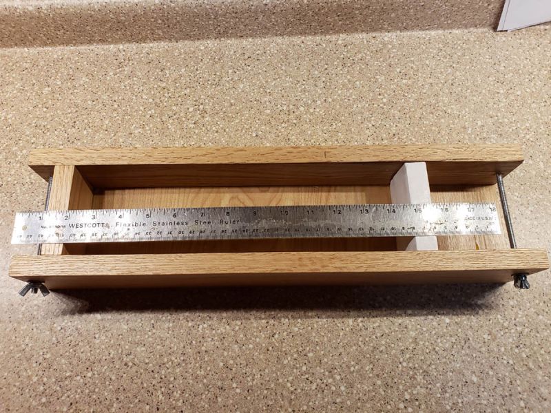

photos of the soap mold box I made (included in the PDF file. It is suitable for the half size recipe
-izzy

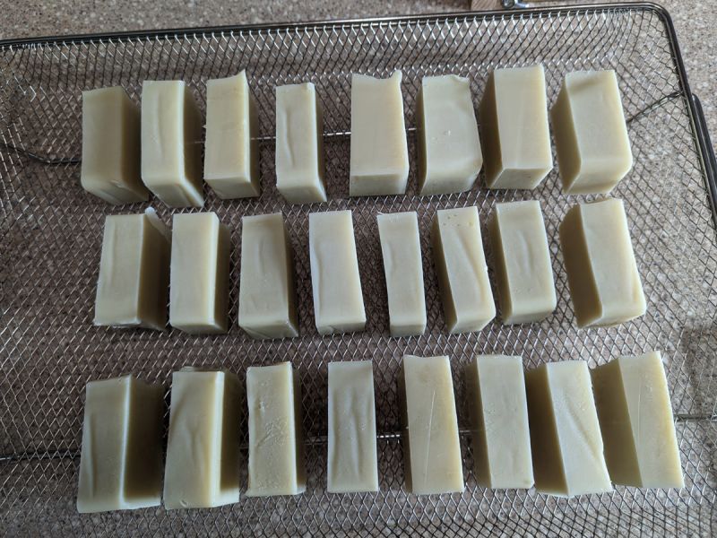

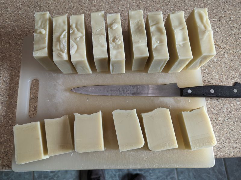

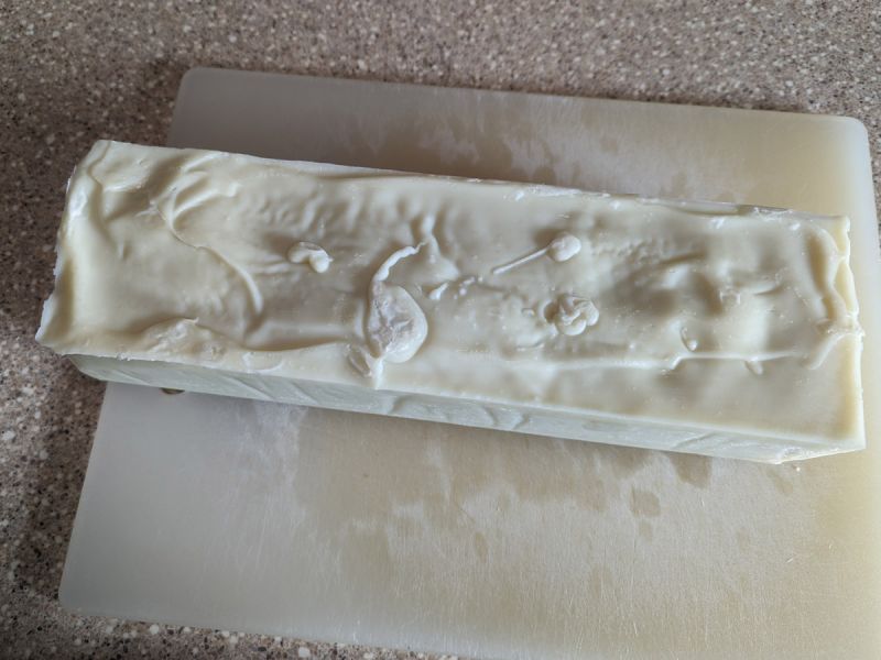

Today I removed the soap block from the mold, cut bars, and placed the bars on a rack to dry/cure for 4 to 6 weeks.
Hattie, or anyone else... if I can answer any questions drop me an email (addy in my profile) or post here. I may reply to an email quicker depending on where I am, what I am doing.

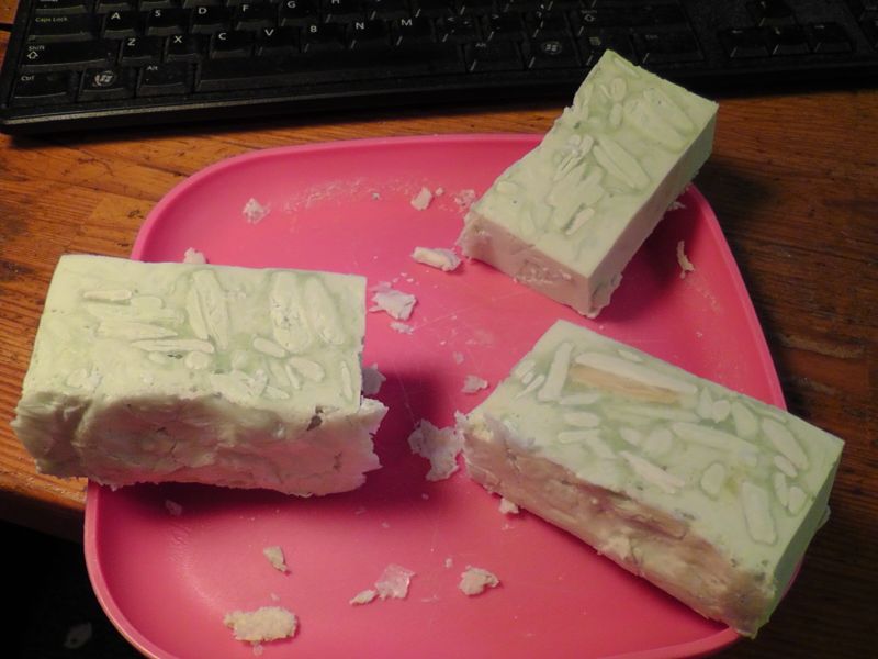

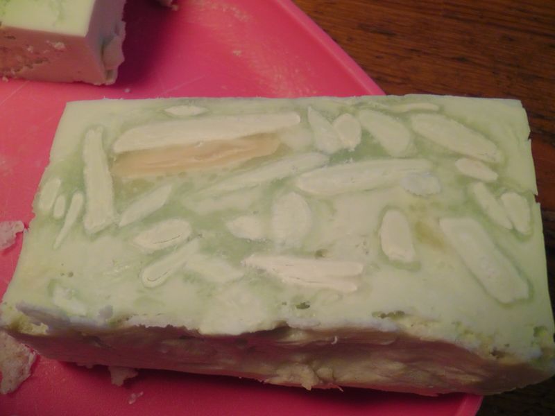

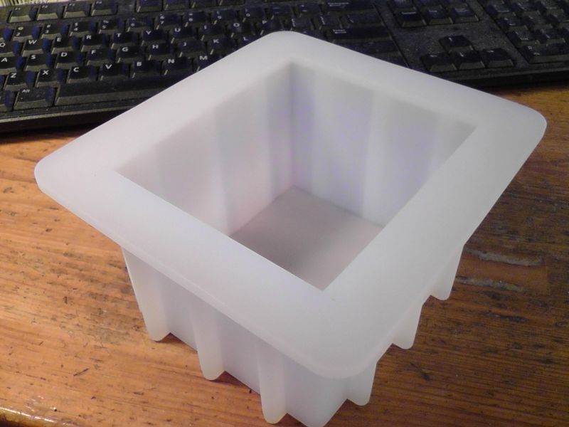

I wonder? I save the soap bits left over. Can I make new bars out of them? Bought two silicone soap molds, they go in the oven. Cut them up, added a little water and baked them per per instructions from the net. Turned out okay, they have to dry for awhile after cutting to size.
# Posted: 28 Nov 2023 09:13am - Edited by: ICC
I know someone who grates the left over soap bits and heats that with some water in a microwave and remolds when it is melted together.
Scraps of my soap can be fused to a new bar by wetting them and pressing them together for 30 seconds or so. After drying the pieces stay stuck.
