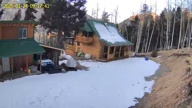

# Posted: 24 Jan 2025 10:24am
It must have gotten warm enough yesterday for the camera battery to charge. Weather app says it's 1*F up there now with an expected high of 30* . Battercharge indicator registers full.
Just no snow this year! Crazy there should be at least a couple feet on the ground right now. This is at 9,500' and less than 10 miles east of the Continental Divide.
