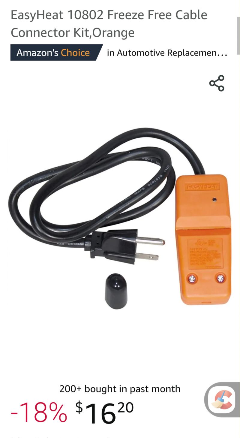

 I had a critical run of heat tape that I wasn't sure was still working, because the indicator light was acting funky. Even when you pushed the test tab, it didn't always light up.
 I knew we were getting a bad cold spell in the Midwest. And I knew there was no way I was going to crawl under the cabin to replace it. So I took a chance and bought this control unit off of Amazon. Chopped the old one off the heat tape run, and put this one on.
 Our temps got down to -6° last nite and this unit obviously worked. In fact it might work better than the original one. Don't know if the wattage is more or what. But with the old one, when it got below about 5° I would get ice crystals in the last bit of pipe coming through the floor. Not this time.
 So this might be an option for a quick repair for somebody else in a bind.

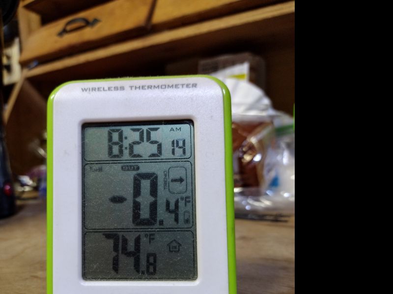

 It warmed up a bit this morning. It's only -0 outside.

 Wow. zero outside, 75 inside.  Doing that with LP, volts or wood?

 Technically the wattage should be the same.  The on/off temperature is what could be different.

 This control unit doesn't have the built in thermostat. I got that one because it's plugged into a somewhat heated store room. I have it plugged into a power strip to turn it on/off.
 I do have a point and read thermometer.
 On the heat tape side it's reading around 70°.
 It was a pretty easy and cheap fix compared to having to crawl under the cabin and replacing the old one.
