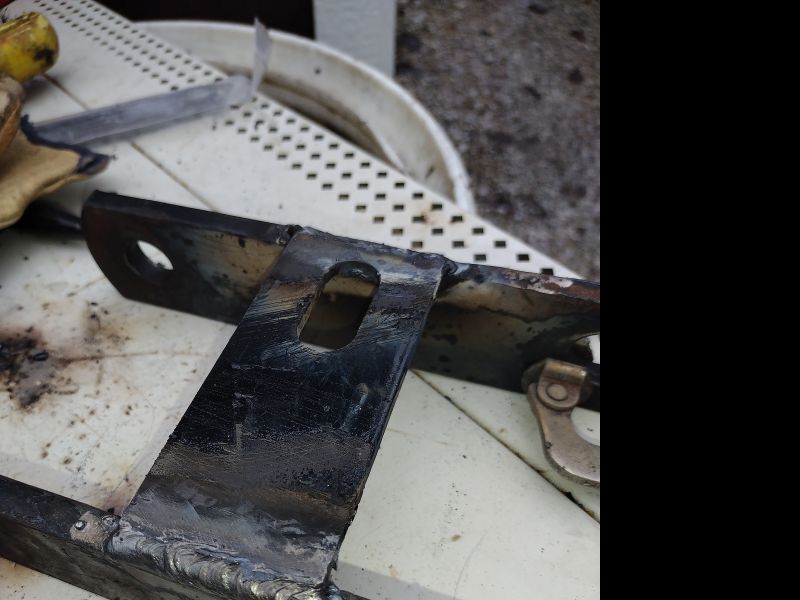

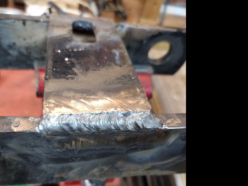

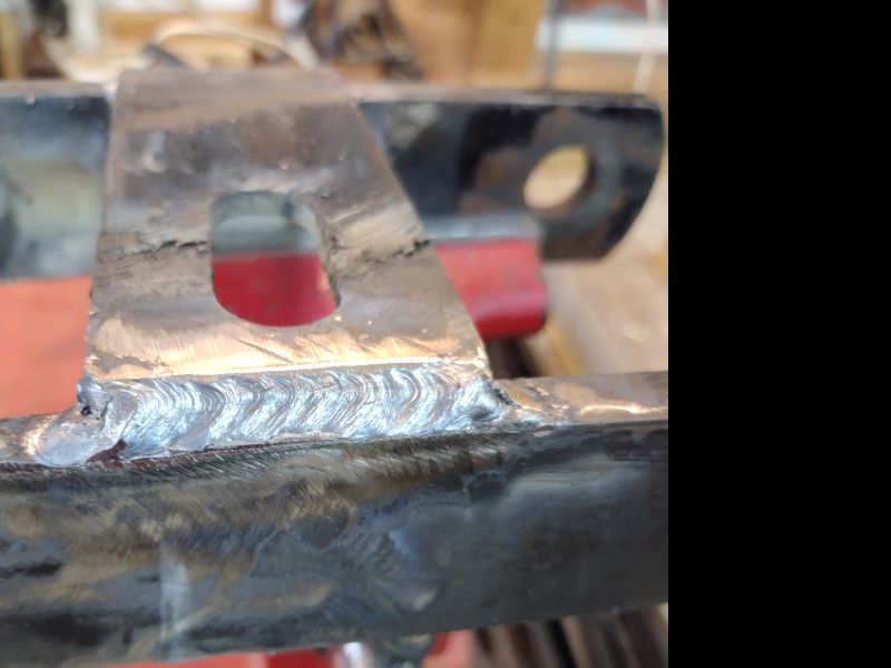

I repaired my buddy's shackle for his bush hog.
The little cracker box will weld with 5/32 6011 rods.

Decent bead, you got skills

Thanks. I was surprised it burned the rods that well. The rods are pretty old. The flux gets funky once they absorb moisture.

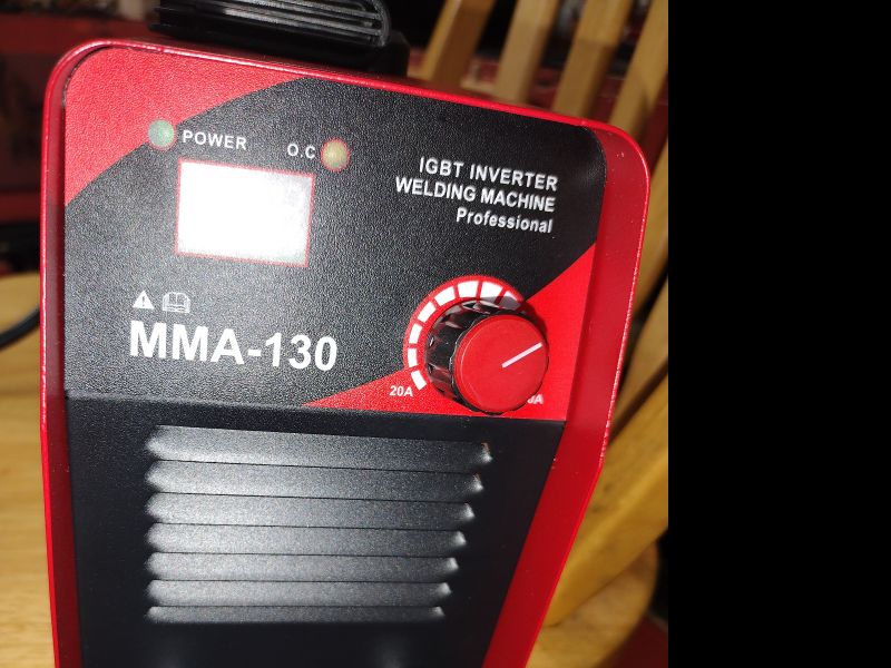

The welder they sent me is 110 only. It's the MMA130. Not the 140 dual voltage.
The amps actually go up to 134ish.
I ran those welds around 110 amps.
MMA130
MMA130
