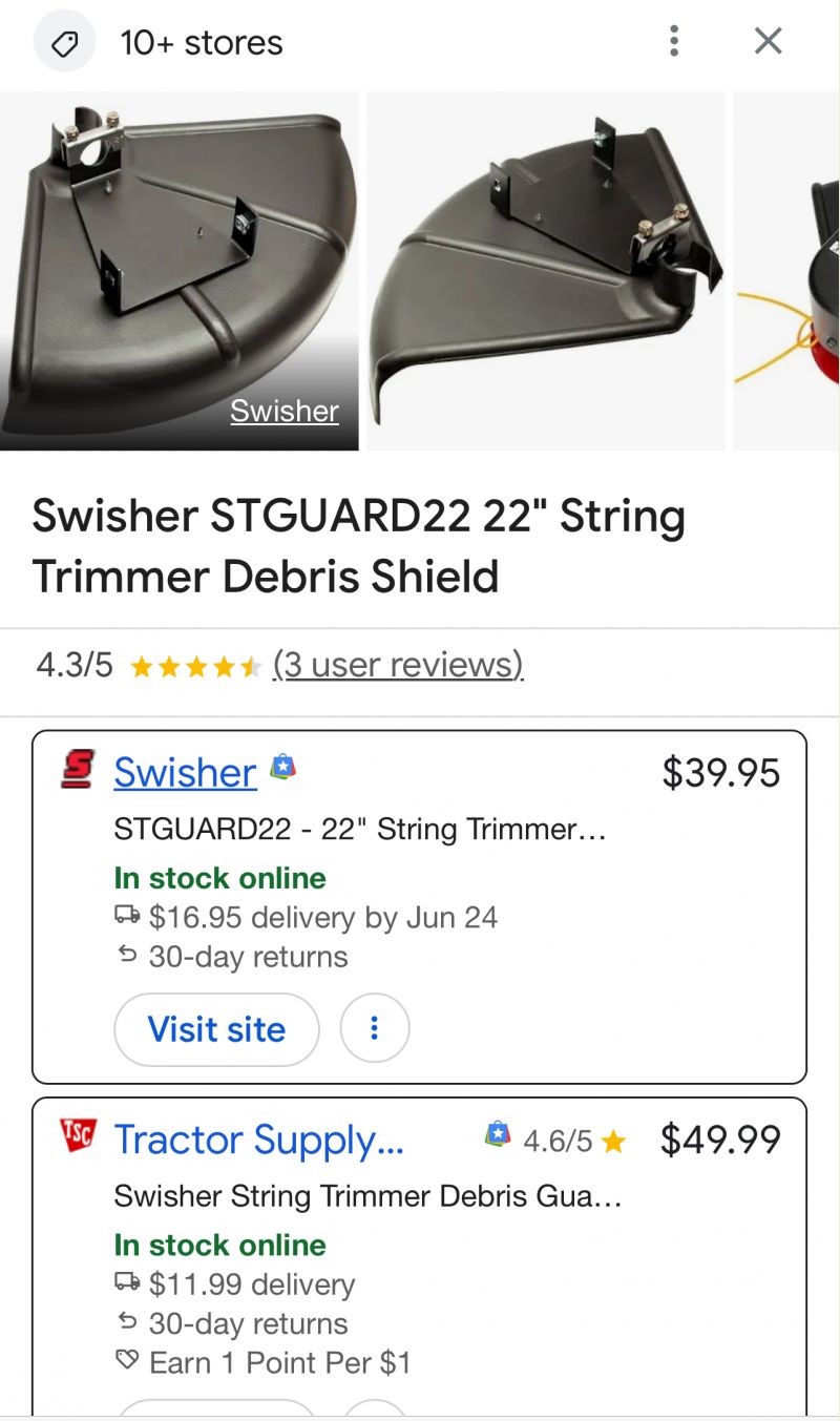

# Posted: 16 Jun 2024 06:11pm - Edited by: paulz
Never tried one

The methods that focus on the operator and not getting too close, or specific attachments, etc., might be impractical here. Were I to be the one doing it all the time, I'd be able to be more careful or utilize one of the attachments. Half the time, the maintenance done here is when we're absent.
