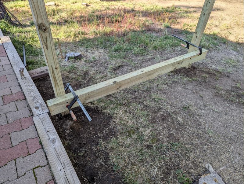

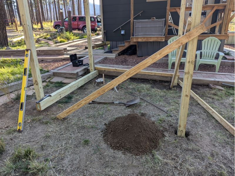

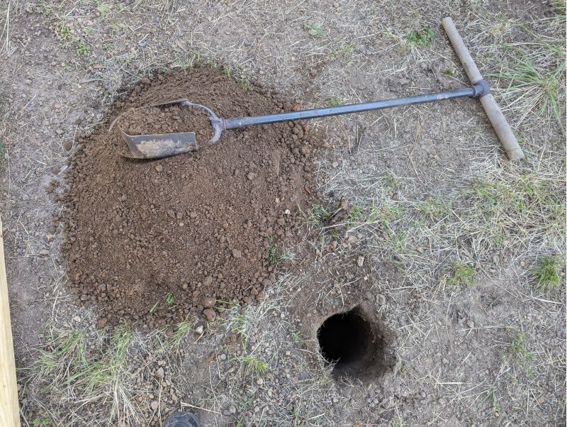

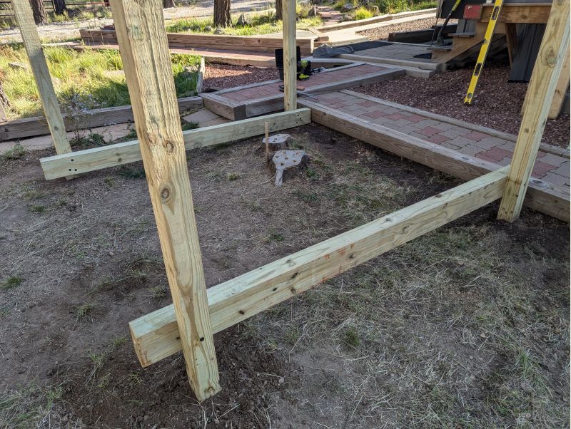

Not sure about some details. I may want some shade screening on the south side. Perhaps a partial roof for shade? It was decided to build a modest 8x8 deck. Near ground level. So I started with four corner posts to be set in the ground. Four 4x4 PT x 12 foot dropped into 42" deep holes. (The max depth of my manual post hole auger).
I dug three holes yesterday and the fourth this morning. Rammed all the soil back in each hole with my digging/tamping bar. No concrete.
Two PT 4x6 beams connect pairs of posts. Joists will be laid across the beams and then 5/4 x 6 PT deck boards.
Manual post hole auger, 42"
3 posts in, 4th ready to backfill
Bessey clamps are the best
Beams level and secured with HeadLOK lags

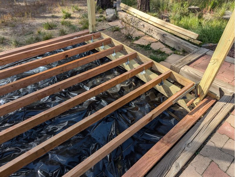

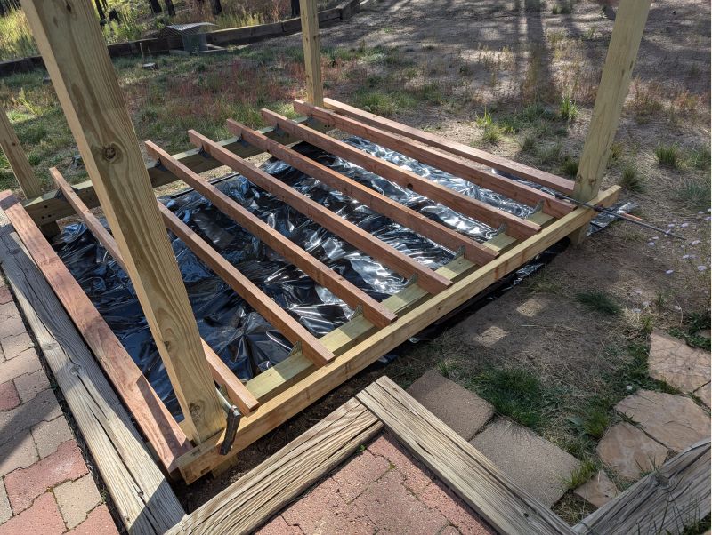

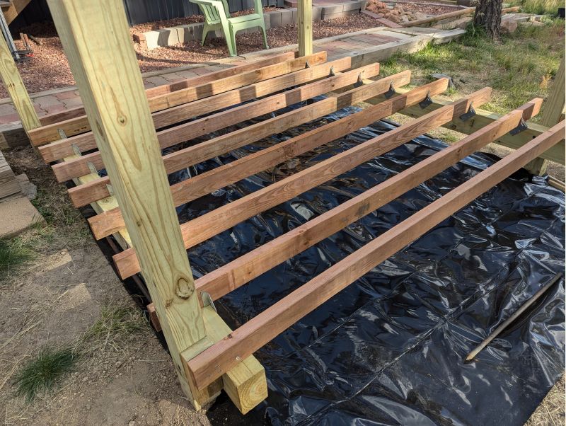

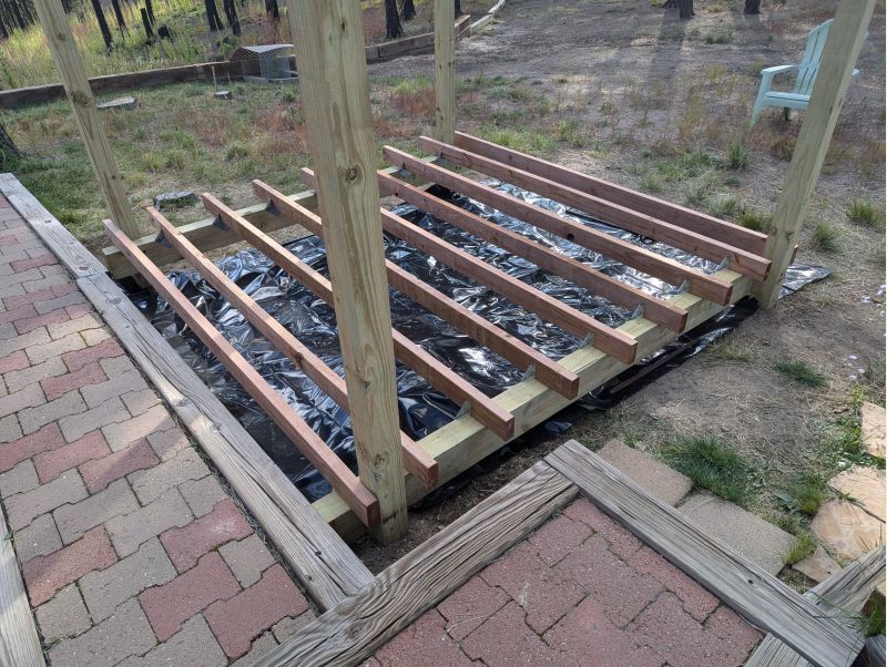

More. I went back to town and picked up more lumber and some used 8x16 patio pavers I was offered for free. Then back at the cabin I laid out the joist centers. I often use H1Z hurricane ties for locating and mounting deck joists. Yes, those are 2x4 PT joists. It is not a big party deck. The AWC calc indicates 12"OC is okay for the span distance I have. (84"). 5/4 x 6 PT southern pine deck boards will be used. 6 mil black plastic to help keep weeds at bay. Tomorrow = deck boards.
Floor1
Floor1
Floor2
Floor2
Floor3
Floor3
Floor4
Floor4

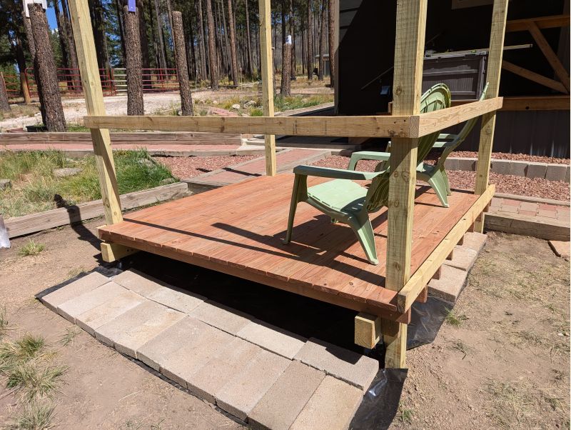

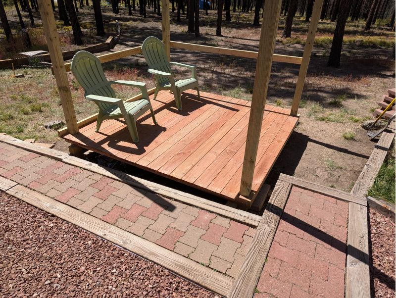

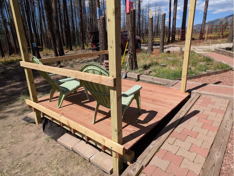

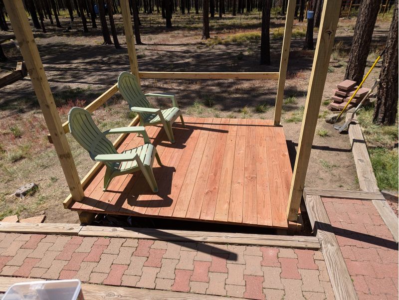

Decked! Handrails may be temporary while we think out what comes next
1
1
2
2
3
3
4
4

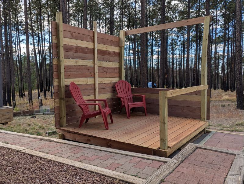

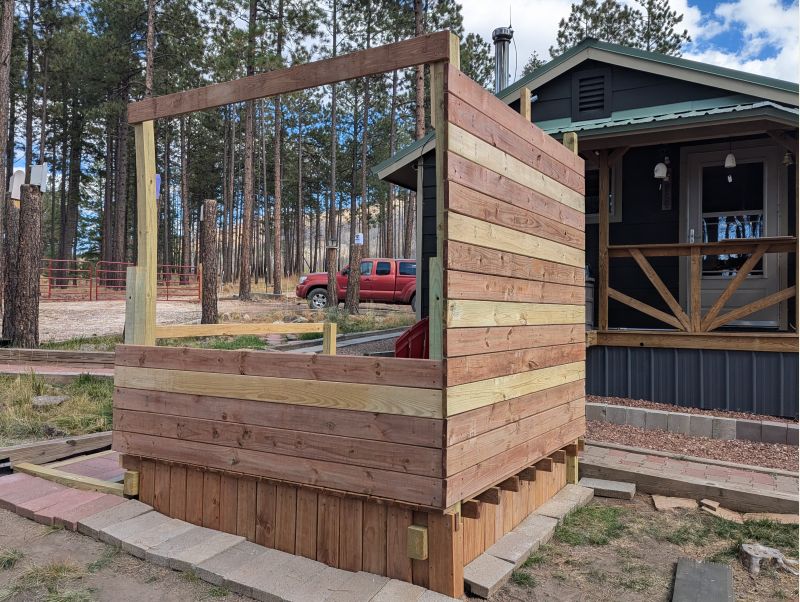

Did some more work on the deck. There is often more of a breeze up the south side slope than I like. And naturally the south is where the sun is. And the view to the south is mostly standing dead burnt trees on the national forest land, while to the north we have green trees, a green ridge line... a much better view.
So a wood wall was built. The old gazebo had some wall and some windows to cut the breeze. On the west side there is now a short wall and provision to hang a shade, a Coolaroo perhaps, if desired.
I need one more 5/4x6 red board at the top of the south side. (One was repurposed for something unplanned) New chairs.
Westward
Westward
Eastward
Eastward
