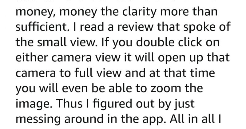

Got this off the Amazon reviews. For that brand camera.
Customer
Customer
# Posted: 6 Mar 2025 09:51am - Edited by: paulz

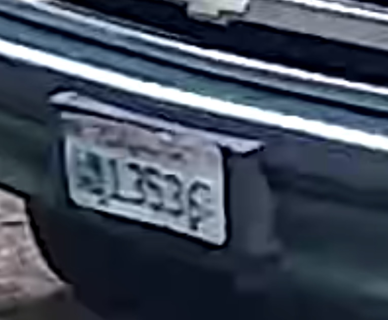

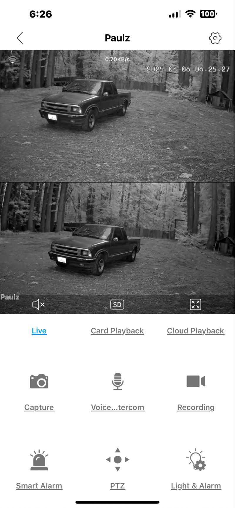

Wow that worked! Just a two finger swipe. I can even read the license plate!
And I now have it in its final spot, can even watch the cars go by in the road past the gate. just a couple mounting screws and I’m done. Except for an SD card, you use one? Also keeps asking if I want iCloud.

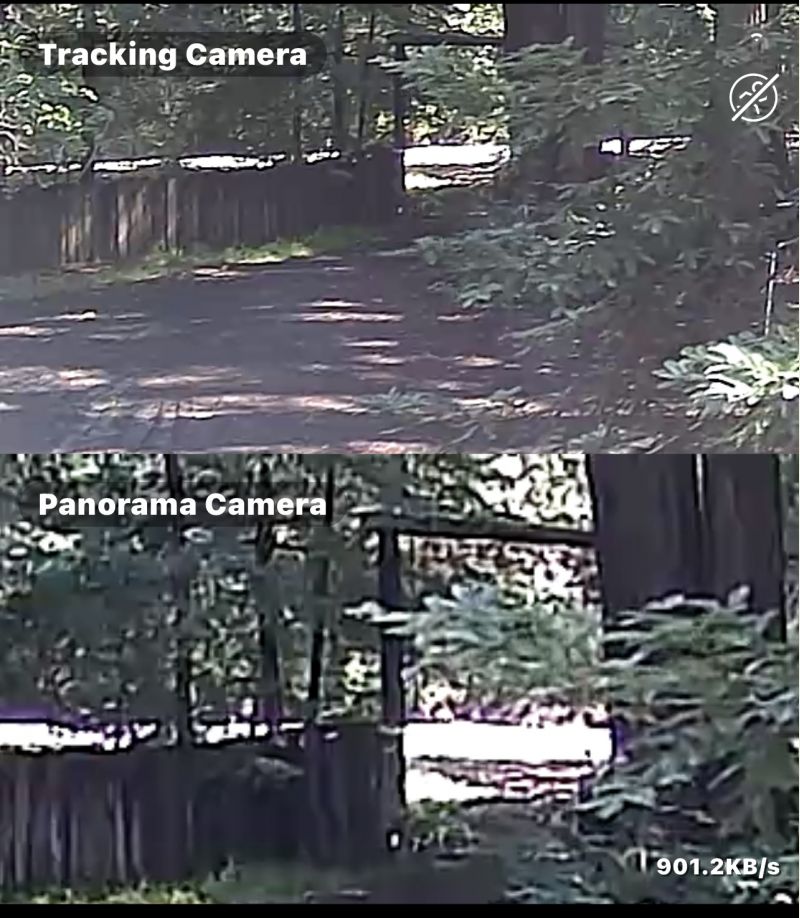

# Posted: 6 Mar 2025 11:28am
The SD cards are just to play back stuff? I guess this camera does do video. If I see something on my screen I can just do a screen shot and have that.

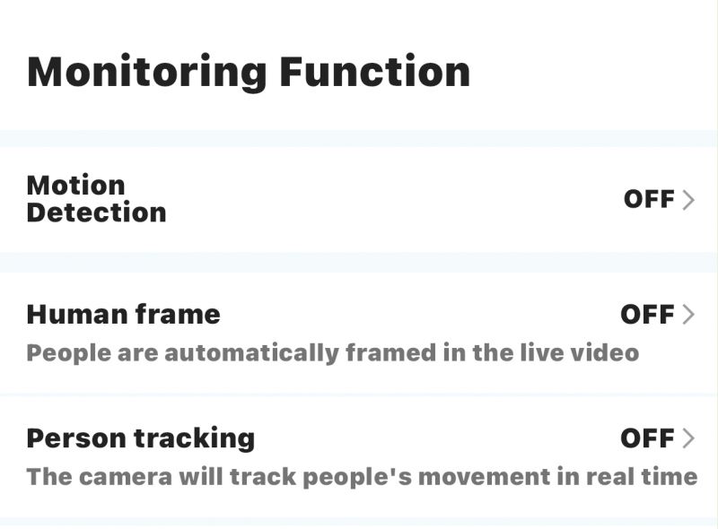

# Posted: 7 Mar 2025 03:37pm

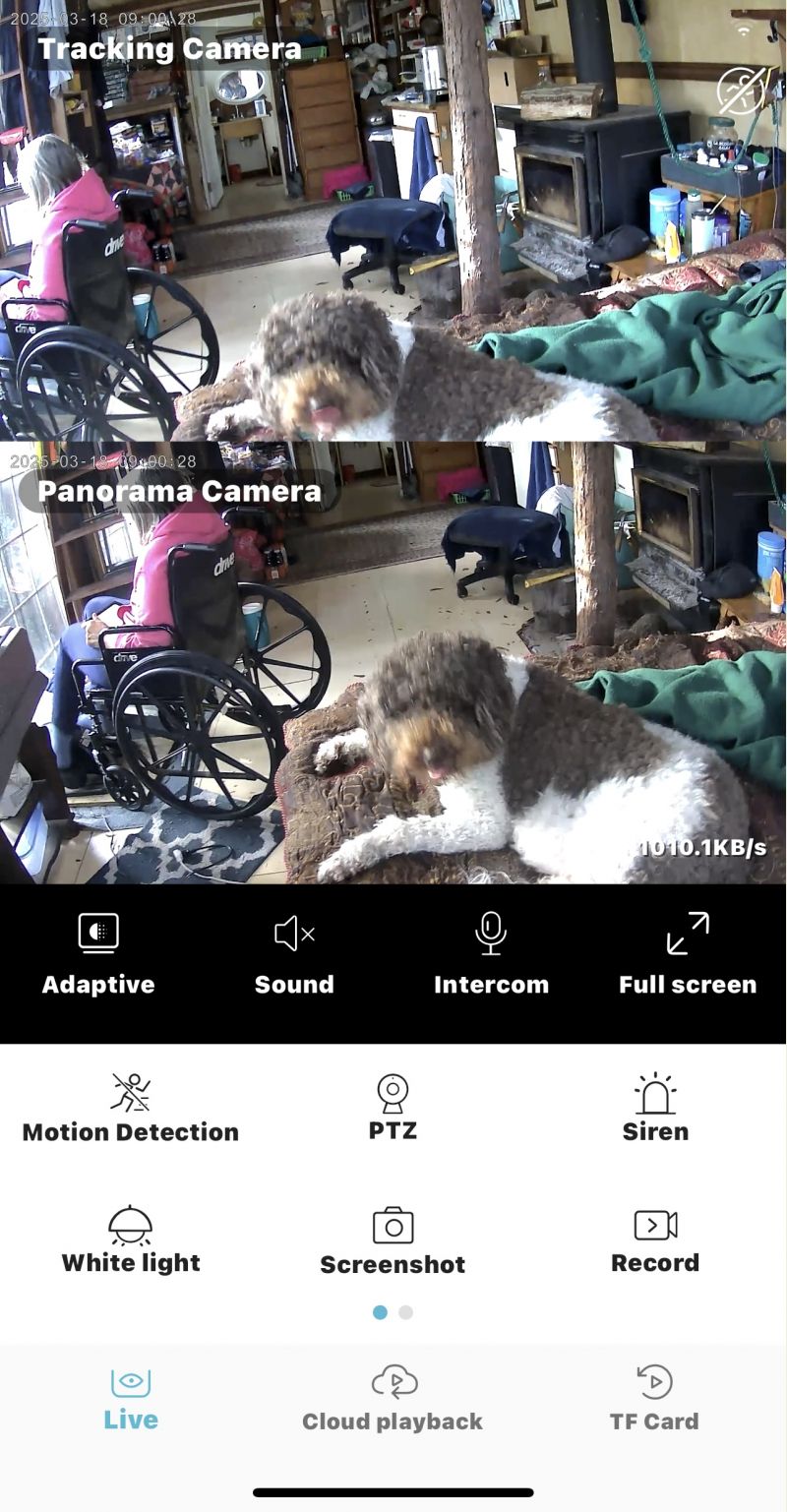

Ok I put a card in it and recorded the trees breathing for a minute lol. Haven’t found a motion menu, it does have ‘smart alarm, human detection’. Turned that on, guess I’ll walk down there and hang a ba, see if it records.
Sure is a lot to these buggers. Kinda fun though, I put it on the wife’s phone, gives her something to watch besides soap operas.

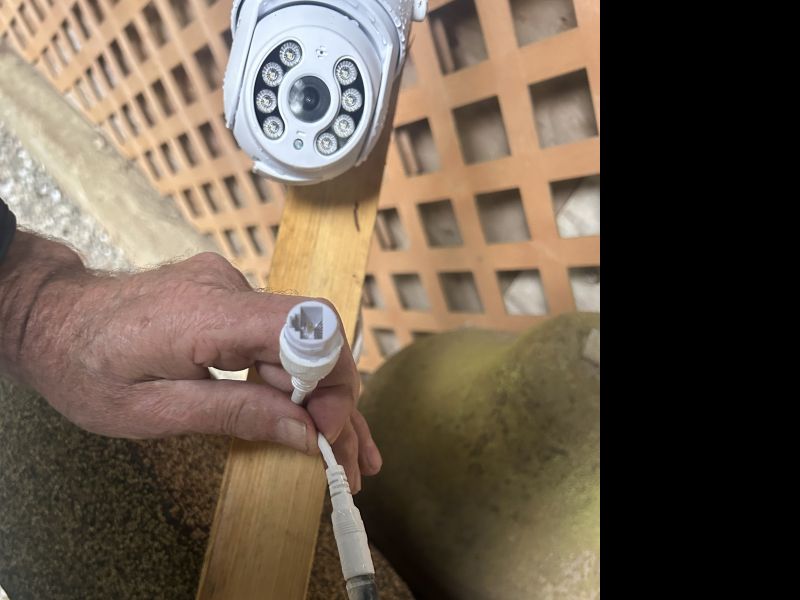

Got the new camera like yours Darz already. At the house until Monday. You said usb power? Where do you plug that in?
# Posted: 15 Mar 2025 08:28pm - Edited by: darz5150
The cam comes with a 120 plug in charger just like a phone.
I wired the shack for 120 AC and 12 vdc. I also have the same for camper, shop, gazebo.
I think the cam comes with 10 foot regular USB plug in, so you can hook a cig plug in to your battery. I tried one out with a jump box that has USB ports. Worked fine. I bought a few variations of these for golf carts/ gazebo etc.

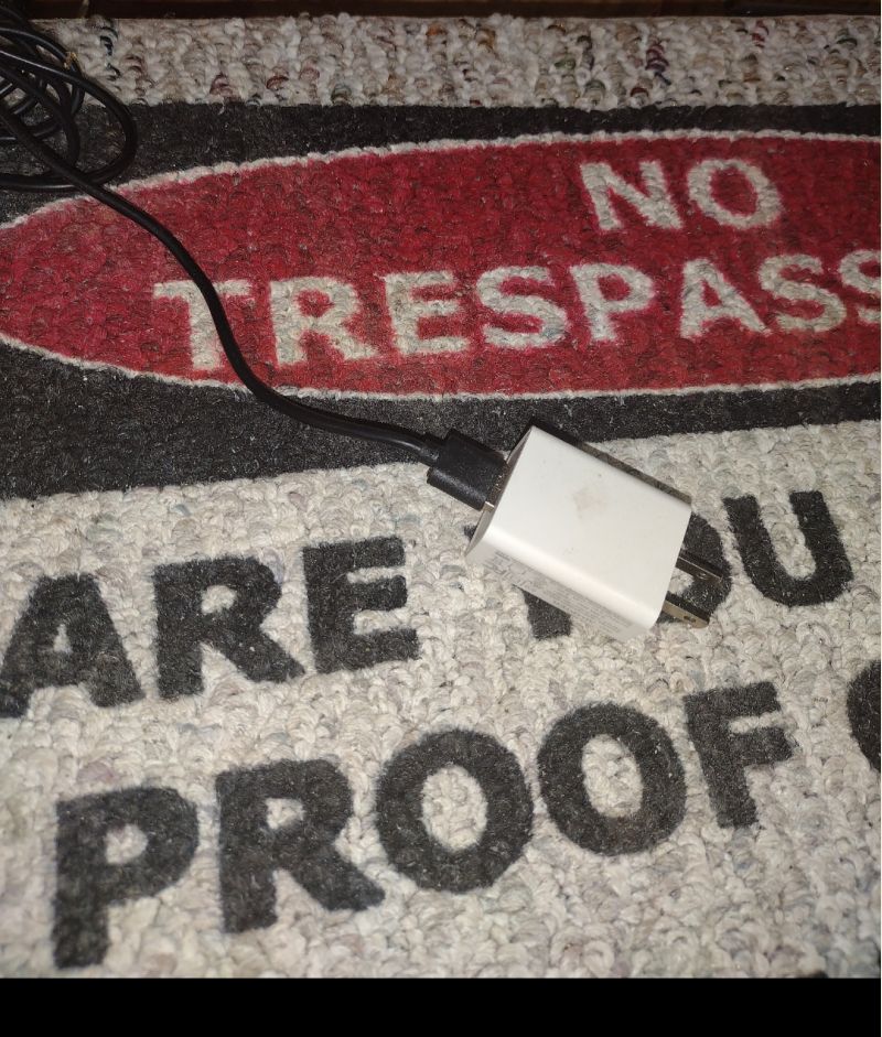

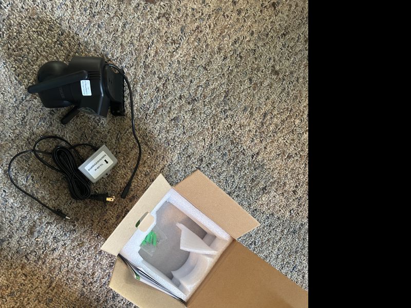

# Posted: 15 Mar 2025 08:41pm
This is all mine came with. Did something else plug in instead of the wall wort?

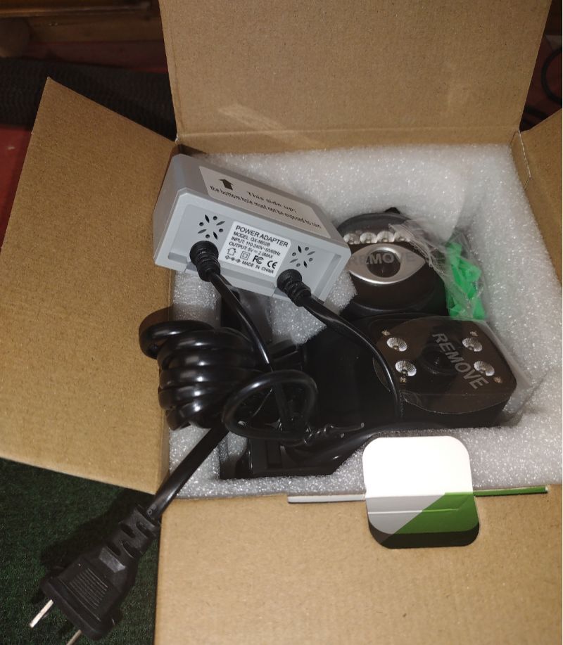

# Posted: 15 Mar 2025 08:47pm
Give me a minute. I have a brand new one in the shop still in the box. I will go get it and take pics.
# Posted: 15 Mar 2025 09:08pm
Well I'll be. I have 5 with the USB plug in the first pic. But the one I still had in the box is like the one you got. I wonder if they changed the power source for some reason. I have had zero problems with the USB type.
I see that the new one still takes 5 volts.
Old
Old
New
New
# Posted: 15 Mar 2025 09:15pm
Just checked with a multi meter. It's 5 vdc.
# Posted: 15 Mar 2025 09:31pm
Just my luck. Same part number? Well I can hook up a usb output wire and cut the 110 thing off. With my luck that probably won’t work…
# Posted: 15 Mar 2025 09:37pm
Yes I checked the model #. The same . I believe you've took apart and rewired USB plugs before.
Maybe you can clip the output wire from the power converter and wire an old USB plug.
Sorry bout that . I never thought to open the new one.
# Posted: 15 Mar 2025 09:39pm
The model # is the same for the other ones I have. So I know 5 vdc will work.
# Posted: 15 Mar 2025 09:46pm
Yes done plenty of usb wiring. Might even have a jack so I don’t have to cut this power supply.

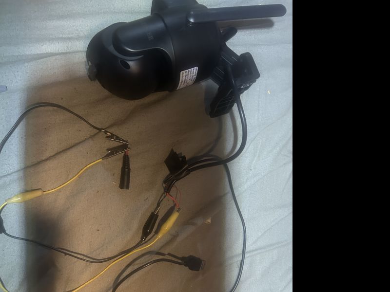

# Posted: 18 Mar 2025 10:49am
Quoting: darz5150
If you're gonna wire a USB cord on. You can cut the camera jack off

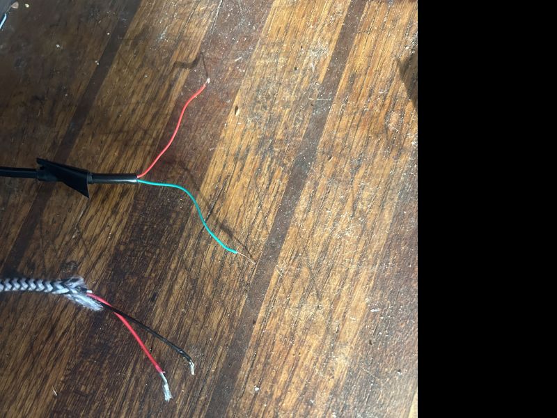

Back at the cabin. First I tried it on the inverter to make sure that still worked, good. Then I cut the jack off and hooked it to a usb port. Nothing. It does say 5v right on it.
There are for wires inside the cable, two red two black. I tested those, reds to the center, blacks outside as you would expect. I tried it in a few usb ports, including the hi zoot one that charges the iPhones. Then I jumpered the jack back on and back into the inverter. Still works fine. Stumped. If you are going do cut yours and try on usb have at it.
# Posted: 18 Mar 2025 11:26am
Did you try reversing the colored pairs in a test sequence? Ie, since there are 4 wires each may need to go into a specific spot in the jack. I know on one of my rigs it is particular because one is a 'trigger wire'.
# Posted: 18 Mar 2025 11:52am - Edited by: paulz
Wait… I changed to a thicker usb cable and it’s working… more to follow..
Ok, I changed from the little usb cable to one from my Apple phone. Guess the little one just wouldn’t pass enough juice. Next, time to walk it down to the shop and try..

# Posted: 18 Mar 2025 11:42pm
Thanks Darz. Getting tired of watching the trees in real time. If I leave the WiFi on and not here, can I record an animal going by, or a car? I have an Sd card ready. What else, turn on one of the monitoring functions? Notifications by email? Will it only tape for a preset time?
