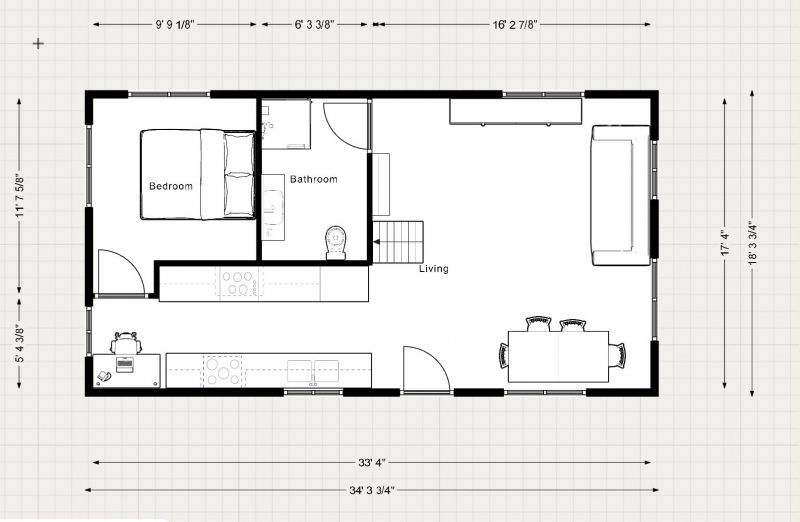

# Posted: 10 Jan 2025 03:44pm
Thank you both for the insight. I'm still open to hear if anyone has concerns- I want to make sure I do it right, but it sounds like blocks are the way to go. Whether I do regular blocks, silo staves, or something else, I was planning on doing 15 total - 3 rows of 5. So maybe I'll add a few more around the perimeter. I hear ya on getting more than needed, that seems to apply to everything in building- especially when your closest hardware store is over an hour away.
This is my basic idea for a floorplan. The half on the left would be lofted and the living area would be open to the ridge. I'm not married to any of this - would love to hear if anyone has ideas. Like I said, I won't be doing anything on the interior for a while but I do need to get my windows and doors placed correctly.
Floor plan
Floor plan
JD0
# Posted: 10 Jan 2025 03:47pm - Edited by: JD0
Not sure if that attachment worked...trying again.
Floor plan
Floor plan
# Posted: 10 Jan 2025 09:56pm
Roofing:
What is the snow load for the location of the cabin? That can affect the rafter size needed. The PSF can vary a lot across WY.
ASCE has an online tool that can be helpful with snow & rain loads, winds and so on. I may be able to assist if you have troubles with it. The risk category must be set for it to use. Level II is what we use for single family dwellings. Set the location by address, la titude & longitude or by clicking on the map.
In snow country, if I want snow to slide off a roof I prefer metal roofing over shingles. A pitch of 4/12 can hold a lot of snow before it slides. We can easily have a foot stack up before it begins to slide. A 6/12 will likely have the snow slide off faster and a higher pitch is more prone to very rapid shedding… like you walk out and slam the door. Boom.
Speaking of doors, the floor plan has the door in a side wall. How do you plan to avoid snow falling on people at the door? Or is that not a concern as the plan does not include winter use? The easiest solution may be to place the door in the right end, near a corner the door can swing up against and not take up interior space.
Floor Plan:
The bathroom seems a little to me (for a cabin). A full bathroom can be 8 x 5 though that can be considered a tad small.
I’d be trying to make the center load bearing wall be more down the centerline so it would actually be over the center floor beam and be able to carry the loads straight down to the earth.
I see you are set on using blocks sitting on the ground so I will not bother to address the foundation, other than to say I believe that a large cabin should have a proper foundation. One never knows what life changes may occur and one could end up spending more time there than one thinks.
I believe two doors would be advised from a safety standpoint. One at the front (right) end and another instead of the window at the desk.
Anyplace to hang coats, jackets and place your boots when you come I the door?
Moving the entry door to the end would allow the table to be closer to the kitchen area.
Questions:
What sort of heating? I see nothing in the floor plan.
Water; a well? Septic?
If you can move the kitchen sink to the center wall at the bathroom you should be able to simplify the plumbing and keep all pipes out of the exterior wall framing.
Power from the grid?

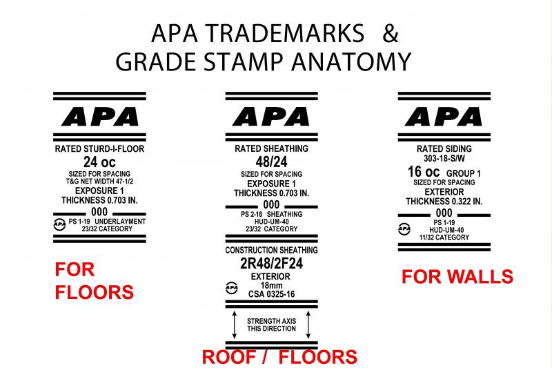

Regarding T1-11 siding panels. Those are often non-structural panels. If it is structural rated there will be an APA stamo on the backside of each. See images below for examples. And I believe that GP states that its T1-11 panels should not be installed in the manner you mentioned for the roof.
You may find the AWC span calculator handy for joist and rafter sizing while you plan.
There are apps available for smartphones. I find it very handy to have. FYI AWC does have a tutorial online as well. That can help figure out what to set things like the deflection limits when making calcs.
# Posted: 10 Jan 2025 10:00pm
APA grade stamps reference
https://solutions.dunnlumber.com/projects/how-to-read-a-plywood-grade-stamp
apa
apa
I believe it was you who told me about a Simpson strap that was prety cheap and would help with racking it was something like a 2in metal strap with nailing holes in it. If the OP wanted something more structual than t1-11 for siding they could use this.
How ever I would not use T1-11 (even the 5/8) for roof sheething. Its prety thin in the groves. They also make that LP smart siding stuff that's about 3/8 thick, I wouldnt even use that as siding unless theres sheething behind it.

# Posted: 11 Jan 2025 08:59am
That's a fantastic tool, I didn't realize such a thing existed to get an accurate location for snow load. I was estimating based on general show load charts and annual snowfall averages for the area. This shows my snow load will be 88lb/ft, can't do that with a 2x6 even going 12"oc. So 2x8 it is, if I want to stick with a 9ft span.
I don't think there was a specific reason I put the door in the middle, I was planning on doing a covered porch addition eventually but it does seem to be less intrusive on the side (and can still do the porch). I changed the drawing a little based on that and moving the center wall in a little. That makes the bed/bath a little smaller and kitchen a little bigger. However, if I do 8' floor spans and cantilever one side out (like grizzlyman suggested) my original floor plan would put the wall right over the center beam. Still need to look into that, though.
It'll be a wood stove for heat, I noted that as a block next to my ladder to the loft. I switched it with the bath door so it's on the corner now. Probably a propane heater to supplement.
Off grid for now, but there is power close (within a half mile) so I might look into connecting it to the grid in the future. If it's going to cost anything more than a nominal fee I'll stick with a generator. Hauling in water, possibly collecting rainwater. No septic, more than likely just a composting toilet. Not a bad idea regarding keeping plumbing on interior walls.
I see you are set on using blocks sitting on the ground...
Not totally set on it, in fact I came here half expecting my idea of using blocks to get shot down pretty quick. I appreciate the counter point and I'm still exploring my options. If I can find a practical/cost effective way to get equipment in and auger the holes required for piers, I will probably do that.
Right, I have always used sheathing under t1-11 in the past. I had only recently come across the idea of using it as sheathing, and I understand it has to be rated for it. I haven't looked hard enough to find a product that actually does what I'm looking for, maybe it doesn't exist or might just cost less to do sheathing anyway. Also considering doing sheathing and hardie panels or planks. That stuff seems to be a pretty decent value for something that will probably last longer than t1-11.
Floor plan2

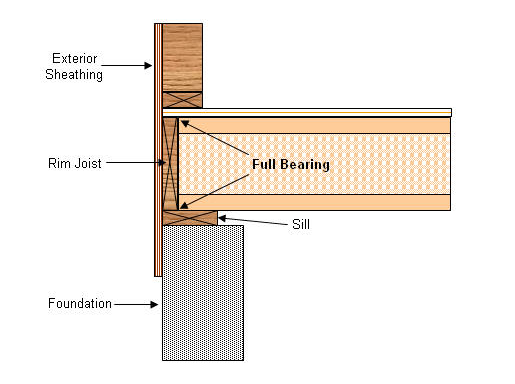

# Posted: 11 Jan 2025 03:41pm
One other thing to think about regarding the use of T1-11. It comes in 4x8 sheets. When building on a platform floor (floor joists supported by beams with subfloor on top of the joists and the walls built on top of the subfloor) It makes for a much stronger building if the exterior sheathing panels not only cover the wall framing but also overlap the rim joist that is nailed over the ends of the floor joists. 4X8 sheets of osb and plywood are available to do this.
the image shows a mfg floor joist but the rim overlap can be seen.
rim overlap
rim overlap

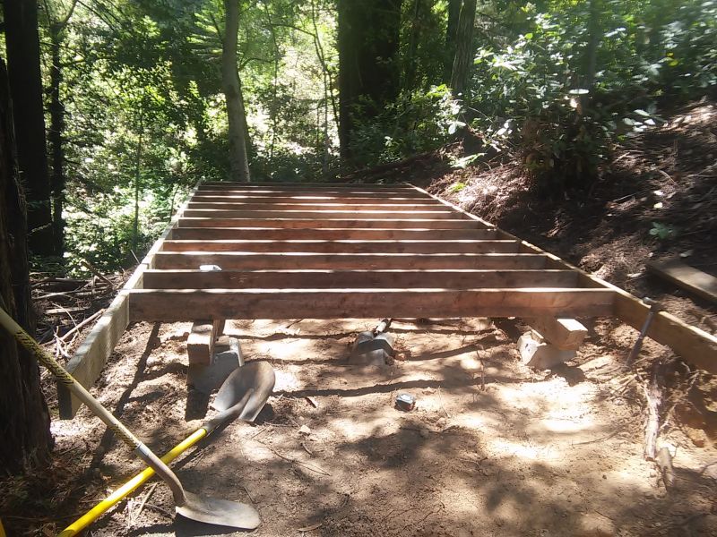

Since building it I have learned more and realize I had a little luck in having well drained soil and no clay.
Since my build family members have built nearby. They have followed my lead with one exception. They wanted a wider cabin and went with helical piles installed by a contractor. They do have a center beam but there should be no movement with the engineered foundation. Plus they have a decent height crawl space.
I understand that some locations, especially those here in the west, are too great a distance out into the boonies over sometimes iffy roads for contractors to want to bother with. If you can find someone who will do helical piles for a price that suits you I’d give that some thought.
Maybe consider this, if you decide that a proper frost depth foundation is not practical for you to build. What if your design was changed to two beams? Eliminating the center beam would simplify any future need to adjust the beam to support block connection—no need to crawl under the building.
Two four-layer beams could be made using 2x10s. Note, if the bottom edge of the beam is greater than 12 inches above grade PT lumber is NOT required.
If we used 2x12 floor joists the joist could cantilever a nominal 12” over each beam. The built-up beam would measure 6 inches wide. With a cabin width of 18 feet (216”), we would subtract the cantilever and beam width; 216 - 12 - 12 - 6 - 6 = 180 inches or 15 feet actual span distance.
Doug Fir, 2x12 grade 2 lumber on 16” centers with the standard LiveLoad of 40 PSF and DeadLoad of 10 PSF can span up to 18’1” according to the AWC calculator, so there is ample margin. DF 2x10 calculates to a max span of 15’7”. Technically allowable but possibly too close to the maximum?
See what species of 2x12 the local suppliers carry. Hem-Fir is common here and has slightly less span than DF.
Of course, doing twin beams would also change the requirements for the loft floor and ceiling joists.

# Posted: 11 Jan 2025 04:30pm - Edited by: ICC
Quoting: JD0
Floor plan2
Perhaps change the swing of the bathroom door.
