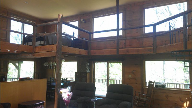

When building your loft, consider skylights...
Our loft is about 1/3 of the footprint of the cabin, and has room for two queen beds. It also has a catwalk to the other end of the cabin, where there is a spiral staircase to save room. (skylights are not visible in the photo below).

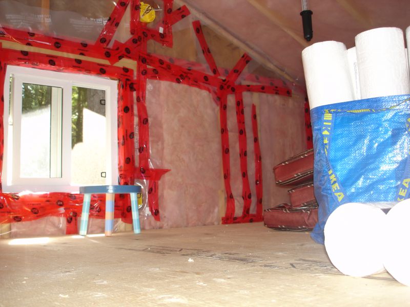

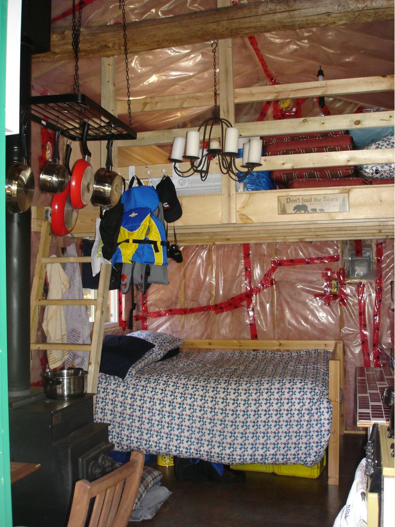

Ours is on ledgers on an exterior wall and an interior wall,and supports just our futon- it's @5x7'.We're going to put in small shelves and nooks for cups, books,etc. when we finish the space. There are 2 small windows to open if it gets hot, but so far it's been comfortable. Elsewhere on the forum I posted a
picture.
Beneath the loft we dropped the floor, suspended in the crawl space under the cabin for storage, so the back half of the cabin is semi-organized. Elsewhere I posted a picture.
