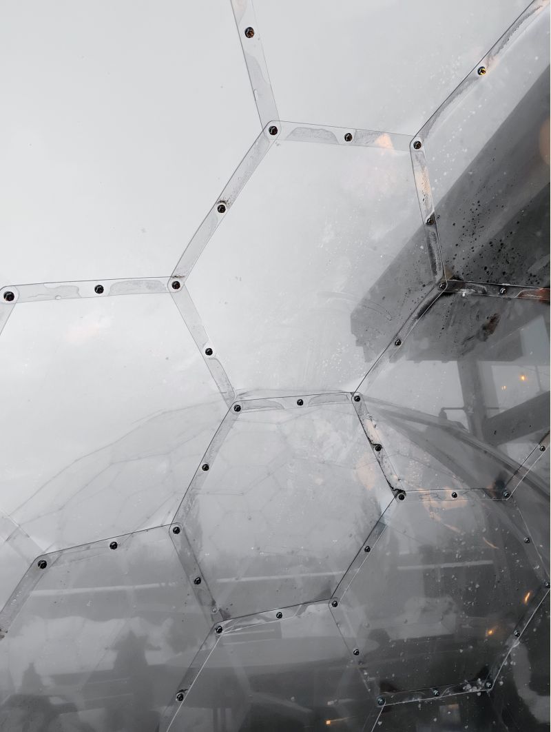

It really felt remarkably solid. The one I saw was all clear polycarbonate. 5K Canadian for the small one.
When you do the math and consider a decent grade of polycarbonate material, it's not like you would save a lot DIY.
I wonder about what laser cutting 1/4" ply and treating it would be like. Could laser cut that precisely, and looks easy to assemble on first glance.
Most geodesic structures have a frame, this does not.

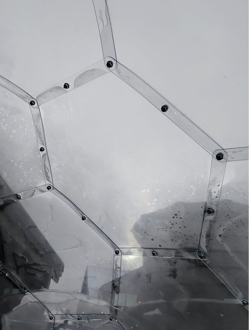

It was bolted, I'll dig up some pictures I took.
socceronly
# Posted: 17 Feb 2025 05:01pm
Found them.

Yeah, a lot of geodesic options with frames. You can get all sorts of connector kits out there.
I just had not seen anything like this that didn't have a frame.
So this uses a combination of hexagons and pentagons.
