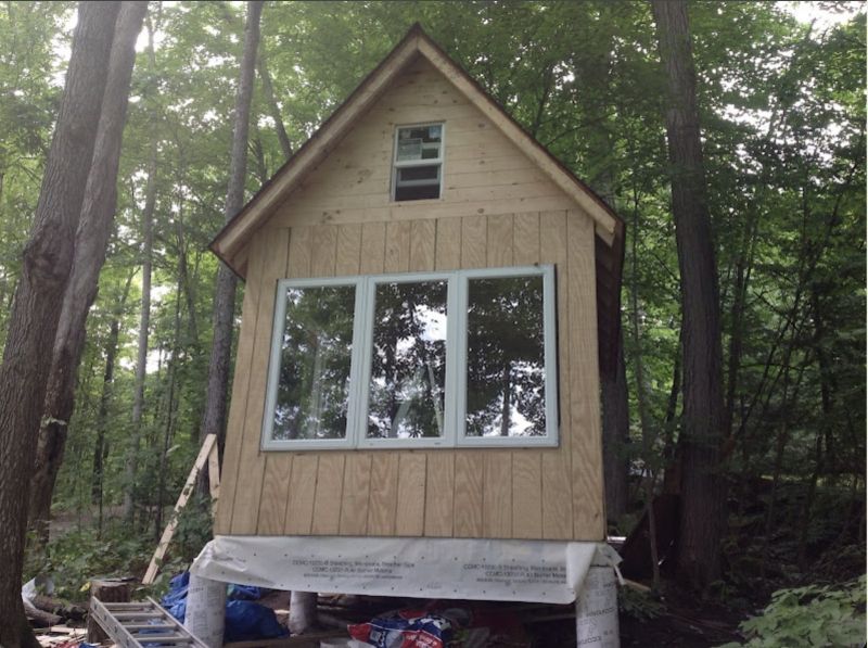

My neighbour ended up building a massive house right next to my 9X12 which are on post and pier. Like 10 feet away. I now would love to move to another part of the property, but I am not quite sure how to do it. I was thinking of lifting it with jacks and removing the piers and then settling it down some type of sled so that I can pull it. Does anyone have any ideas how this can be done?

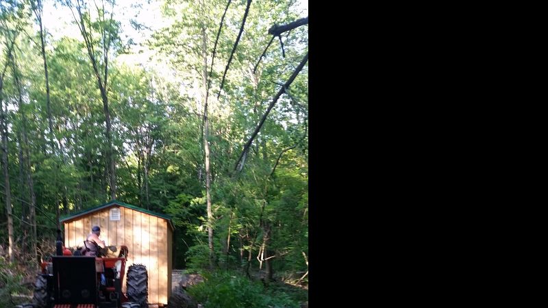

My 10x14 shed was built on 6x6 runners. It was pulled via tractor up a very loose and steep gravel driveway.
If no large tractor is available you can use an electric winch..or just call a shed mover.

Sorry I forgot to mention that it is insulated and pine interior and 13 feet high with a loft. Also it was built on a slope so the back is about a foot high on the post and pier and in the front it's around 5 feet. I have attached a picture.
# Posted: 19 Mar 2025 08:20pm
Here's the old thread on the cabin construction. Lots of slope. Large nearby trees. But mainly I look at that slope and cannot come up with a safe DIY method of moving that. If the ground was flat and level it would be a big enough challenge. With the slope a professional home mover might be the only safe solution. Or just get used to having a nearby neighbor.
mojo43
# Posted: 19 Mar 2025 08:21pm - Edited by: mojo43
Hmm ok. I have cleared out all the trees, but yes the slope makes it difficult. I guess a crane could move it, but I assume that wouldn't be cheap. I was hoping to have jacks lift it up and install a sled and then remove the piers and then lower it.

This is the Canadian guy with the crumbling piers built in a drainage ditch. Look at the previous thread, Foundation Problems for better pictures. Many boulders.
Mojo, jack it up on cribbing, knock out those bad piers, lower it down on skids and I guess tow it downhill? Don't know how you could turn it across hill without turning over. Can you post some better pics of the projected path and final resting area?
# Posted: 20 Mar 2025 10:41pm
Looking at MtnDon link to Mojo's pics. He's sloped all the way down to water.
Mojo, you may want to think about the simplest way to make it better.
I think moving it is risking an accident.
Dig out between the piers and uphill to make a big level spot.
Like 7ft x 16ft. 4 ft uphill for a french drain or just to slow rain water.
Shovel in 3-4inches of gravel. Level.
Jack it up onto cribbing that is in the new dug out area.
Dig out the piers and remaining dirt. Add gravel level with previous gravel.
Lower it down onto PT skids or concrete blocks.
Plant evergreens between you and the neighbors.
Towing that thing in any direction on that slope seems dangerous. If you decide to do this, lets discuss what evergreens to use.
