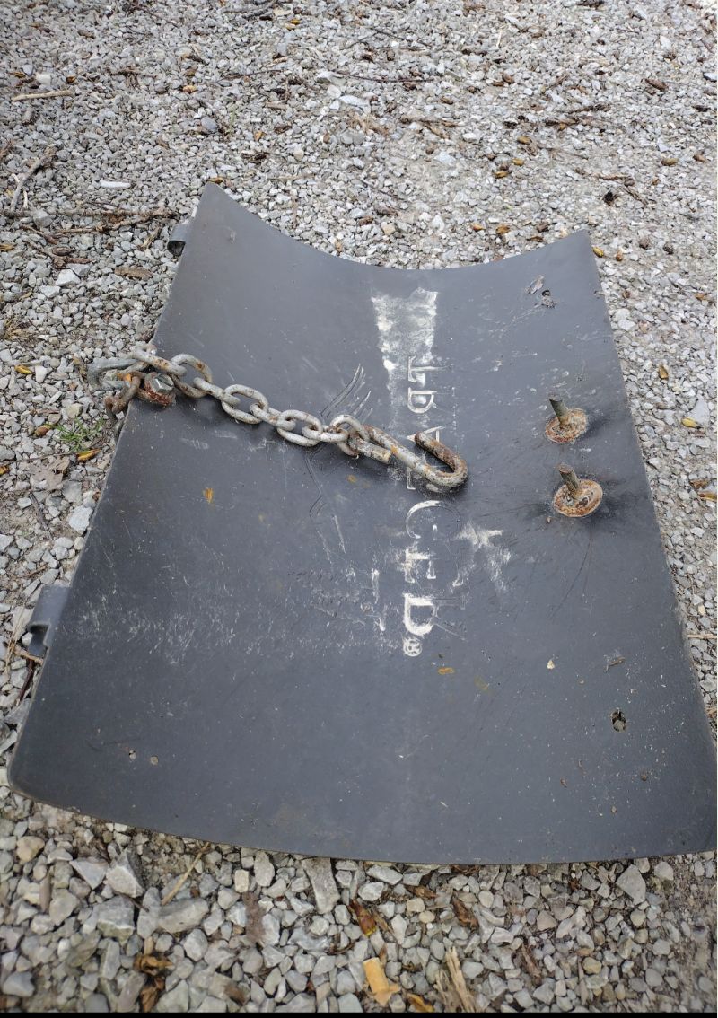

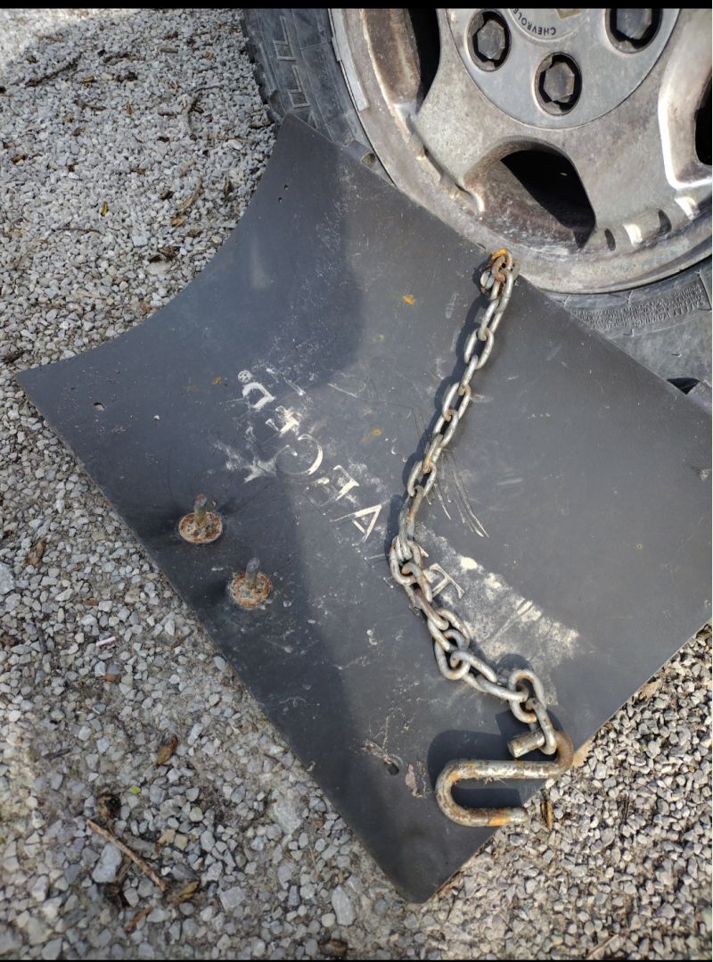

I made this about 4 years ago.
It's a traeger grill lid. I welded some spikes on it told keep the log from slipping off. I made another piece of chain with some spikes to hammer in the log, then attach to your tow chain.
But you can wrap a choker chain or a sling to the log and do the same thing.

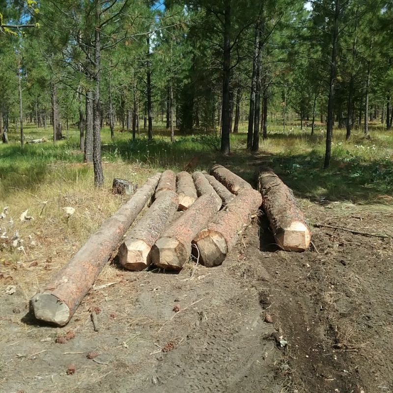

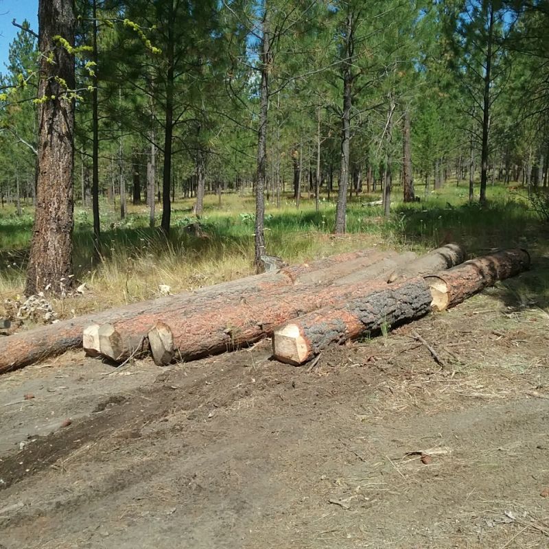

I just cut the front of the log IE beveled it, 4 angle cuts, towed like a breeze. But getting the nose up, less friction. My Kawasaki Mule in plain 2WD open diff, drug any log I had with ease.
If you see old log structures, you will see some logs cut like this. It wasn't for decoration, but for dragging, probably easier on the horse or ox
