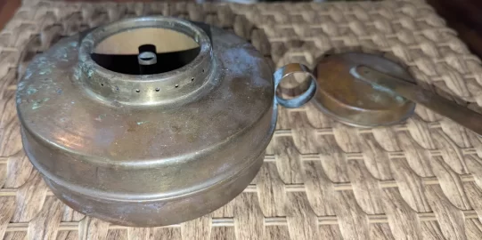

I think this came from my late inlaws' antique shop... it looks like a giant version of the Trangia alcohol stove I use for backpacking, but this is much larger, around 6-7" diameter. Pre-sterno chafing dish warmer, maybe?
There's no grate or pot support, unless it's supposed to plug into that center tube. It does work quite well, boiling about 1.3 quarts of water in 10 minutes on a breezy day with no lid (pot balanced on a couple of steel rods for an improvised grate).

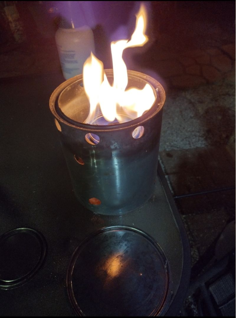

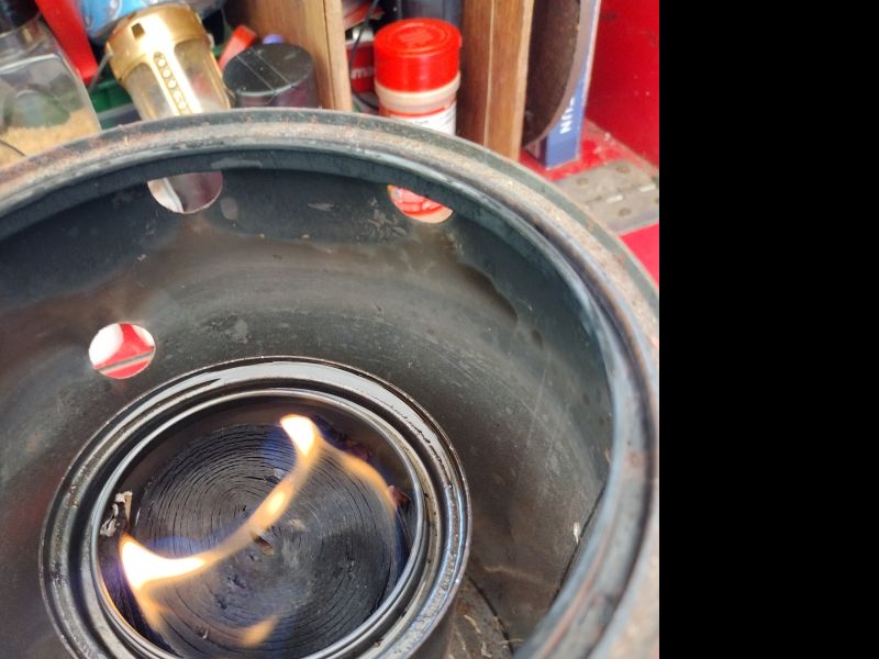

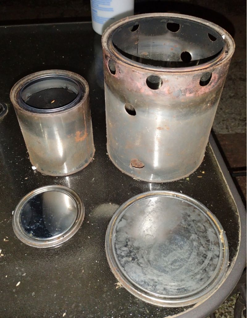

Look up on YouTube penny stoves. I also have made several alcohol stoves out of new quart and gallon paint cans. You take the cardboard tube out of a roll of toilet paper roll, stuff it in the quart can, fill it with rubbing alcohol for the burner, put inside the gallon can for the pot support with vent holes punched in the sides.
The one Fanman posted will probably outlast us all. Cool burner. Thanks for posting it. Reminds me of making hobo stoves growing up.
This one is 10 years old. Still works.
If you don't have alcohol or Heet. Take out the quart can and You can cut a
Rectangle hole in the bottom of the big can and use twigs and sticks in an emergency.
Same roll of tp
Same roll of tp

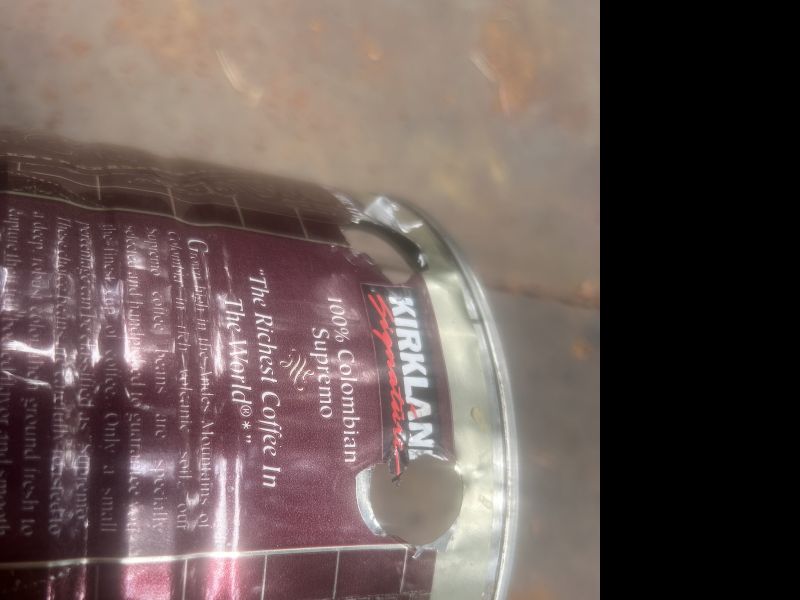

Nice job Mr. innovation, I’m on it. How did you punch those perfect holes?
# Posted: 1 Jun 2025 09:18am
Step drill bit.
# Posted: 1 Jun 2025 01:14pm
Quoting: darz5150
Step drill bit.
Sounds like a recipe for a crumpled can and flying blood but I’ll give it a try.
# Posted: 1 Jun 2025 01:20pm
I started with the small one that goes up to 1/2 inch, then opened it up with the 1 incher.

Without knowing any better I’d imagine the pot is meant to just rest on the center rim of your stove. A lot of alcohol stove work that way. The center is to prime and start it and then when that center hole is covered it jets out the small holes.

Quoting: darz5150
Ok that was easy enough. No alcohol around here, some tequila.. I guess diesel would be too much for a test.

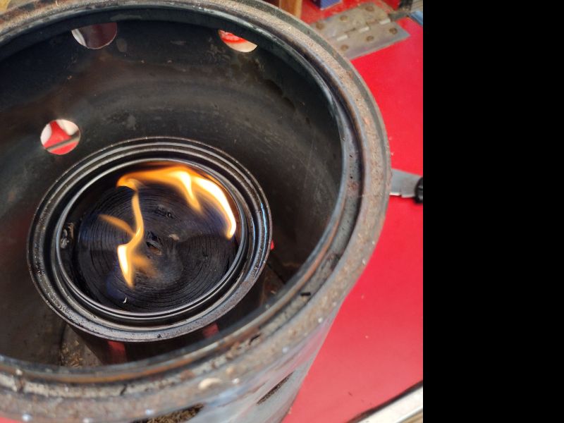

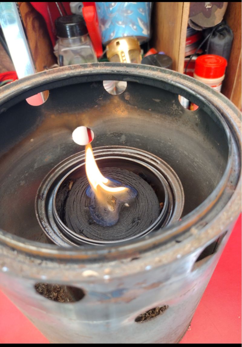

Cooking oil will work. This is only about a half a shot glass of oil.
Cooking oil
Cooking oil
Took a minute to spread the flame

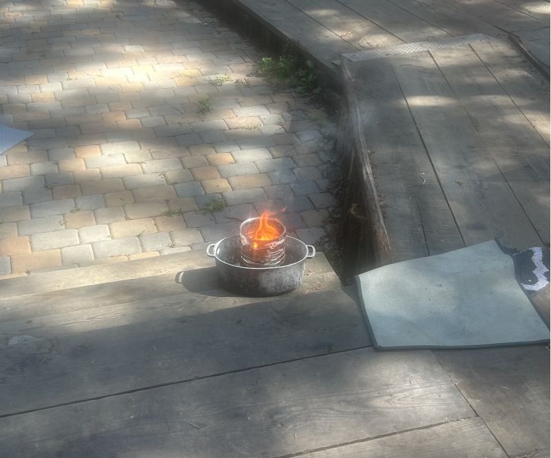

Veggie oil. Worked great! Oh boy, a new pyro toy!

I wouldnt use anything smokey/oily in it unless desperate in a survival situation.
You should be able to buy 90, maybe 95% rubbing alcohol at your 'W' Mart, it will work great with NO residue in stove or on pots.

Yeah it was very smokey on the veggie oil test yesterday, nice since I could keep my eyes on it from inside the cabin. Next step is to actually heat some food..

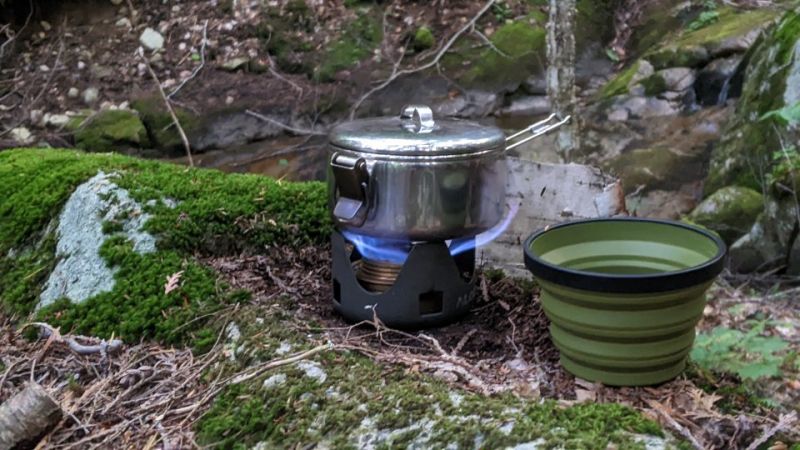

These self pressurizing stoves need a volatile fuel like alcohol to operate properly. Heavier fuels like oils won't vaporize to burn cleanly, so you have a yellow flame and smoke and/or soot.
The alcohol burns with a clean light blue flame, almost invisible in daylight.
This is my Trangia style backpacking stove; the small brass stove fits inside the aluminum pot support. Note the piece of birchbark for a windbreak.

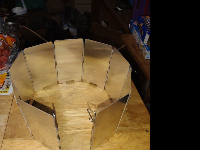

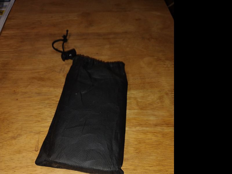

Here is a cheap adjustable windbreak. I think I got it off temu, but Amazon has them. I use it on camp stoves and even the side burner of the gas grill. Folds up and stores nice and compact.
I posted pics using it on the gas grill burner, but can't find it.

Folds up small
Folds up small

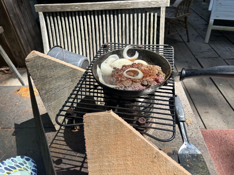

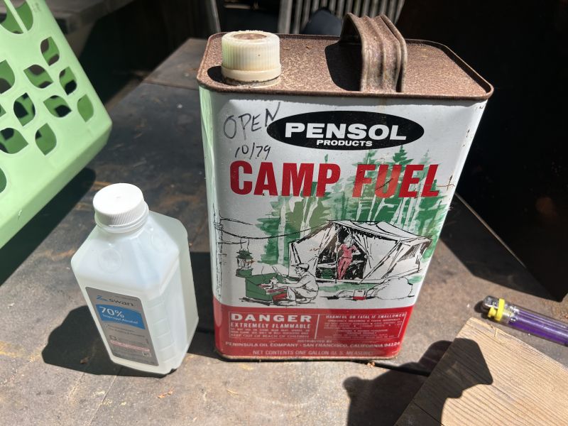

First dinner test. The alcohol I got at the dollar store was only 70% it says, but ha, I did find a gallon of Camp Fuel in the shed. Check out the hand written ‘date opened’, 10/79! 45 year old fuel. But it was full, cap tight and burned better.
Burger and onions were excellent. I did have to mess with the can a bit, the pan fit on top so well it kept going out. First I drilled holes around the bottom like Darz. Then I put the grill on top to space it up and added wind blocking.
Still some learning to do but good burger non the less.
