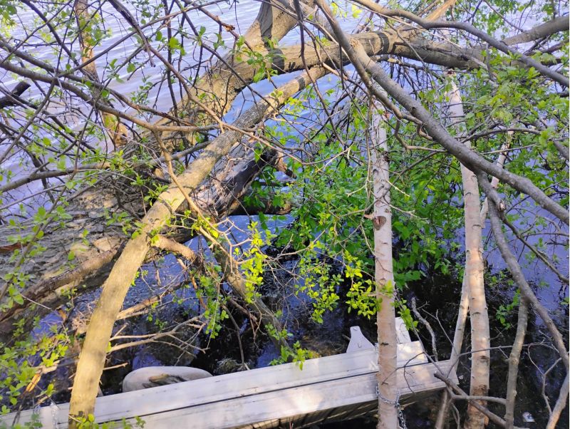

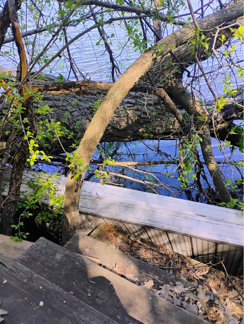

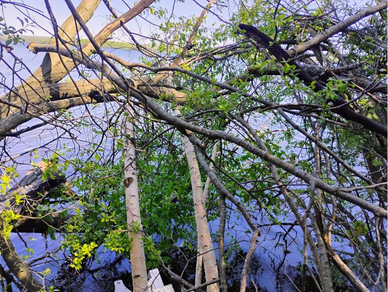

Hey, not a chainsaw expert. I am not taking on the main tree that fell.
The tree that fell is resting on these small ones that are bent over.
They are under tension... but I can only access them from the back.
What cut direction/order/position works to not get the saw stuck?
I can shore them up with some 2x to mitigate things snapping back.
Ideas?
JM
socceronly
# Posted: 4 Jun 2025 10:26am - Edited by: socceronly
The main tree fell on my dock, so probably crunched the corner of one piece. It is resting on that currently and the bent trees.
My goal is to free it up so it goes into the water.
Everything I do will be uphill from the main tree.

Came across a few videos like that. Trouble here is I can only access from the back and I suspect they are under tension in more than one direction.

I’m no expert either but I do cut a lot. Can you just cut them from the back? If you’re worried about them snapping back at you- just cut it low down and slow. Cut a bit and wait, cut a bit and wait.. etc. I would think that as you cut it-it will release the tension and just fall over into the water- especially if they’re being weighed down by the big tree. They don’t look that big so stand aways from the tree if need be and just use the tip of the chainsaw.

It is difficult to assess the whole situation from 3 still images. Not sure what you mean by the "back".
The arrows indicate what side of the curved trunk you would cut in order to not get the saw bar & chain stuck.
If you can't get in a position to cut somewhere along that curve and have solid footing for each foot and to have a safe path of retreat, you need help from someone who knows what they are doing. The ER at the hospital near our cabin treats a good number of chainsaw and tree injuries each year.
Or wait and see how that shakes out naturally.
From what I can see, if a cut can be made in the tree I placed the arrows on, the big tree is likely to fall and break the two smaller trees. But maybe not.

No 'spert here either, though Ive cut more than a bit. How long has it been like that? Because the longer it sits the more those trees will take a 'set'; ie, be not as springy. The big tree will keep settling them down.
Think Id start at the bigger, lone bent, cut if needed a good access and footing and as said take a little bite across that bend well down. It will likely crack at some point, settle more, rinse and repeat. The big tree may also settle more so mind that.
Ime, the only time to cut from below is if both ends are supported beneath so its weight would sag in the middle. As it is, under tension, if you initially try to cut from below it WILL pinch the saw.
As always, go slow and mindful of AnyThing that light 'kick' atcha.
