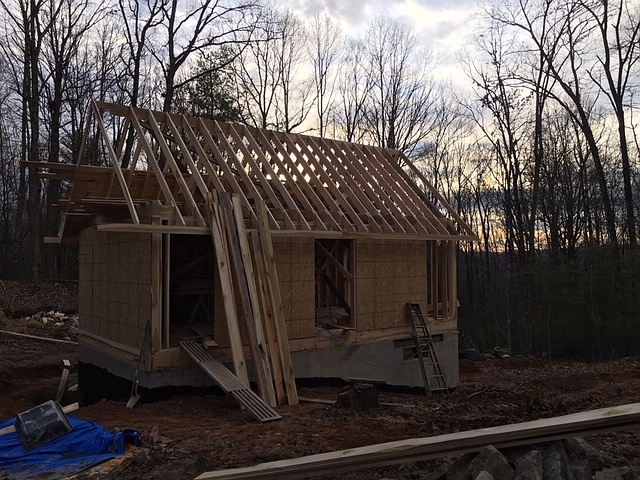

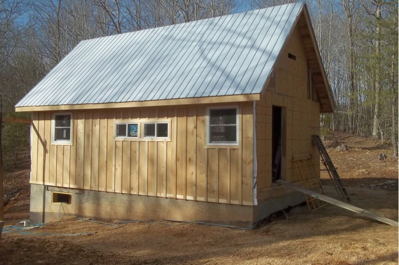

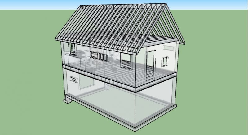

# Posted: 25 Jun 2025 08:50pm
The pics below are from a community project for a neighbor who was burned out. 3 of us had sawmills so we did it with dimensional lumber, we just made the lumber. An engineer donated the okey dokey letter.
Because of the slope a full basement with walkout on the downhill side was a good fit. A level site would have probably been a crawlspace or even a slab. The footprint was 16x28. The basement is a walk around, there are no interior stairs. The roof is a 12/12 with a fully sheathed floor and pull down stairs for access. 16 wide is nice. The attic is wide enough that I could just walk upright down the center. The main floor doesn't feel cramped, the basement was just a bonus, room for a washer and tons of storage. That required 2x12 joists on both levels, and since we were making it we did 2x12 rafters as well. I was providing option of calling the main floor ceiling the insulation plane, or the roof, or both. At the moment the main floor ceiling is the thermal envelope and the attic is "outdoors".
