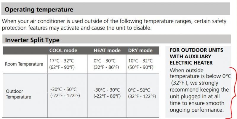

# Posted: 7 Aug 2025 09:35am
How do these units handle intermittent use in cold weather? Say you want to turn power off to cabin for a few weeks at a time, then arrive at sub-zero temperatures and power up. The Senville manual seems to warn against this.
Senville Installation Manual

# Posted: 7 Aug 2025 10:23am
Quoting: rpe
At 0*f you would be useing the outdoor grid strip heater so basicly useing electric heat. At that point there not very efficient anyway so I would use either a wood stove or a $30 space heater.
I didnt buy mine for heat even though I have used it for heat on 50*f days. Where as before I would have started a fire in the wood stove.
