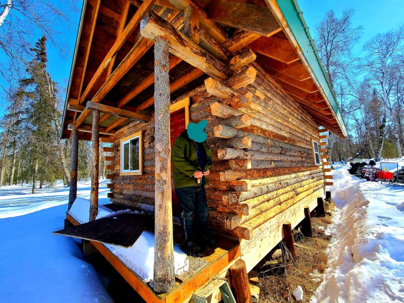

I built our 16x24 log cabin using utility poles that had been replaced. Got them from the company doing the work. Cedar, and coated will a product to reduce rot.
Drilled holes with 2 man auger down 4' and put redi mix concrete in the holes for backfill. I have not seen any issues concerning deterioration. The cement does not allow water to set next to the poles.
Only issue we had was a 7.4 earthquake that caused the slight, tilt because I didn't cross brace. But I even have trees near the cabin that did the same thing. Pretty extreme.
To set the support beams , I used 6x12 i Got from local saw mill that made the 3 sided logs, for the floor. I cut a shoulder into the top of the post and bolted it. Very solid.
A lot depends on your accessibility also. I'm very remote. And everything freighted in with snogos. But I'd suggest this type of foundation based on our experience. Because it is working great.
