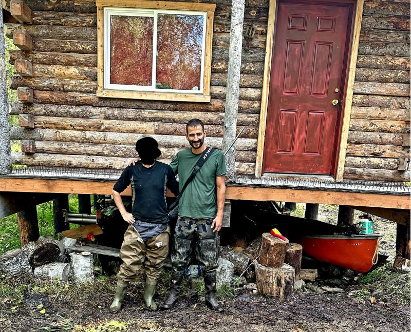

Thanks for the atta boy ! As you wrote. Around here the environment around the cabin. Well remote Ak. Based at foothills of Mt McKinley. Staked 20 acres way back. Being in the outdoors is kinda important to me and I wanted to be able to enjoy the experience as we got oller. And as a 21 year old when I got here. I wanted to build a log cabin in the bush. Always did. Lots of time planning. I didn't want a post in the middle of the cabin. 16x24. So used glue lams to create a grid to support the upper level and use as a structured component. They are mortised into the log walls and I used 16' TnG pine boards the full width. At 8' up I used a 8" wide log creating a ledgure to secure the TnG to. Tying the cabin together. Used 16' 2x12 with 12/12 pitch. With the 10' walls there is plenty of head room upstairs.
And for what it's worth. When I'm there I just think about ways to make things better. Hopefully get out there later this week n get some moose, bear hunting in. And a new dock n well n yeah. Should just sit on the deck. Chill out.
And just my dream. We're all different. I've got some building background so did my things. Most important to me is seeing folks, and their kids grandkids outdoors. Doesn't matter if it's a tarp tent. It's your dreams. Cabin life is a great time

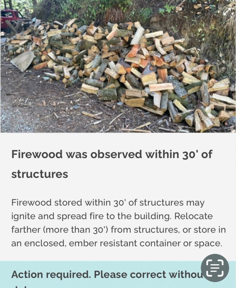

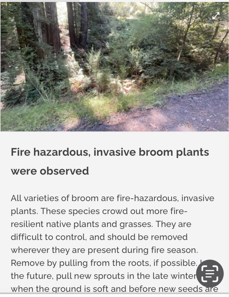

# Posted: 19 Aug 2025 04:37pm
Been lucky here with inspectors but just today the ‘Wildfire inspection” crew came by to look the place over. Something the county or state put together, going through the towns. Knew they were coming, out picking up twigs… they just said my firewood is uncovered, lp tanks outside, couple other things. full report in a couple weeks so if you don’t hear from me I’m in jail.
# Posted: 19 Aug 2025 05:50pm
Let see....we aren't supposed to keep LP tanks inside and they said you have your tanks outside...Ummm, like that's wrong?
Where ya suppose to put em?
# Posted: 19 Aug 2025 07:44pm
Don’t know yet. My hearing is so bad I only heard him blabbing about the tanks It will be in the written document in two weeks, along with my eviction orders.. they are just 5 gallon tanks with the regular rubber hoses and regulators, running to metal conduit.

Uncovered firewood!!you monster!! Hope you get a ticket!!
…Un-f@£&ng-real
# Posted: 19 Aug 2025 09:44pm - Edited by: paulz
From their website:
I might be near 30’ for some
This is the second time these guys have come through. A couple years ago I did have the firewood covered with cheap regular blue tarps you buy anywhere. Can’t have those they said, not ember proof.
Same deal happened to my neighbor lady. She bought those fancy ember proof covers, very pricey.

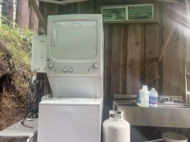

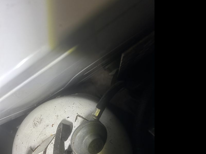

...they are just 5 gallon tanks with the regular rubber hoses and regulators, running to metal conduit.
Rubber hoses are not allowed for connection of tanks to buildings. And if they're 5 gallon tanks with rubber hoses, I presume they're single stage barbecue regulators, which are also not allowed for a permanent installation.
# Posted: 20 Aug 2025 09:26am - Edited by: paulz
Here’s what I’m using. The one tank has a metal shielded hose going to the hard line, Teed off to the water heater and shower outside and stovetop inside.
The other goes to the clothes dryer next to it, outside.
Don’t remember 1 or 2 stage valves, just that they work everything.
The house neighbors around here all have big permanent tanks with the big lp truck coming around to fill them.
# Posted: 20 Aug 2025 10:28am
Nothing like the government creating another crisis. Probably would have been good to let folks harvest dead trees n logging.
Don't know about others but I don't need the government to protect me.
We lost a home to a forest fire. Everything destroyed. I just dug a big hole with neighbors ol, backhoe n burried it. Just twisted metal n melted glass. We have a fork that is imbedded in glass. Engines melted from the wheelers. Puddles of aluminum on ground. Propane tanks exploding. Cutting torches blew.
As a guy that fought forest fires for a summer. They get really hot really fast.
Hey Paul, hope the fire safe cops don't evict ya because you're house might, might catch fire from a forest fire. Crazy
# Posted: 20 Aug 2025 11:03am
Those are sgl stage regulators (dual have 2 diaphragm housings, one may be smaller than the other). They are not expensive.
As for the armored line, it is still rubber inside, that's a no go, it would melt or more likely deteriorate under the armor where you cant inspect it.
Copper tubing might be your best bet for lines when you go to a 2 stage reg.
I expect you have the tubing, flare tool and fittings already in your stash.
# Posted: 20 Aug 2025 11:10am - Edited by: paulz
Thanks. We’ll see when their report comes. I told them I don’t live here full time…
What’s the benefit of 2 stage? Yeah I could plumb copper. Do they not sell corrugated stainless lines or something like that?
Edit: found a 2stage and bit of corrugated in my pile. I must have tried it once, looks like something I would cob together.
A 2 stage regulator holds a more consistent pressure regardless of demand.
There is corrugated gas line. Not sure if it's stainless; it's covered with a yellow coating. But that's for permanent lines, an alternate to copper tube or iron pipe. Between the tank and the regulator you use a pre-made "pigtail", which is a flexible copper tube with a POL (tank) fitting on one end and a flare or pipe fitting on the other end.

Thanks Farman. Yeah I read that about 2 stage regs.. not sure which thing I would need that for. Shower water is either burning or freezing depending on water tank temp, adjust knob right there. Cooktop always up all the way. That dryer in photo I should, or should have undone line, never use it. Ill start on changing out the other hose.
