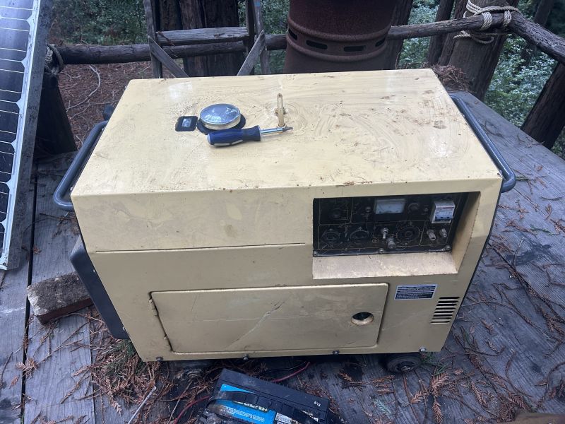

Been using my old new to me diesel generator. It has no warm anything pre start and takes a half dozen 10 second starter cranks (manual says wait between cranks to save motor). Then 4-5 pops and off it goes. An ether shot does nothing.
Seems much like my dead Massey/perkins backhoe, except it just turns over, no pops. There s a spot to heat the intake..

travellerw
# Posted: 13 Dec 2025 12:59pm
I just fixed a diesel generator exactly like that. Exact same scenario, wouldn't even pop.
Turns out someone used ether on it and blew the ring lands completely out. Required new piston and rings. There was a reason it had a big sticker on it that said NO STARTING FLUID.
