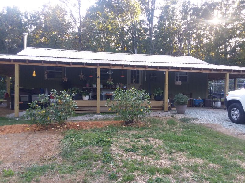

itsadamnshame
# Posted: 19 Sep 2025 05:53pm
The siding is in excellent shape. They say 50 year warranty. I just don't like the look of LP smart side siding. Like I said it has a 10 ft. extended roof all the way around it. I just keep reading articles about you need house wrap or you will have problems. After the $$ I just spent on windows the smart side siding probably needs to remain in place. Here's a pic.
cabin
cabin
# Posted: 19 Sep 2025 06:45pm
Wrap tyvex in all the stud bays in a continuous wrap.
DRP
# Posted: 19 Sep 2025 08:05pm - Edited by: DRP
It doesn't look like you need it for a weather resistive barrier. It was sheet material, how much air leakage is there and can you take care of any problems at the edges/seams? If so, you're really done with what the WRB, weather resistive barrier, was doing.
spencerin
# Posted: 19 Sep 2025 09:49pm
House wrap's primary purpose is to prevent water intrusion. You have a 10-foot overhang around the entire cabin - ain't no water gonna intrude! Otherwise, use a dehumidifier to take any interior moisture out of the air if needed, which you'll likely already have in the form of an AC unit. If there's a 50-year warranty on the siding, I wouldn't mess with it.
itsadamnshame
# Posted: 20 Sep 2025 04:23pm
I wasn't worried about rain actually hitting the cabin with a 10 ft. overhang. Just wasn't sure with moisture in the air some how could penetrate behind the siding?Last week we had several days of foggy, misty weather and it has bothered me that there wasn't a wrb behind the siding. I guess researching on the internet "do I need a wrb behind the siding" and all returned searches were doom and gloom, if I didn't have it, made me very uncomfortable.
I'm glad I reached out to this forum. I'm not going to worry about it and put the money towards a mini split.Thanks a bunch!

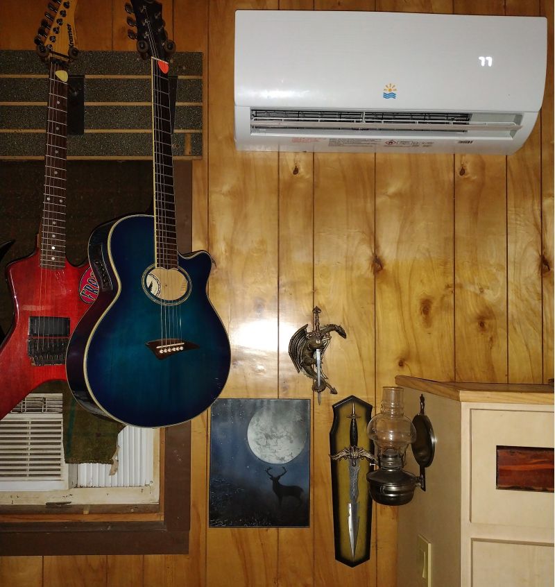

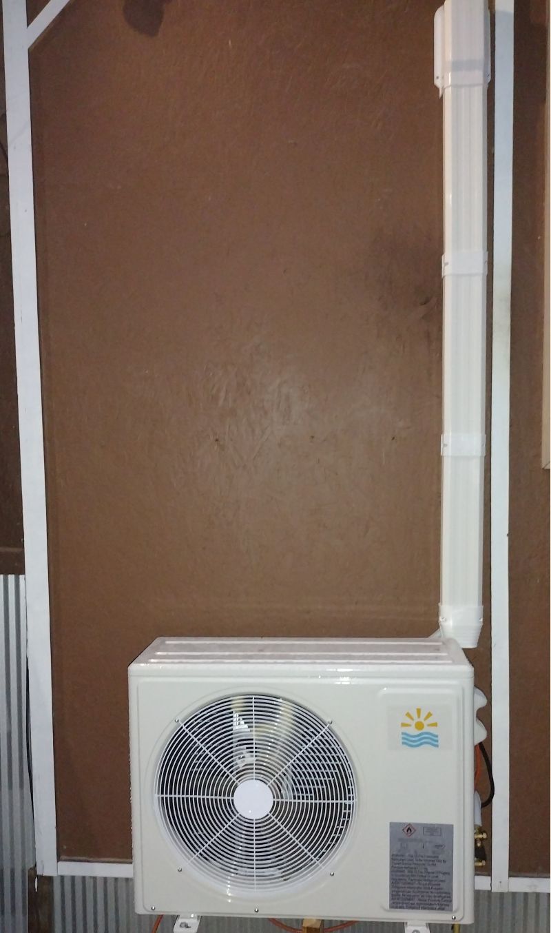

# Posted: 23 Sep 2025 08:01pm
I did like Brett did. Got the AC kit with the pump,
gauges and leak detector.
Unfortunately the first unit was wrecked by Fed Ex.
The driver was flipping the outside unit end over end when I walked up to the truck.
I contacted the seller and they sent me a new outside unit when I sent them pics of the bashed up box. They let me keep the old one, so I guess I got extra parts if needed.
Anyhoos I got it up and running, and am very happy with how well it works.
# Posted: 23 Sep 2025 08:15pm
Inside and outside.
