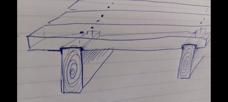

The 4"x10" joist spans on the cantilever deck are 3 feet and four feet on my deck. They protrude from the house about 5 feet across the 25 foot width. They used 2x6 boards on the build in the 80s and I want more support when I replace the rotten boards. I don't want to add more joists, but want to get 2.5" x 6" dimensional lumber milled.
Does this seem like the most reasonable solution?

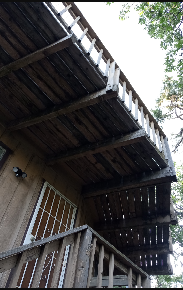

This is the deck I am talking about.
Roughly 120 sq. ft.
Just over 12.5 feet lengths
I got a quote from a lumber company to mill down 24 larger beams to 2.5 x 6 x 13 boards at @ $75 per board for pine. It is milled down with no scrap as it goes to waste. Roughly $1700. Crazy being standard 2x6x16 redwood boards are only $35 max at the box store.

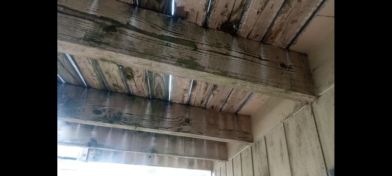

Here is a closer shot of the beams. They painted the whole house and deck probably 15 years ago likely right before my family purchased it. The peeling paint makes the boards look worse than they do in person.
