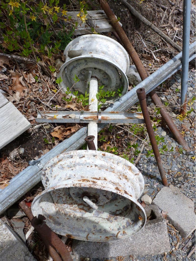

For one thing, I'm not that capable a swimmer! The current setup doesn't use black poly; I have 10' sections of 2" threaded pipe. Here's how it's done today: mount the pump to the carriage, screw a section of pipe to the pump, zip tie the electrical wire to the section of pipe, push the pump into the lake 8', screw a new section of pipe to the first pipe, zip tie the wire, push it out 8', repeat until there's no more pipe sections, make a final connection to black poly, & plug it in. I've included a picture of my current carriage that I'm looking to replace. I can't imagine hauling that out in a canoe (with the 30 pound pump attached) & tossing it in. I'd capsize for certain.

# Posted: 13 Oct 2025 09:39pm
So the wheels trolly down the rails?
Instead of 'bulling' the works how about using a winch?

gcrank1 - no rails involved, the rims ride over the rocks, sand, etc. as the pump is pushed out. Could probably use a winch to pull the pump in but not to get it out into the lake.

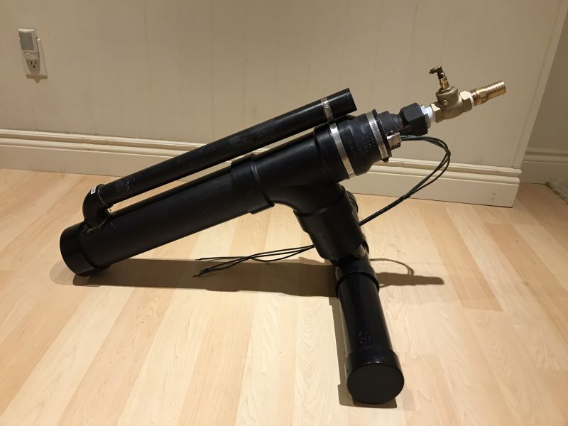

Here's the submersible pump stand I built of ABS leftovers. There are some important design details to get right. If you end up going this route, I can describe in more detail.

If your trying to make things easier, why not entertain the idea of changing what your currently using. The pic rpe posted is what I was referring to by changing pumps. Something that small and light could be removed each year, but like rpe, run poly from the pump up past the water line. Connect there to your pipe if you want, and just brake it there to drain, let the poly freeze.

Like Fish says, I would get rid of the galvanized pipe as step #1. Poly pipe could stay in year round. If you must remove for some reason, leave a rope and float attached to the pump stand, boat out and lift it off the bottom, and have a friend pull you to shore.

bootabb67
# Posted: 27 Apr 2026 09:18am
great idea , im looking to build some thing , what did you use to attach the 1 1/2 inch elbow to the 4 inch
thks
