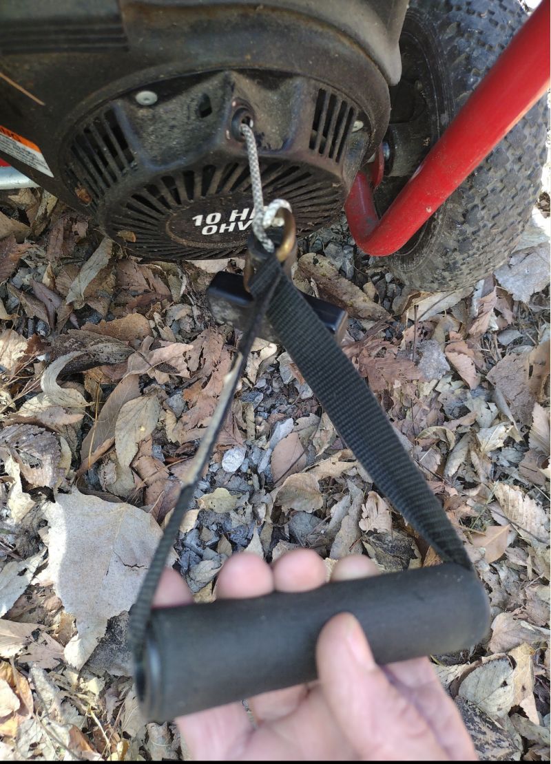

I have a generator with a 10 hp motor. Sometimes its hard on the fingers to pull start it.
I took a leftover handle from exercise bands, and easily looped the cord thru the D ring. Now it's a lot easier on the fingers to pull start it. Its kinda like those D handles you can buy.
# Posted: 13 Nov 2025 04:41pm - Edited by: paulz
Excellent! I have the same problem. Give this old dog a half hearted pull and it rips fingers off on backfire.

# Posted: 14 Nov 2025 11:38am - Edited by: darz5150
Wouldn't hurt to check the valves, but I think my old Kung Fu grip is more of the problem. Lol
One of the best things about this hack is you can easily remove the handle and use it on chainsaws, mini bikes, go karts etc. with no damage on the pull cord.

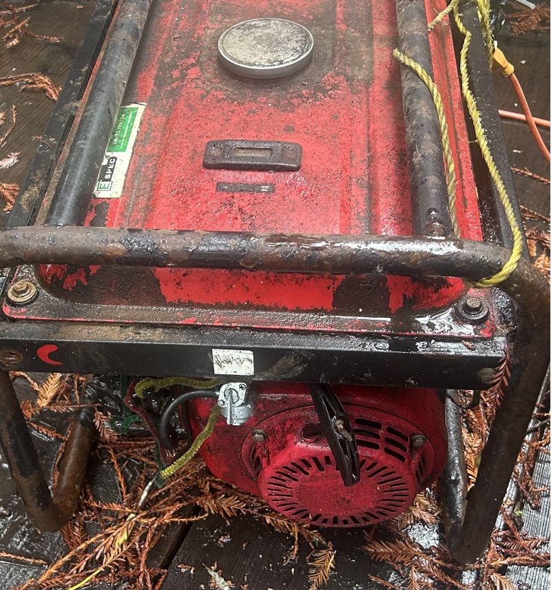

# Posted: 14 Nov 2025 03:46pm
Quoting: travellerw
Most have a decompression device on the camshaft and when it doesn't work right you get a finger ripper.
Interesting. Mine seems to have high compression no matter how slow you turn it over. No e start. It’s old been here since the cabin build. No idea of brand or spec, decals long gone. But it starts one strong pull every time. Hate to mess with it, I seem to have the brown thumb with generators lately. Gave the dead Mightyquip away, Onan still sitting here dead. Luckily the Generac for the well pump alive and well, couple others still in backup.
