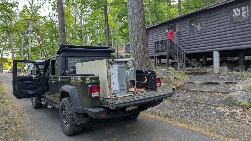

If you need to leave it running, that's what you want. We have a standard fridge in our cabin, but we unplug it when we leave in October. On the occasional winter weekends we just leave the food in the coolers we brought it in, the fridge never gets plugged in until April or May.
Though we did just replace it; we got a new fridge for the house and the old house fridge was newer and better than the old old fridge in the cabin. Getting it from the truck to the cabin (about 50 yards of trail) and the old one out was interesting. Then the old one went to the staff cabin at the kid's camp our daughter and son in law work at; instead of driving 2 miles or so on the paved road I took the woods road which is only a half mile.
Here we're getting ready to carry the old one up those stairs.

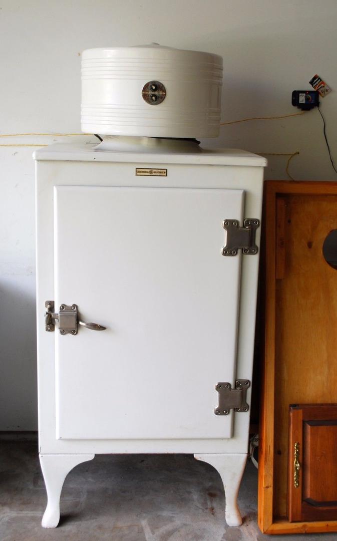

A client helped raise its namesake, so he had to have it when he saw it. It lives in the man barn, is unrestored, a century old, an energy hog, and it still runs.
I salvaged the logs from an old saddlebag cabin years ago. There was the predecessor to the Monitor in there, an icy ball fridge, I think that was the 1st commercial model.

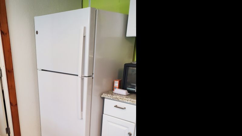

Well, new fridge arrived today, ended up with a GE garage ready cheapo. We'll just power it off during winter months when we aren't here.
They delivered a smashed up fridge yesterday, had to decline it, that stunk to high heaven, we 100% planned on having a fridge yesterday. Made the hour trip this morning for more ice. The new fridge should be cold in a few hours. Hope the raw meat survived, we'll find out tonight.... errr tomorrow.
