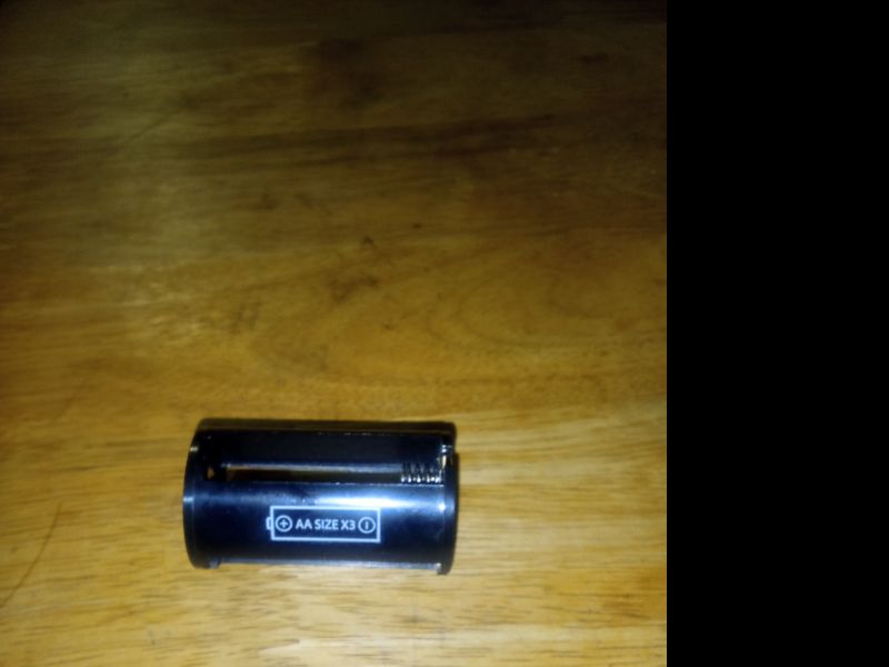

# Posted: 4 Jul 2026 11:48am - Edited by: darz5150
Darz, do they make those green rechargeable in D?
Yes they do. I don't know about the corrosion factor tho.
I've only had 1 AAA corrode, but the radio I had them in, I left out in the rain.
They also make D & C adapter sleeves, that basically shim up the AAA /AA size to fit your device.
You already have some that came with your mini gas pump.
3 aa to D adapter
3 aa to D adapter
