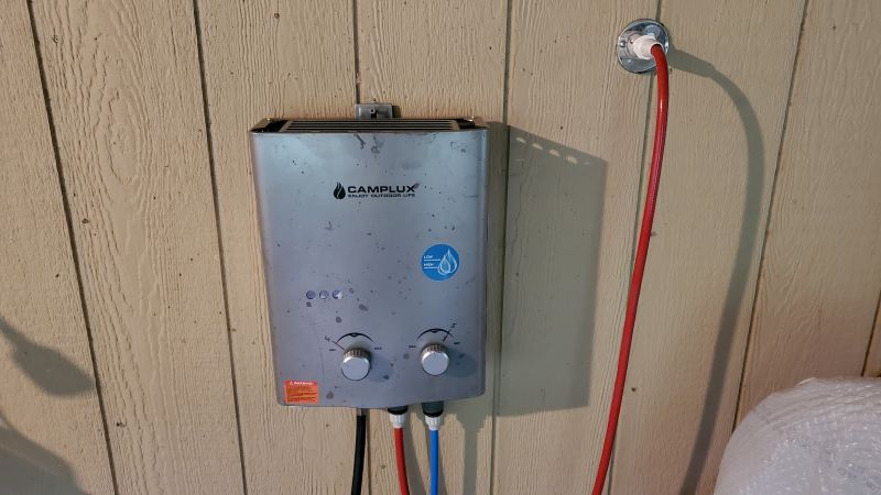

I don't have either of those exact models but do have a smaller Camplux model with manual gas and water flow controls. It works best with cold water right from the well but can be managed with warmer water. It produces what we call a "city shower". It is capable of producing very hot water even in the winter. When it dies I'll definitely replace it with a fancier camplux like the one you linked to. This one is 4 years old and going strong so quality hasn't been a concern for me. It's probably time to flush it with some vinegar.
