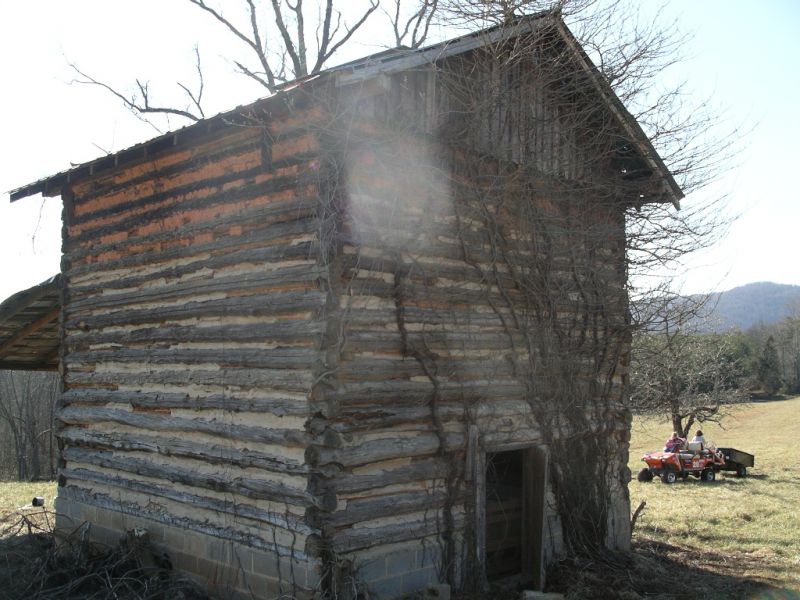

You have asked a few questions I can help you with. Mother earth news had a concrete recipe that an old timer used to chink with. I can look it up later , but don't have access to it now. I would take every bit of the old chinking out, and have the logs soda or soft media blasted. Once they are cleaned up coat them with a borate insect repellent killer. Boat builders use it and may provide a formula. I A borate formula is commercially available as well. Were I in your place I would put foam siding against the block on the inside then cover that with a vertical board treatment. There is a builders term for that. Once your logs have been blasted and re-chinked I would stain them. That should give you the maximum rustic appearance with a small amount of structural remodeling. If you intend to put in a loft then use beam and post to stay true to the log construction. Good luck and show us what your working with. Pictures are always better than words. It will help to provide some specific direction for you.

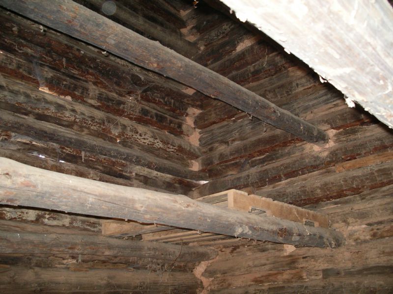

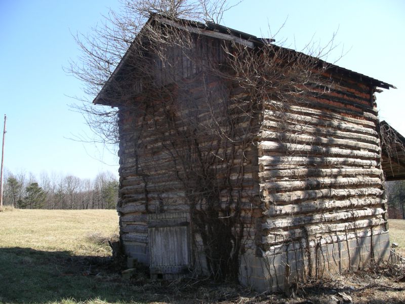

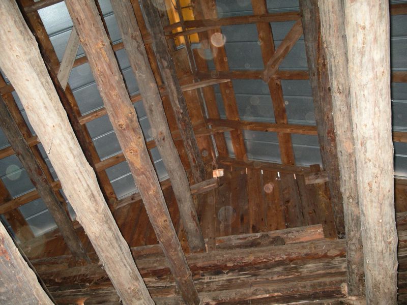

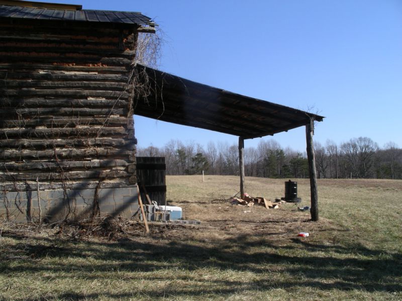

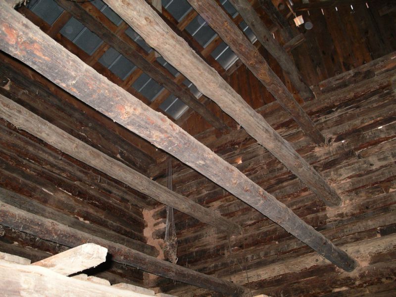

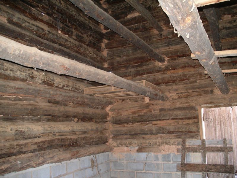

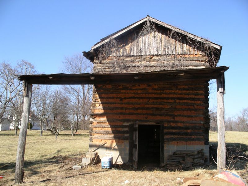

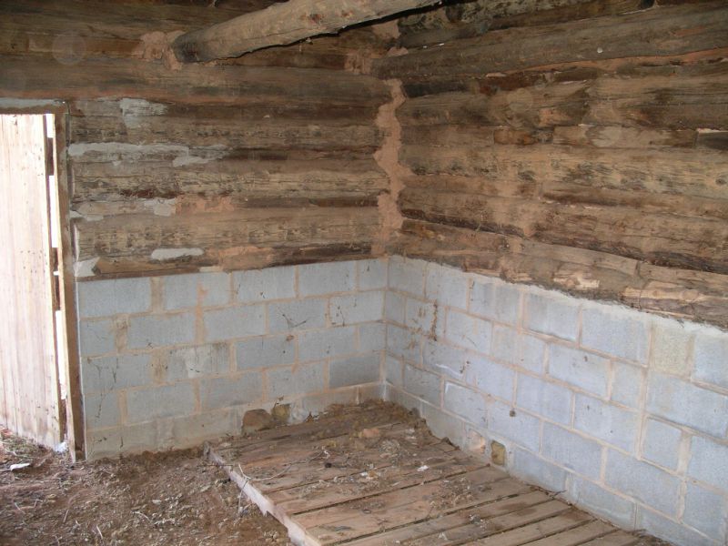

Great, THANKS for the reply, here are the pictures of the barn. I plan on digging out the dirt floor so when I put in the floor it is level with the bottom of the door. I beleive it is high enough for 2 floors and maybe 3, but the third might be close to the rafters. My wife drew up a great plan for the first floor but we are still undecided on what to do with the building.
Back left corner
Back left corner
Back right corner
Back right corner
Front
Front
Left side
Left side

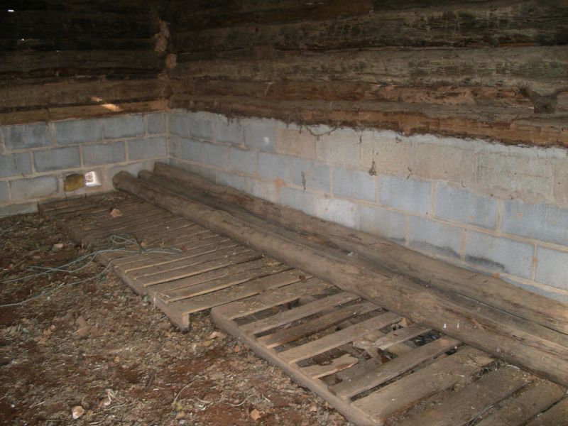

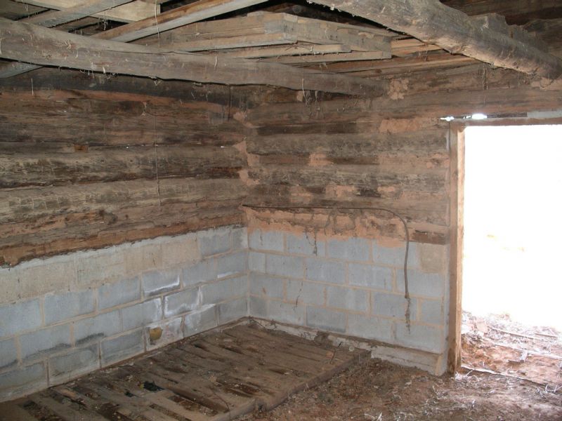

Inside back left
Inside back left
Inside fwd left
Inside fwd left
Inside fwd right
Inside fwd right
Interior
Interior

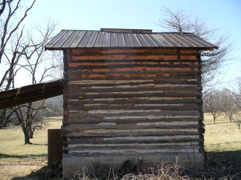

Left side
Left side
Right side fwd
Right side fwd
Right side
Right side

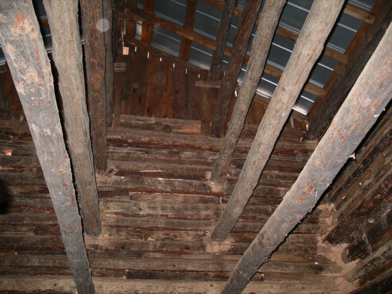

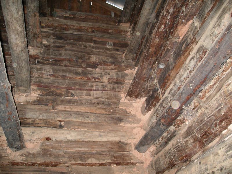

Upper interior 1
Upper interior 1
scp1754
# Posted: 31 Jul 2011 04:47pm
Last set......for now
Upper interior 2
Upper interior 2
Upper interior 3
Upper interior 3
Upper interior 4
Upper interior 4
Upper interior 5
Upper interior 5
