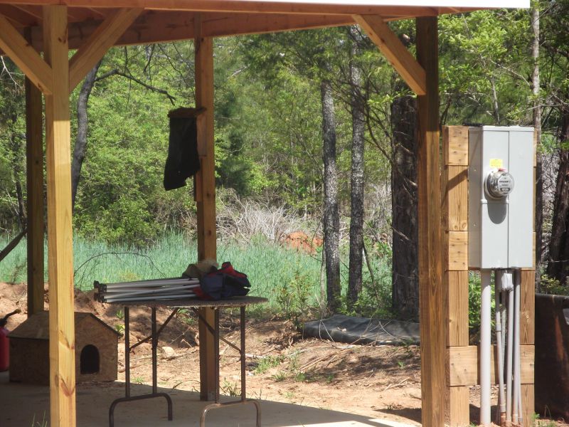

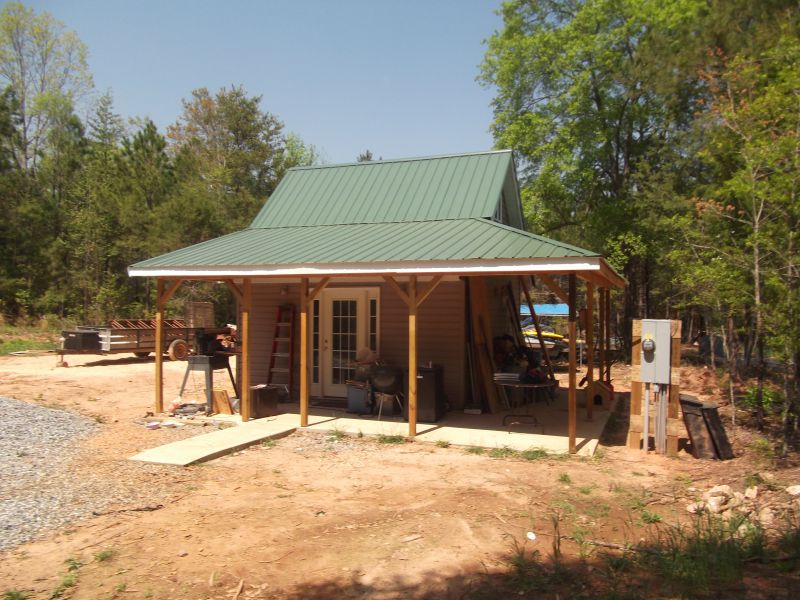

My Cabin for anyone wondering. 200 amp may seem alot for the smaller cabin but there will likely be an rv or two in her front yard so will have a few outdoor hookups. Site Pics Tomorrow
