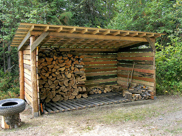

# Posted: 25 Sep 2011 03:26pm - Edited by: CabinBuilder
Here is mine.
* Pressure treated 4"x4" posts with diagonal support beams * Vented walls for free air flow (used various leftover OSB and plywood sheets)
Thinking about adding a divider wall, to keep fresh cut separately from seasoned & chopped wood.
# Posted: 25 Sep 2011 08:57pm
Yes, green side vs seasoned side. Burn from seasoned side, fill on green side. Green side should be filled before seasoned is gone. If not, yoo have been slacking. :D
With yours, I'd split it either down the middle or build another one depending on how much wood you consume.

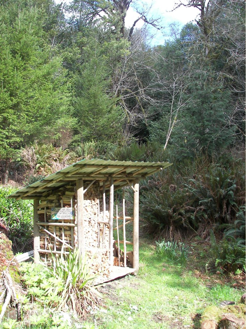

nicalisa
# Posted: 17 Nov 2011 12:18am
here is our wood shed. We are not there too much in the winter, so what is in there will last for years. It is seasoned now at 2 years.
We burn fir and the odd cedar if we had rounds that were leftover:) we have lots of both kinds of wood as you can see:)

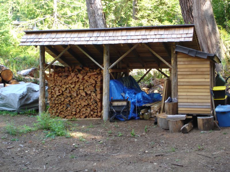

Ted3
# Posted: 4 Dec 2011 10:09pm
My wood crib started life as a chicken coop. It has cedar board and batten construction. It is deeper than it is wide, so I stack firewood on both sides and at the back wall so it has a center aisle (where I store the wheelbarrow). The shed roof slopes toward the rear. I estimate that the shelter can hold 2.5 cords, which is plenty to heat our cabin. It's best feature is a low-sloped "porch" roof that slopes toward the front, which protects the wood from blowing rain from the south.

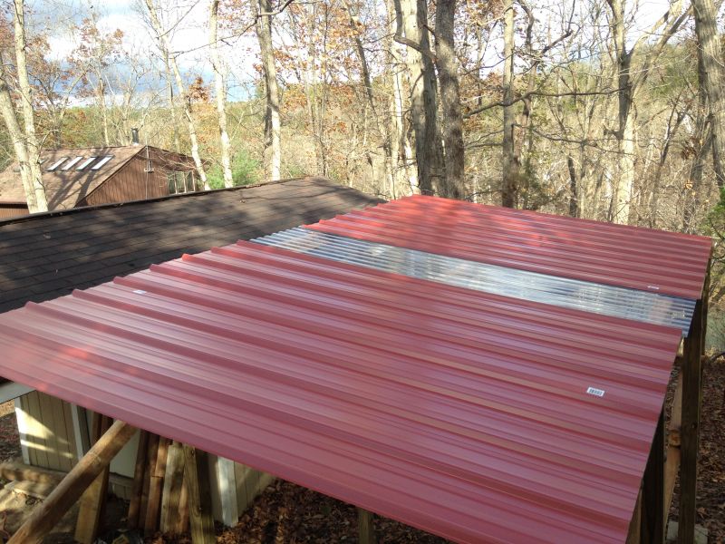

RichInTheUSA

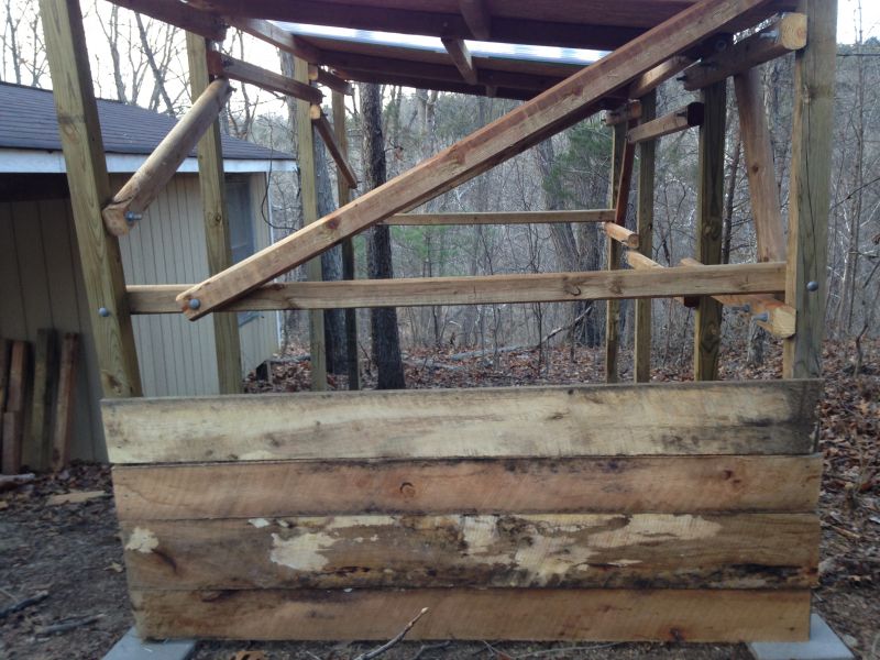

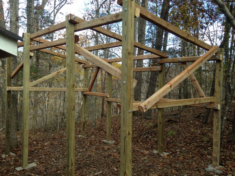

# Posted: 30 Nov 2018 09:15am - Edited by: RichInTheUSA
I'm in the process of building mine. I used 4x4 posts, and landscaping timbers. Metal roof with a plastic "sky light".

Janemarie
# Posted: 23 Dec 2018 06:48pm
I am going to try and make a woodshed this next year with my most limited skills at building. I figure if it collapses, nobody will be living in it at least.One question: On all of these above, are posts dug into ground? I am old and feeble.
Janemarie
# Posted: 23 Dec 2018 06:50pm
Quoting: RichInTheUSA I'm in the process of building mine.
Yours looks set on the ground rather than dug in. Right? Skylight is for light or any other reason?
