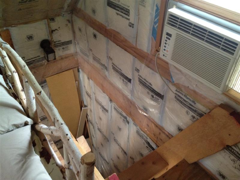

I made a bedframe out of birch some 15 yrs ago and it is still in use today with not a stitch of loose bark! I cut the logs in summer but they dried out pretty good in the basement at home before I started making the frame. I think this shows the frame

Yes, that is what i wanted to do and I was wondering if the bark would hold. I see it will! We ended up buying an antique iron bed instead-just stumbled across it one day at too good of a price to turn down. I hope we can use birch logs for future projects...they are so pretty.
