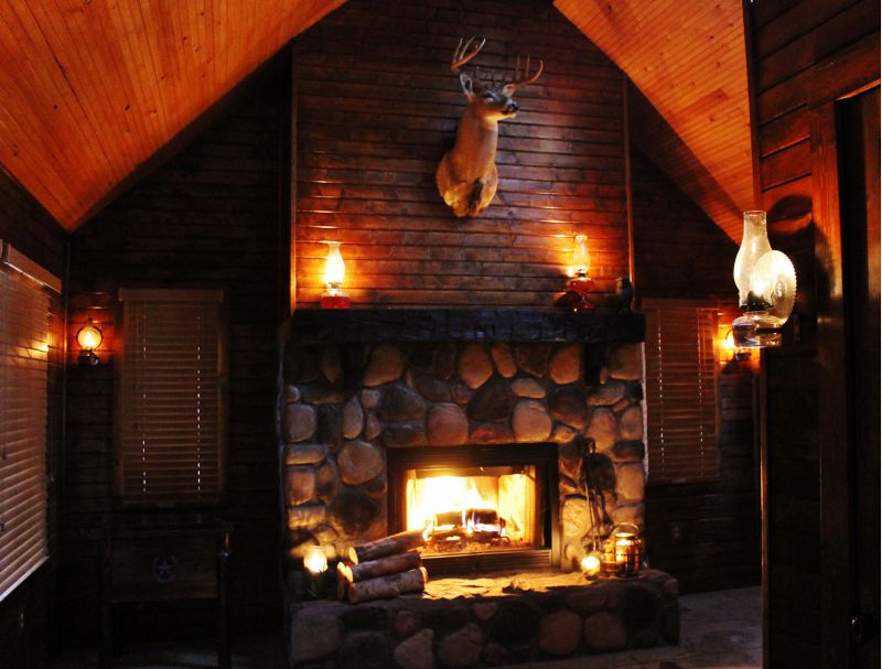

dfosson
# Posted: 6 Nov 2011 01:25pm
I've been looking for pictures of cabin fireplaces on this site and other than my own, haven't seen any yet. Just wondering if anyone had any problems or issues with installing their fireplace. Mine is made of framed up studs and a pre manufactured firebox with stone veneer to reduce weight since the cabin is on posts. It is the focal point of the cabin and if I build another cabin, I'm curious as to what other styles are out there.
TomChum
# Posted: 6 Nov 2011 04:13pm - Edited by: TomChum
That's awesome! That sure looks inviting, and nice pic too. There's something CLASSIC about an open fireplace...... They might be a waste of energy, but if you have a lot of wood hangin' around then so what? People say a fireplace doesn't heat up a room like an airtight stove, but when I open the doors on my stove, the blazing fire feels a LOT hotter. Just closing the screen makes a noticeable difference.
The extremist cabin nut in me says artificial stone is for shopping malls, use real rock in cabins. I do understand sometimes you just have to git'er done. Anymore it might be hard to find someone who could make one out of real rock, and you'd probably get arrested gathering the rocks too. And as mentioned you'd need the foundation to support it.

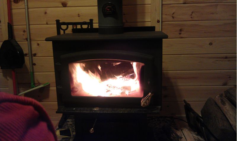

# Posted: 8 Nov 2011 05:05pm
We wanted a real fireplace but due to insurance cost,smoke,bugs and mildew on wood and the time to manage a wood pile and the fact it is a summer cabin we decided on this propane stove. Keeping warm in our cabin.
dfosson
# Posted: 14 Nov 2011 06:00pm
Quoting: silverwaterlady We wanted a real fireplace but due to insurance cost,smoke,bugs and mildew on wood and the time to manage a wood pile and the fact it is a summer cabin we decided on this propane stove. Nothing wrong with that set up! Looks like a good place to spend a cold eve. I love my cabin in the winter and really look forward to the labor required to keep wood available. I have a natural gas fire place at my "city house" that is getting too expensive to operate. With the cabin in the woods, there is always plenty of free fuel!
# Posted: 14 Nov 2011 10:29pm
masonary fire place in our place at the lake looks a lot like yours dfosson. built in 1949 still works well repointed the chimney last year.
dfosson
# Posted: 14 Nov 2011 10:41pm
Quoting: Just masonary fire place in our place at the lake looks a lot like yours dfosson. Love it! I really like the classic wood work; original paneling no doubt.

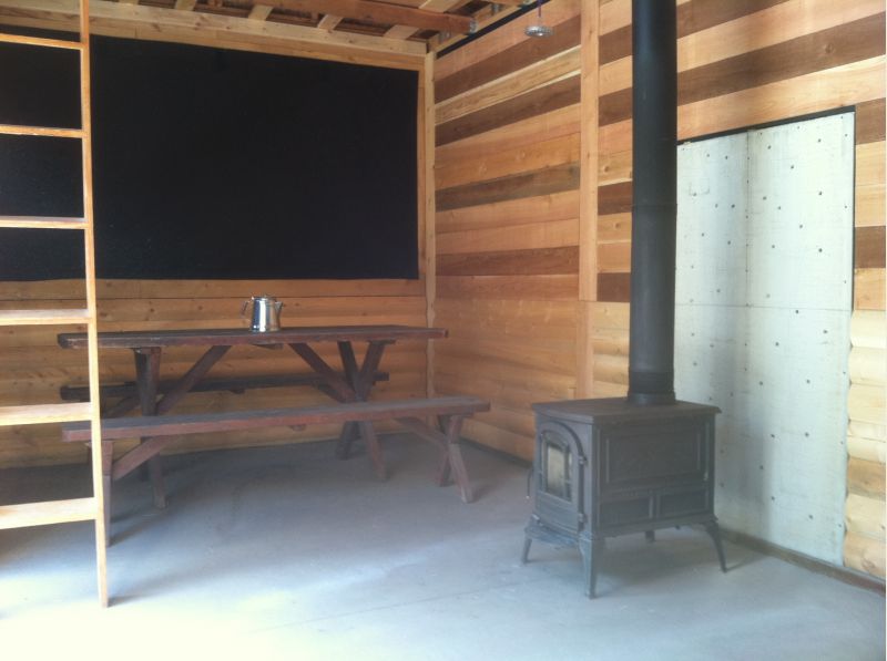

brokeneck
# Posted: 3 Dec 2011 12:06am - Edited by: brokeneck
ready to rock -- West Chicago Creek is within 25 feet so I've got a great source of materials..
dfosson
# Posted: 3 Dec 2011 07:37pm
Nice! What do you plan to finish the cement board with behind the stove?

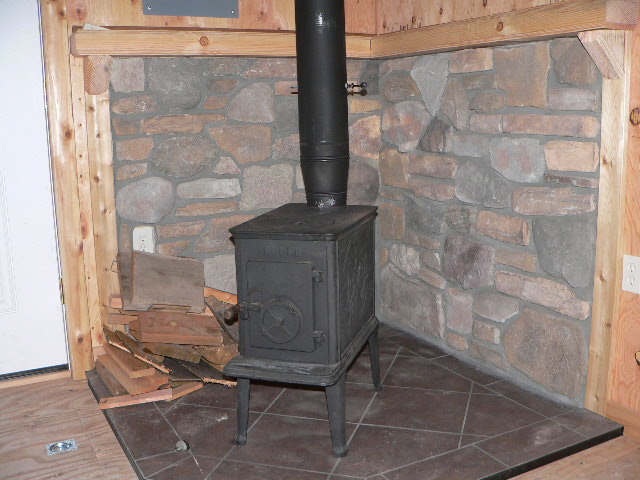

larry
# Posted: 4 Dec 2011 10:01pm
this one works well

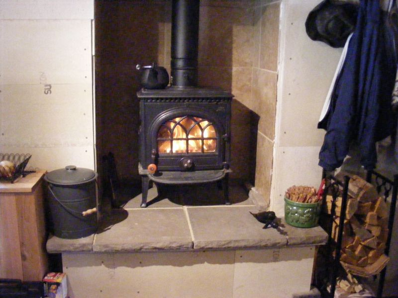

# Posted: 5 Dec 2011 11:29pm
Here is our little wood stove. The concrete board will (when funds are available) will be finished with cultured stone.
This little stove seems to works pretty good in our little cabin 12x16 with a loft.
I have not had any luck keeping it burning most of the night. It has a small fire box. Any helpful info on keeping a fire burning all night?
Thanks Nick.
# Posted: 6 Dec 2011 10:04am
Hick, I like your wood stove and the way you designed the wall and bump out which saves tons of space. A couple questions: How high up does the bump out go? to the ceiling? Also, where did you get your ash bucket and your log holder? I like them a lot! Thanks!
dfosson
# Posted: 6 Dec 2011 05:11pm
Quoting: Hick I have not had any luck keeping it burning most of the night. It has a small fire box. Any helpful info on keeping a fire burning all night?
Hick, I grew up in an old farm house that only had Franklin fireplaces. We learned early to 'bank' the fire before going to bed. After adding the wood for the all night fire burn, we would then cover the logs with the ashes. This kept it burning slow from bottom up instead of fully igniting.
Hick
# Posted: 6 Dec 2011 08:23pm

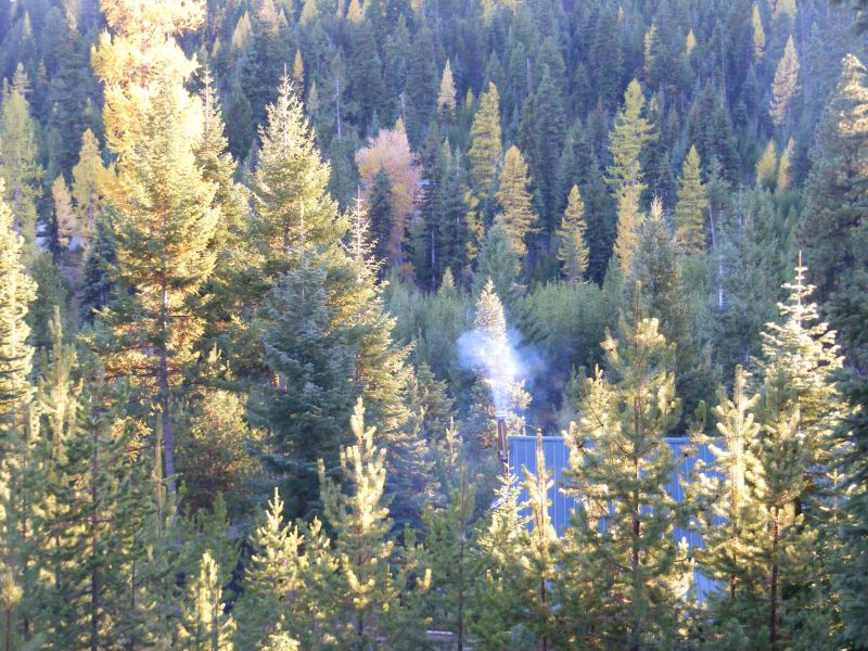

Tollbridge, My wife found them at Plow & Heath. I'm sure they have an online store. The concrete board is about 7 feet up. The bump out goes up into the loft. We were going to put vents in the side to let the heat up, but I don't see that as being a problem.
Dfosson, Thanks for the info. I think it will hard to do with the small fire box, but I'll give it a shot. Bump out from the Loft
|  Bump out from the outside
# Posted: 6 Dec 2011 09:05pm
Thanks Hick for the info. I'll have to look them up.
I love the bump out cause I think it is a really good way to save interior space and easily meet all the proper clearances. Good thinking!!!
Does the heat get trapped up behind the wall? That is something I was curious about or you don't think you will need vents to let it out?
Hick
# Posted: 6 Dec 2011 09:29pm
We sealed everything in that area with fire rated caulk. I think it will be good when we have all of the cultured stone up. The tiles seem to help with the heat too.
The vents at the still might get installed.
My wife and I are both looking forward to heading up to the cabin for Christmas this year with the wood stove.
The simple things in life are some times the best.
# Posted: 6 Dec 2011 09:53pm
You are lucky you will get to spend Christmas at the cabin and the simple things are the best!
The stone is going to look so nice when you get it done! You'll have to take lots of pictures and post them. What will your stone look like? Stacked, fieldstone?? Do you have experience installing it at all?

# Posted: 12 Dec 2011 06:50pm
Quoting: Hick Bump out from the outside
Hick, picture of your cabin, from the Tamarack and douglas fir, , I'd say its fall, maybe october, your elevation is about 3700 feet. How did I do. :D
Hick
# Posted: 13 Dec 2011 08:38pm
Pretty close! It was Halloween weekend. Our elevation is 5200 to 5400 feet. What area is your cabin in?
brokeneck
# Posted: 18 Dec 2011 10:21pm
I'll be using river rock from the creek --to keep the space between the stove and the wall large as possible I'll have to use either small fist sized stones or if larger -- flatter ones. I driiled some holes in the cement board for the mortar to migrate into and will attach some screening before I get started. We'll be up for Christmas and I hope to get some of it done then.

# Posted: 18 Dec 2011 10:31pm
You might try stacking the large pieces of wood on the bottom of the stove first, and tightly together, then building your kindling fire and medium wood on top. It will burn much longer that way.
