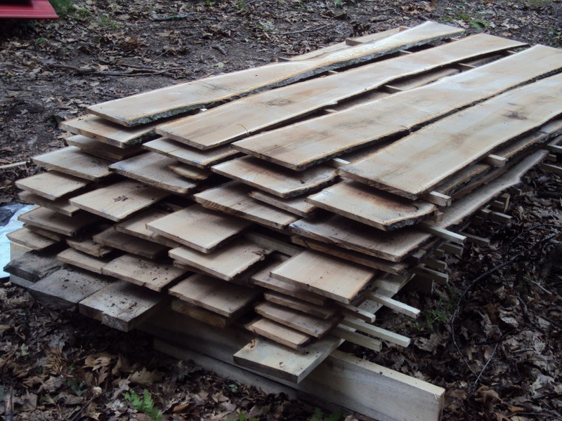

Let the logs dry or use a mill that has a kiln. Or you can cut the flooring and let it dry before squaring it up. I cut a bunch of flooring and stacked it to dry last spring. I left the live edge on the lumber. Then next spring or summer I will square it up with the mill, cut some slots with the table saw and put it down.
Log length does not normally matter when sawing, most sawyers charger by the board foot. If I didn't have a mill, I would probably cut and stack that logs at about 12' and bring in a sawyer with a portable mill. 12' is pretty easy to handle with a log arch, ATV, and cant hook for getting them out of the woods. When you start going bigger, then it becomes a pain. Portable saywers can generally cut 16', some can go to 20'.
Red Oak Flooring - Stacked for Drying

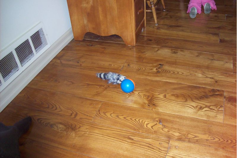

White ash floor , cut from our own bush , the saw mill came to us because we garenteed him 8 hours work at 60$ per hour
always saw green wood if you can ..pile and strip every 12 in. for one year then plain and sq the lumber. I used all 4ft boards in 12s 10s 8s and 6s for this floor.. most of the logs were 4s or 8s ..
martian is right must be at least 4ft better if they are 56 in.
ash floor
