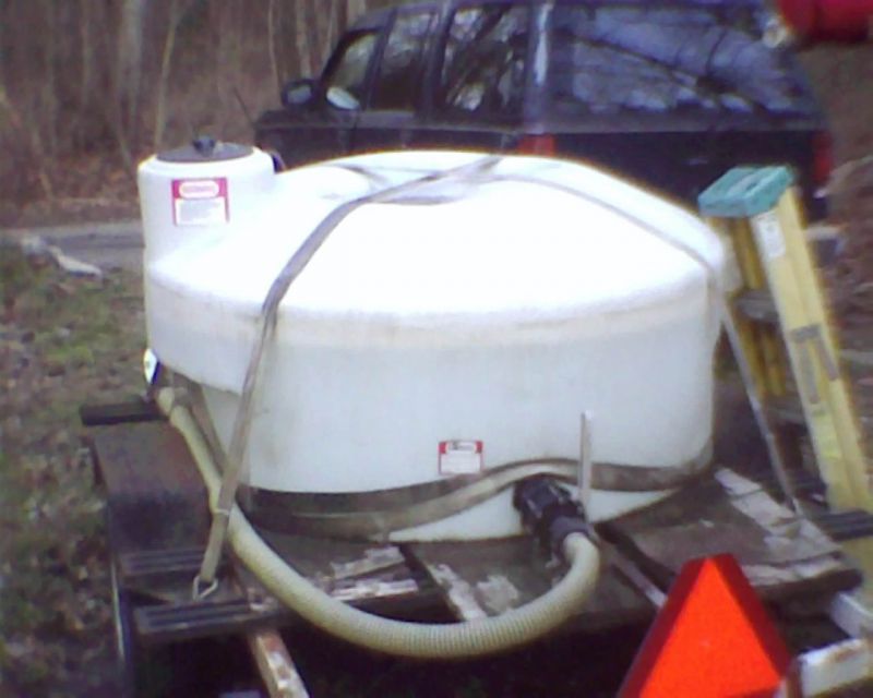

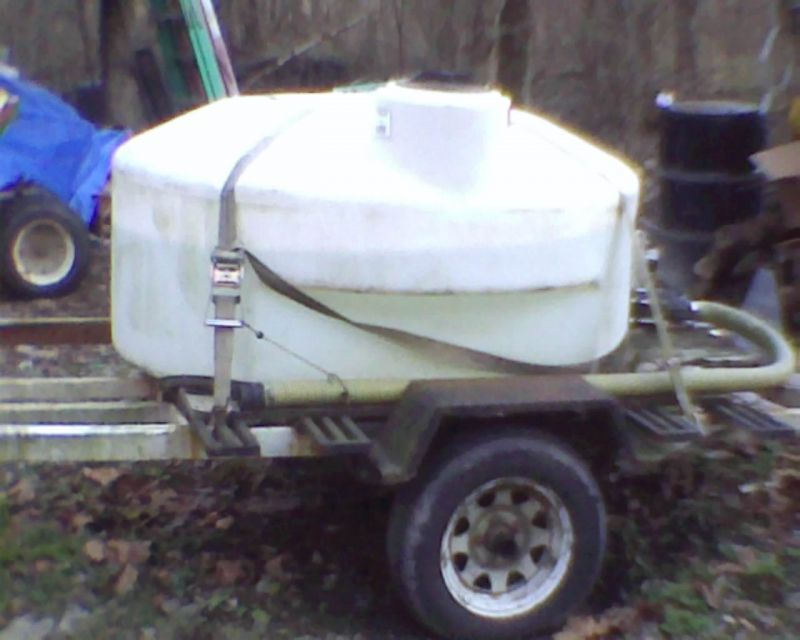

I built a "water wagon" out of an old boat trailer that I got for free. I put 1 x1 steel tubes arcross the frame to beef it up enough to hold a 325 gallon water tank that I picked up 2nd hand for $100. I shortened the tongue of the trailer about 4 feet to make it easier to manuever around. I fill it up twice a month at a nearby towns water depot for $2.00 each fill. I think most major towns have a place for construction companies to get water for building projects available. If you can't find one of these places you can fill it at a nighbors or friends house in about an hour.
