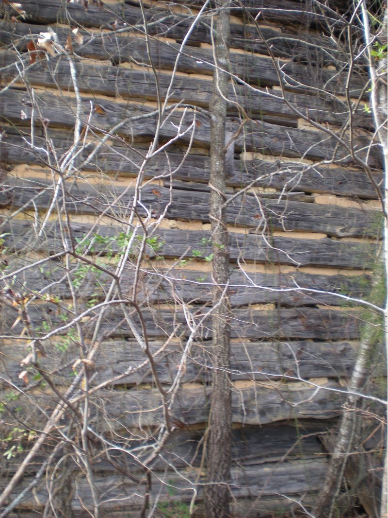

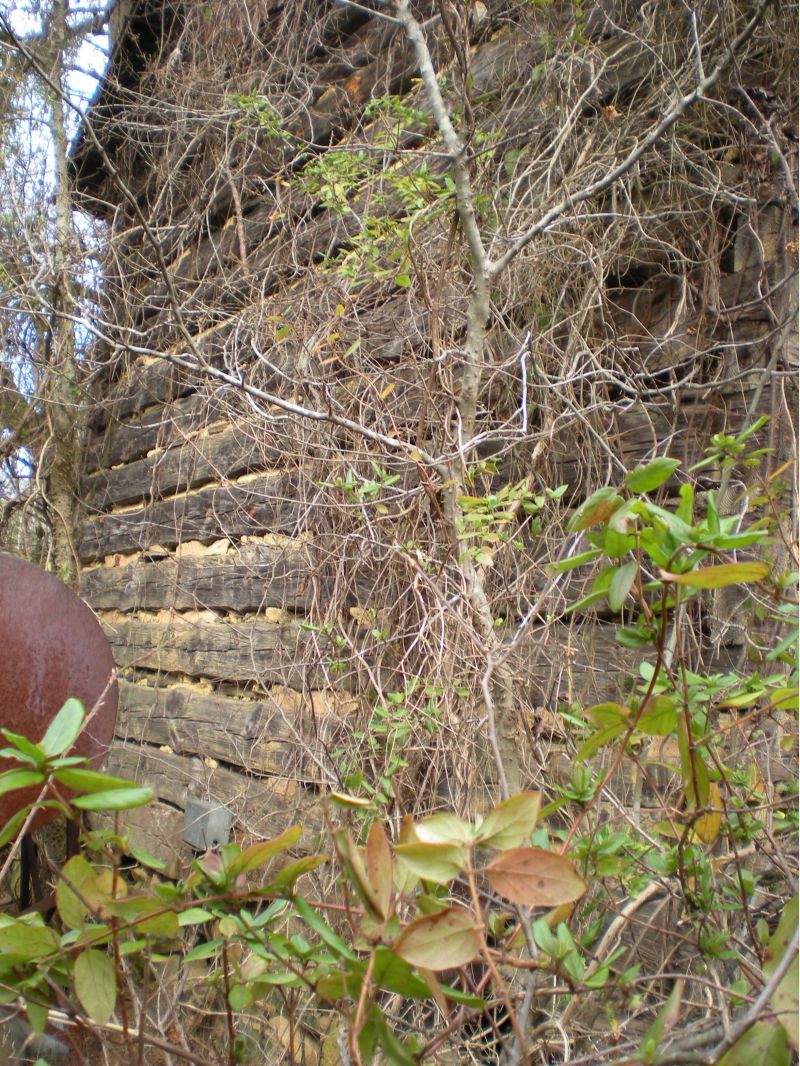

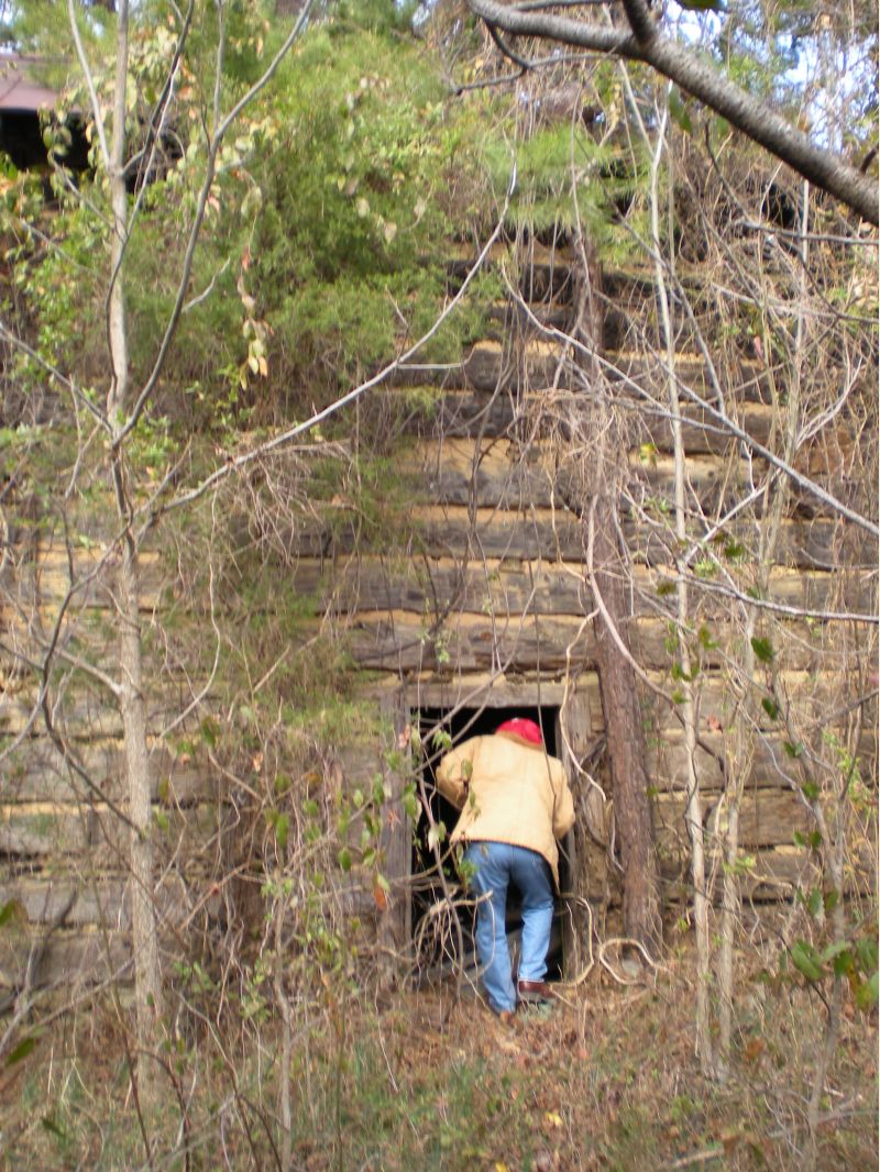

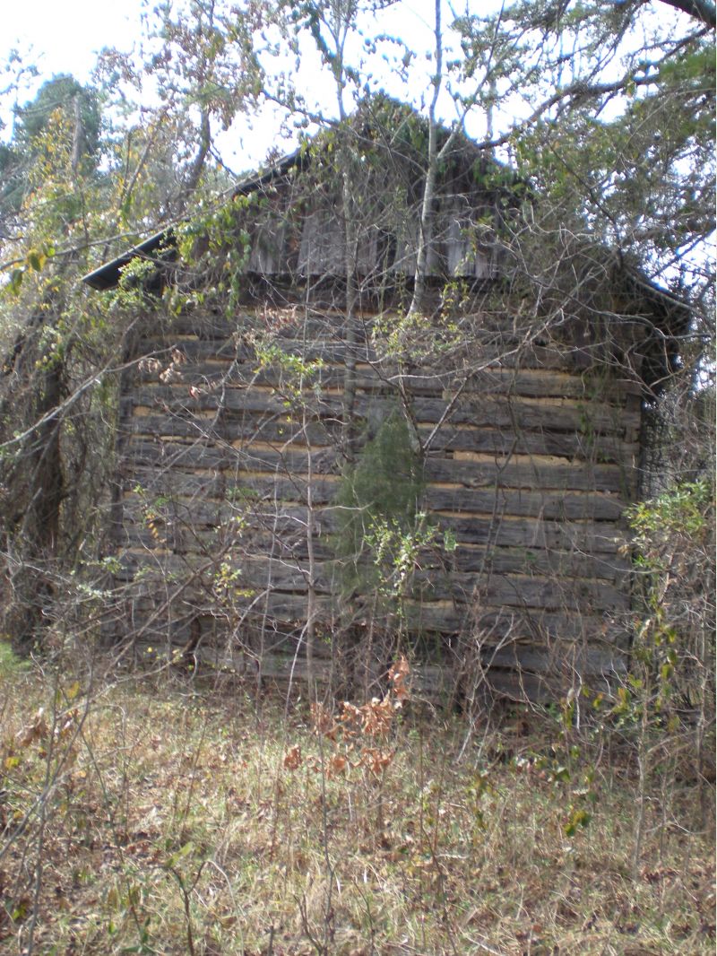

Here are some photos of the existing structure.
Tobacco Barn
Tobacco Barn
Jerry
# Posted: 25 Mar 2009 16:52
Man that looks like a great building. I would definately go forward with your project. Something to think about is your future foundation. If it will be something like a wood floor built on posts, or a continuous block footing around the perimeter, or a cement slab, you will have to decide which logs on your first coarse to cut in half lengthwise so that the corresponding next course will sit on the floor. And those oak logs are going to be heavy, even after 100 years. Good luck and keep us informed of your progress.
