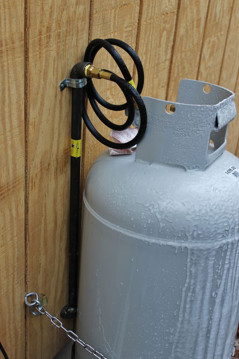

 Agree with the posts. My 100 lb tank of LP was set up with single low pressure regulator from Tractor Supply. Its about the same as what is on gas grills. Mine was for a supplemental wall heater that is 20000 btu but these standard regulators will work fine for your stove which really isn't larger than a gas grill when it comes to demand. I used black iron pipe into the house and a generic flex line with valve at the appliance. At the supply tank, I purchased the regulator with the 3' flex hose that was threaded on the black iron coupling. If you run black iron, you won't need anything larger than 3/4" for supply and to save cost, I'd recommend 1/2". Use gas line thread tape for threaded couplings.
