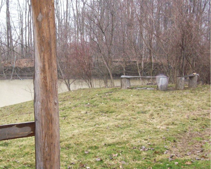

# Posted: 2 Feb 2012 05:58pm
If you forward to 1:15 in this short video, you'll see how we handled fire pit seating at our camp. (3) 5.5" wide boards with a backer board to keep them together as one piece and then placed on top of pine tree trunks. Best part is they can be stored in winter or moved around easily as they are (3) pieces for each bench.

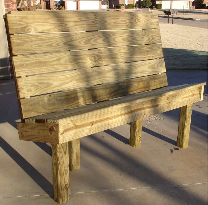

I like the "Leopold Bench":
Simple to construct out of PT 2x's and carriage bolts. Stable, comfortable and cheap.
Google "Leopold Bench"; there are many free plans available online.

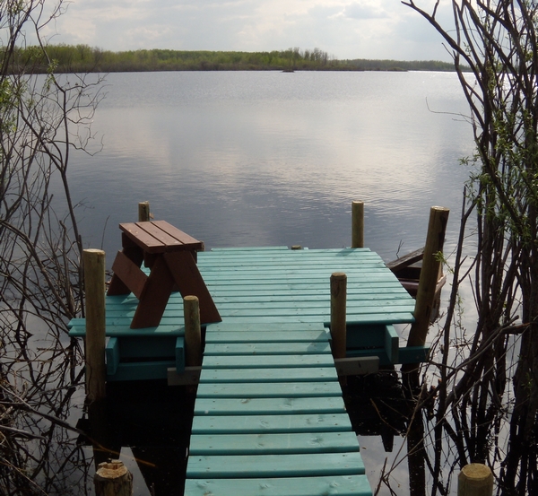

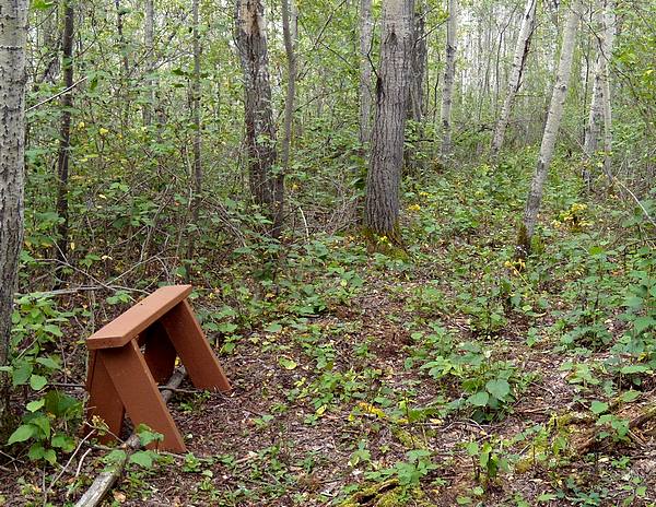

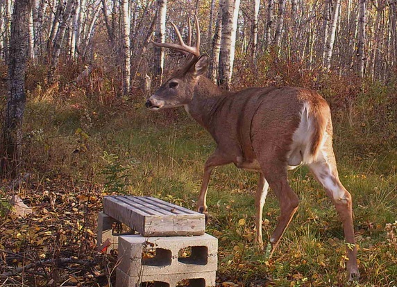

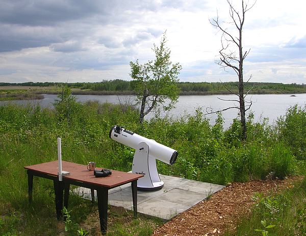

We have tried a few types of benches for around the fire pits, along our trails and for our docks. We found simple 2x6 legs with a deck board to be quite comfortable along the trails and light enough to haul out to the best seating areas. 2x4's on cinder blocks work well for places where we can access with the truck. And for some reason a table I made for holding telescope paraphernalia has become our fav morning coffee seating spot
We try to get all our lumber for the seats used from our reno store so sometimes things don't quite match up.... but only we see it and the wildlife does not seem to mind. trail bench

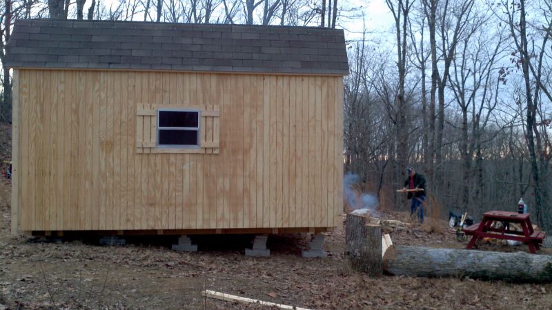

vandersysml
# Posted: 4 Feb 2012 02:27pm - Edited by: vandersysml

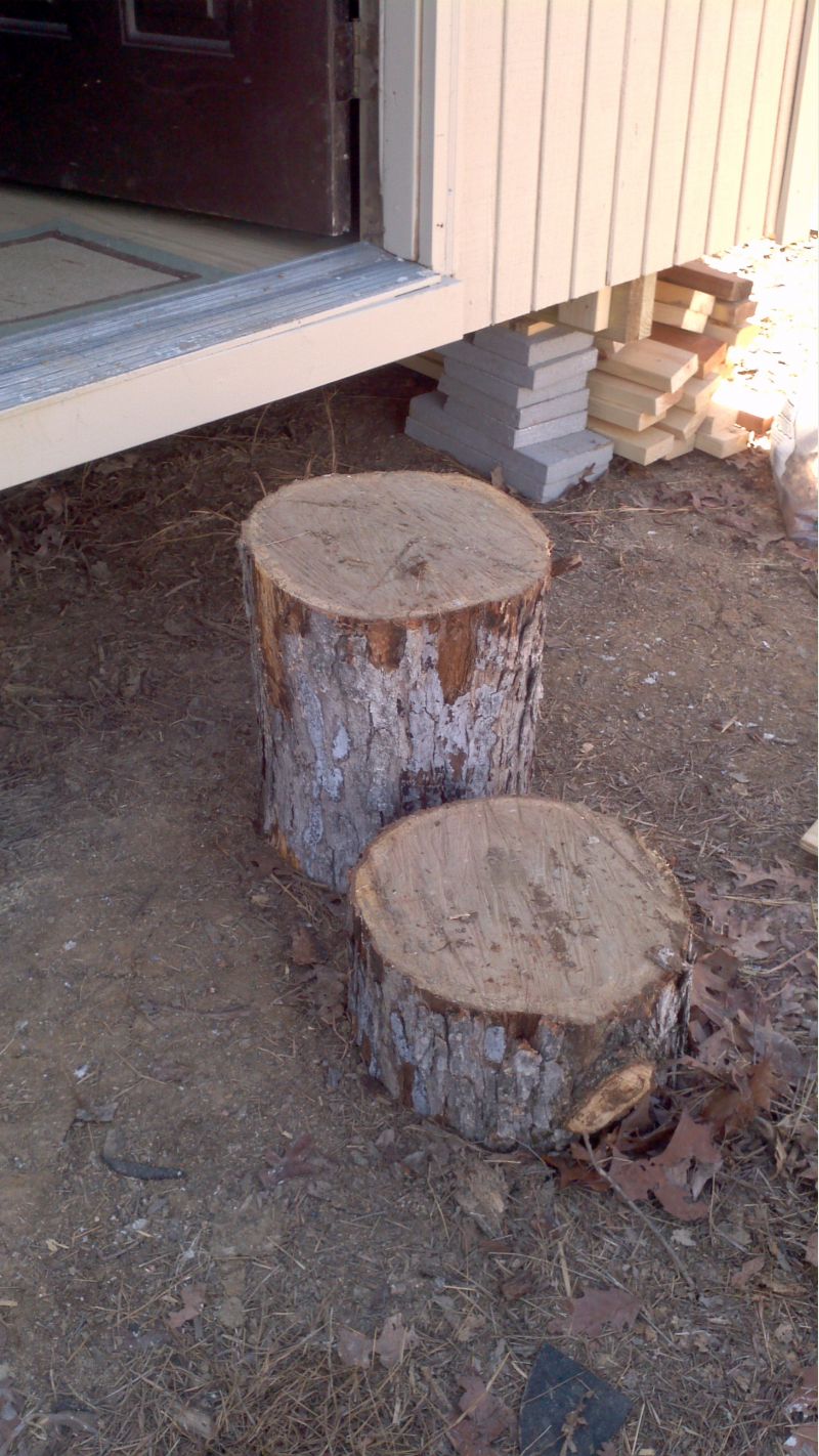

Buggy - IMHO sometimes simplest is best. There's nothing better than a massive log to sit on around a camp fire. The tree that's down next to my cabin in the picture has been moved and is now a bench (about 6 inches off the ground on some rocks). Of course it takes a tractor to effectively move something like that. Plus you give up alot of firewood, but for us it made sense. I even used a couple of slices of the same tree to make a "staircase"

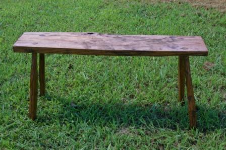

# Posted: 6 Feb 2012 03:30pm
I make benches the old fashion way. I split them from oak logs , smooth the billets with a foot adz and then a jack plain. The legs are shaped on a shaving horse with my drawknife and holes in the seat are bored with a brace and bit. It's all done with no electric tools.
