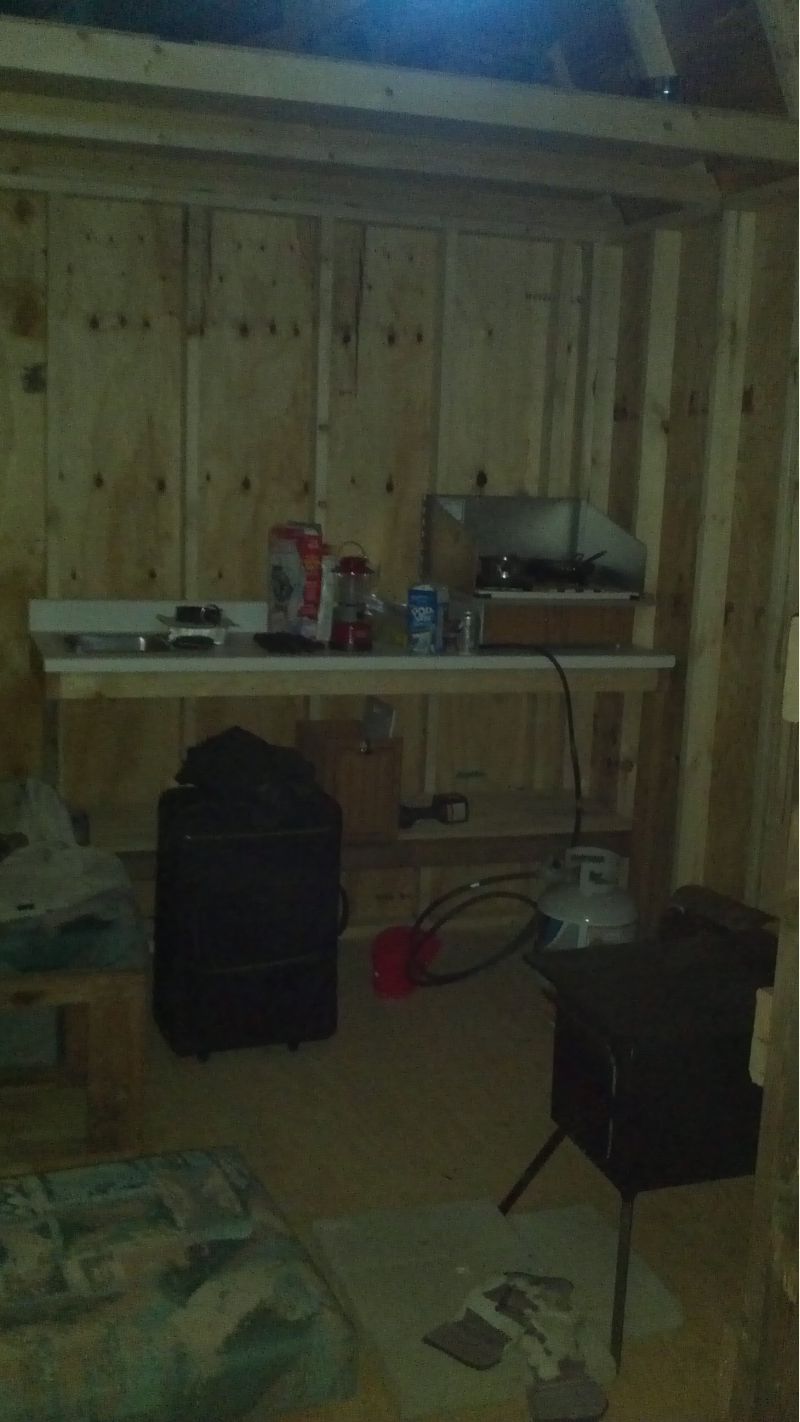

I just finished (well, I guess it's never finished, but it's usable) a cabin on our land in Arkansas this past weekend. I would like to bring my boys - 3 1/2 years old and 19 months old - out to the cabin next weekend. The problem is, I was short-sighted and didn't really come up with a plan to keep them away from the wood stove, which will be a necessity to burn. As you can see from the picture, there's not a whole lot of room in the cabin to begin with, and I'm afraid that if I build some kind of fence around the stove we won't be able to get by. Does anyone have any creative solutions they have used? Maybe something that's easily removable to get by?

Not to hijack the thread, but in the picture I see a propane stove in the background. If the kids turn the knobs will gas come out un-ignited, with potential to be ignited by the wood stove? I went with a kerosene stove because I wasn't sure about this question (and our local thieves take propane tanks). I trust my kids with hot-ouch, but I'm afraid curiousity or a bump might turn a knob during wood-burning season.

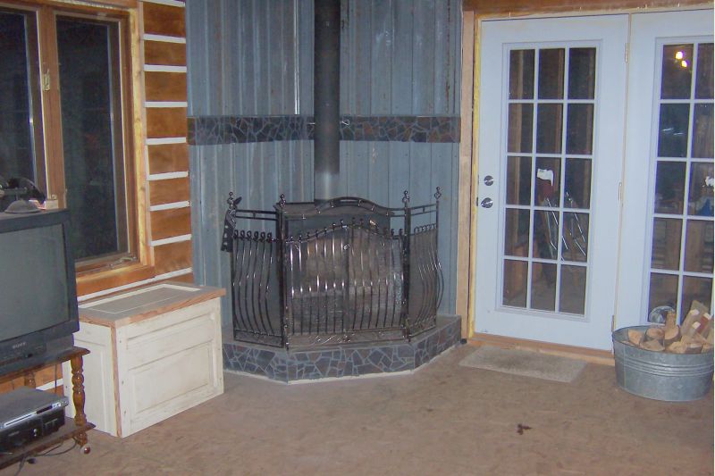

# Posted: 5 Feb 2012 11:27pm
To protect our grandchildren we found a fireplace screen for $29.00 at a reuse shop and I can relax a lot more now knowing they can't accidently fall against our wood stove. Here is a photo...it is pretty heavy duty which helps.
It also doubles for now as a place to hang wet mittens, hats...

# Posted: 6 Feb 2012 12:07am
trollbridge - That is a really nice fireplace screen!!! What a find!!
