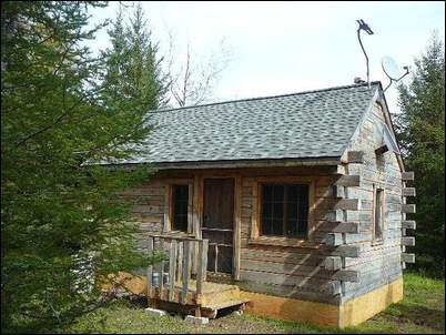

My roof is a shingled roof, not ideal for water containment, but will suit me ok. I also have a shed that is in dire need of a roof, I may put steel on it and run the water into my tank from that. Still up in the air on that, though.

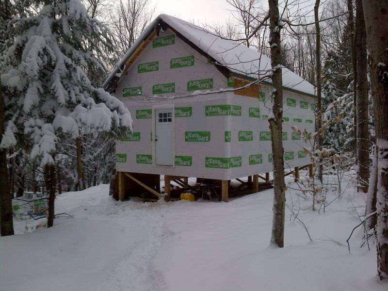

Are you still going to try to build without permits? I needed to get a zoning permit, and they came out and did a site visit. Not sure how steep of a slope you have, but you could run into a problem with unstable ground, mudslides, etc. Zoning would be able to help you out with that. If it seems quite a bit cheaper than parcels of equal size, that might be part of the reason. BEFORE YOU BUY, VERIFY WITH SOMEONE IN AUTHORITY THAT IT IS INDEED BUILDABLE. I nearly bought a property that I later found out was not buildable. Really dodged a bullet there, and learned a good lesson. Not to rain on your parade, just some things to consider.
If you find that you can build on it, I would think building like I described my foundation, on posts, would be the most cost effective. As far as a roof goes, I would think a regular gable style roof with shingles would be easiest.

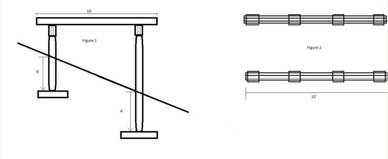

Opti, going below the frostline with piers will be the most stable and last longest IMO, 4 feet down would get you below the frost line in most cases.

Foundation - I do want to use those concrete tubes. I feel they are pretty straight forward in terms of using thme (please correct me if I am wrong) and they will last for a very long time. I do want to have those (sorry for my lack of construction lingo) metal braces embedded into the tubes that will hold, like you suggested, tripled treated 2x10's. My concern is that if I use 22ft ones I won't be able to move them by myself - weight wise, and my wife won't be able to give me a hand. Can I use 12' ones instead?

I will have three supporting beams going the width (24') of the cabin - two on the outside and one in the middle. The joists will then go between?
Or do I only do two supporting beams in the outside corners and span joists in the middle?

JoshG
# Posted: 3 Mar 2012 08:28pm - Edited by: JoshG
Here is a diagram I came up with to illustrate. Figure 1 is your concrete tubes, showing a moderate grade. Figure 2 is an overview of the beam setup. Use four columns per beam. Make sure your splices in each 2x10 lands on a column. Each column needs a footing as well. Joists will go across these beams, and at 16' and using a 2x10 for joists, there is no need for a middle set of columns. Make sure and use X-bridging down the center of the joists though.
EDIT: I made the diagram based off of my dimensions of 16x22. For your application in Figure 2 subsitute 24' instead of 22'.

optimistic
# Posted: 3 Mar 2012 09:59pm
Josh,
Thank you! That makes things clearer for me. So I gather that I will need to cut every joist to fit between the beams?
what spacing should I do between the joists?

JoshG
# Posted: 3 Mar 2012 10:13pm - Edited by: JoshG
No, the joists will sit on top of the beams, and hang over about a foot on each side. (see figure 1) Footing, column, beam, then 2x10 joist on top. 16" on center for spacing.
Also, in your first post you had asked about 24" spacing for studs. You could, but I would recommend going 16"OC for studding. The extra cost on a structure that size will be VERY minimal, but the benefits will be much greater.

jgiffi
# Posted: 4 Mar 2012 01:31pm
Optimistic,
I am in the processing of building my camp in Camden, NY and I have done everything myself so far. Just want to give you a warning when you look at the lot that since you are not an experienced builder I would be careful trying to construct your first place on a slope. A minor slope isn't bad but if its going to be significant then it is going to be considerable more difficult to construct. Also, if you decide to go with a tank you are going to have to think how is someone going to get in there and excavate the hole for the tank (steep slope =$$$) . Remember be patient, it took my one year to get this far, I still want to get a septic tank, well, wire, plumb and insulate. Also, I looked into sonotubes when I constructed mine but by the time I calculated how much concrete I would need and the fact that I couldn't get a cement truck into my site even if I rented a mixer I needed roughly 120 bags (80lbs/bag). You need to make sure that the tubes are reinforced really well before pouring the concrete into the tubes because if they tilt or tip a little there is no way you will be able to move them or at least not very easily! I decided to use 6x6 posts because they are easier to work with and are more forgiving. I believe concrete is definitely a better option if its feasible but for me it wasn't. Spend alot of time making sure your foundation is square because it will make everything else easier as you construct along the way! I had to get a building permit ($150 and its only good for a year) but I find the taxes more frustrating then following the building code! Another thing I will mention is make sure you get something close enough to where you live that you will be able to actually use your camp. I selected 2hrs because its an easy commute and I don't spend the majority of the weekend just trying to get there!
Lot -25 acres $35,000
Building costs to date: ~$6000
Taxes /yr on vacant land $1000
Taxes with new structure and land - who knows?
