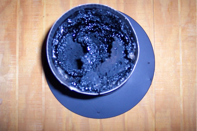

Well, I've been living in my place for 6 months, and this morning, my wood stove didn't want to burn, and even though I have double wall pipe, there was creosote running down in a couple of places. HMMM. I'd noticed over the last few days that smoke had started billowing out whenever the door was opened; something it never had done before. So, when it didn't want to burn this morning, I decided to check the flue. Luckily, its easy for me to do, or at least, relatively easy. I got the ladder and climbed up onto the roof. When I approached the chimney, it was pretty evident that the cap was clogged. I removed the cap and saw the top of the triple wall pipe was practically closed off with a black, lacy, very brittle material. I tried to get as much out as possible, but some fell down into the stove. It didn't extend too far down the pipe, maybe 12" or so, but it had completely blocked the pipe. The stove is now burning at its usual efficient self, again.
What happened? Well, we've had a pretty mild Winter, and I've closed the damper quite often to keep it from getting too warm in the house. In addition, the stove has spent many hours on slow burn while I was at work or sleeping. Even though I use only well seasoned hardwood, the stove wasn't burning efficiently with the damper closed. My stove is rated for 1000sqft and I have only 500sqft of well insulated space. It wasn't the stove's fault, the chimney's fault, or the wood's fault; it was my fault.
I remember reading about how important it is to properly size your stove to the space it will heat. This experience has taught me what happens when you try to control the heat in a stove that is somewhat over sized for the space. I'm not going to change the stove, but I will change my procedures. From now on, I'll monitor the chimney on a regular basis and open a window when I'm home instead of closing the damper. While I'll still dampen it down at night, it won't be as far as before, and I won't load it up so much just before going to bed.
Now, I'm going to use some mineral spirits and try to clean the creosote off the stovepipe. I hope somebody learns something from my experience, but then, maybe all of you guys/gals already knew this stuff.

The wood I use is Bodark, also known as hedge and Osage orange, that has "seasoned" for many years. It is very hard and dense and burns really hot. I just screwed up by damping it down too much.
The easiest way I found to remove the creosote from the chimney cap was to use my propane torch and burn it off. The little streaks down the outside of the stove pipe weren't even touched by mineral spirits. But, I have a nice clean chimney again. Just in time for a little cool weather later this week. Good thing a friend has a chinmey brush and extensions.

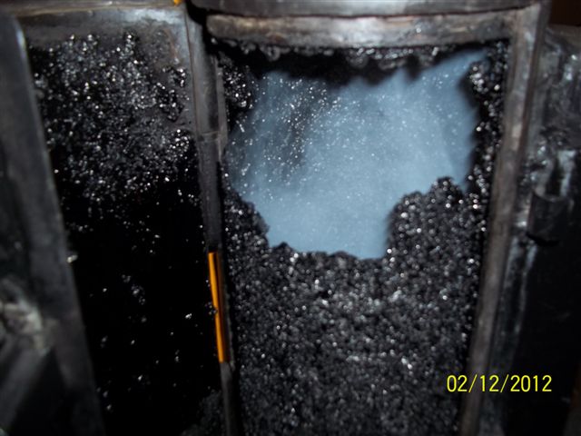

I am not one bit worried about a fire. Heated with wood for a decade+ with a heavly modified blazeking fireplace.
I have settled in to using Birch or Tamrack, but used all types over the years. Keep it dry let it dry out for at least one year, in racks not a pile.I have mine sit for at least 2.
Remove the cap completely, once I did that it cut creosote down by half.I suspect the fires that burn homes down are caused by the creosote that falls off this cap. I put the cap back on in the spring just to stop rain.With the cap on I was getting staining around the base of the stack.
Keep the chimney as short, and straight as possible.
It takes a lot of creosote to burn. In the pic you can see the creosote, but it is really a thin 1/8 thick layer after a week or two with the air choked back. I just burn it out with a hot fire, or let the fire cool way down, and often as everything contracts you can hear it break away, and fall back into the stove to be burnt.
When I say I dont worry its not because I am careless its because I check the chimney at least once a week. In the pic you can see the short section of chimney with the door swung open.(I choked back the fire so it would smoke for the pic) Checking is easy I just swing the door open, lean in,and I can look straight up, and out the top. Takes all of 15 seconds to do, and no having to go out side when its -30-40. I think with how tightly you can control the incoming air in theses new stoves having a run away chimney fire is much less likely.
