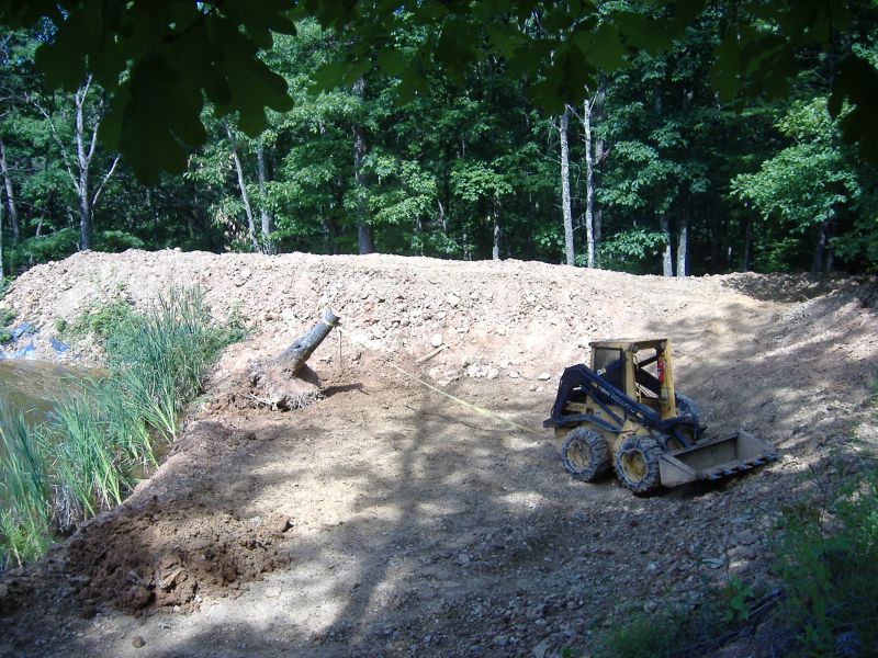

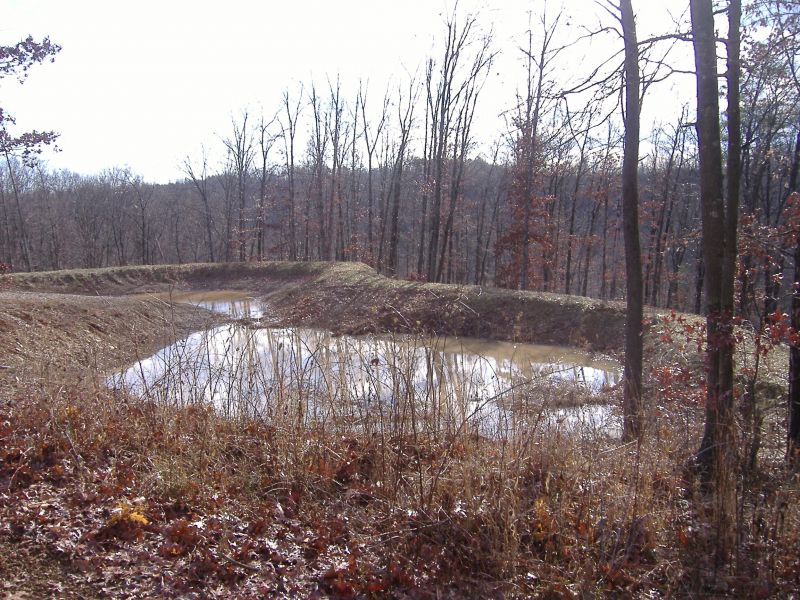

I like your idea of digging a swimming hole with a skid steer loader. I have a mid-sized loader that I used to dig a 1/3 acre pond at my wilderness property. The topography of the pond site was not ideal and I ended up putting 110 hours on the machine. The result of my efforts is a pond that remains 4 feet below the designed waterline. So, drawing on my experience with this, I will share a couple of tips:
1) If you plan on relocating more then maybe 300 cubic yards (I relocated more than 1000), I would hire a larger machine and someone to operate it. Since you are building a swimming hole, this should not be a problem.
2) You mentioned that your soil is sand. Sand is prone to seepage. I will correct the leak in my pond by adding a powdery substance called Sodium Bentonite. You can research this product yourself, but I will just say that it is a natural product mined out of Montana. You mix it into the soil. When it gets wet, it swells 15 times its original size and turns to clay. In my area, it is available from a local feed store for about $11 for a 50lb bag. It is a lot easier to get a good seal with this stuff if you apply it before the pond is partially full. If you have sandy soil, I would plan on mixing this into the pond basin during the construction phase.

Clearing the pond basin
Leaking pond
Leaking pond

My pond was designed to impound water from an uphill watershed. You can't tell from the pictures, but on the left side of the "Leaking pond" picture there is a steep 1 acre of ground that, with the help of a couple of diversion ditches, sheds water into the pond. In my part of the country, a 4:1 ratio of watershed area to pond surface area is enough to keep a pond full (if it does not leak). About 80 hours into the project, a local stopped by in a beat-up truck and told me, in his high-pitched Appalachian voice: "It won't hold no water". He was right. I will fix it with Sodium Bentonite, but it is going to cost me.
