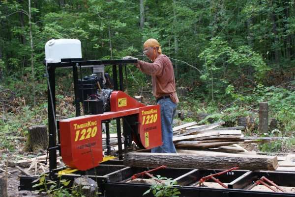

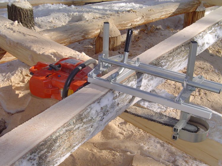

 I purchased a TimberKing 1220 a few years back.   The machine paid for itself in a short time.  It is so hard to get to my place, it is easier to cut everything for my own use with the TimberKing.
 Much less work than a chainsaw mill.  Woodmizer makes an LT-15 which is similar to the TK 1220.  Woodmizer also makes an LT-10.  These mills run 3k-7k new.
 You can take a look at used mills at the sawmill exchange to get an idea as to what they run.
 http://www.sawmill-exchange.com/Equipment_/Band/Manual_Band_Mills/manual_band_mills.h tml
 |  Chainsaw Mill
 |  TimberKing 1220

 The TimberKing looks a lot like what my friend had built but without the panels which I like for safety.  His base is stationary and the top part is what adjusts.  I do have a question about the jug is that water to cool the blade??  If so what is the flow rate.

 The jug is filled with water, there is line that runs to the blade.  Water is dripped on the blade to keep it cool and clean via a little throttle valve.  The water drips a drop a second or so.  When cutting something with a great deal of sap, like pine, you increase the water.

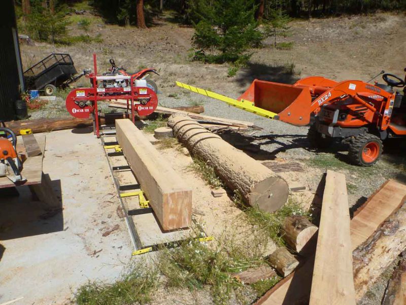

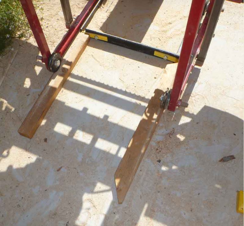

 OK, so I got the Hud-Son Oscar 121.  It works pretty good.  10HP, and they say it can cut up a 21" log if you do it just right.  I put a 16" log in there and I'd say another 5" (to 21) is a stretch of the imagination, it would take a bit of chainsaw time to shoehorn a 21" log in there but I guess you could.  It comes with 12 feet of track which allows you to cut a 9' 8" board.  I needed 10' boards, so I extended the track with wood, and it "works OK".  I will build a couple real 6' sections soon. (Hud-Son sells these 6' track sections for $605 each.  They're just angle-iron, I will build some myself....).
 Having just 12' of track (for sub-10' cuts) is not enough, I recommend anyone contemplating a sawmill to keep that in mind.  You can't cut 12 feet with 12 feet of track.
 I can say I've made some great boards and a LOT of sawdust.  I have a large pile of 2x12s (real 2 & real12).  I'll use the boards for my shower house.  One blade broke, and the other is now dull, so fun's over until I get a new (bandsaw) blade.

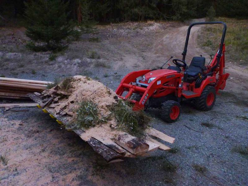

 One thing I can say is don't buy a sawmill unless you can deal with huge amounts of waste.  I have a close-by place to dump it, and will burn it after the rains come (or snow).  Lucky for the Kubota, the waste would be a LOT of additional work.  And this is from a very small mill, slightly larger than the 'hobby-size'.
 |  That's a 9X12.  Cool huh?  I cut it into 2 X 12s.
 |  This is the 2nd huge load of sawmill waste (in one day).
 |  Wood 'track extensions'.  It works in a pinch, and could easily make it better.

 Nice.  You are right dealing with slabs is a pain in the tail.   I use a little jig and cut the slabs up into firewood sized pieces.    I have another pile that will be a very large bonfire once the snow comes my way.

 Yes some of those cants are good firewood, but I already have a lot of firewood.

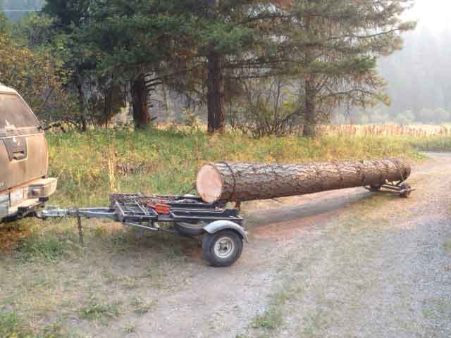

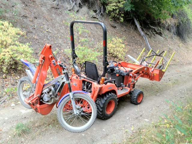

 Headed down to the meadow to cut some logs.  Bringing transportation because I know I'll need to zoom back to the cabin for something.
 Ended up moving the logs with the truck; 6 logs took the whole day!  There must be a better way.  The little tractor can't lift these logs because they're wet.   Its very difficult to get them up on the trailer, about 1 hour per log.
 I need to get a 3-point lift, then with some dirt in the front bucket I think I could move logs pretty well, (keeping them out of the dirt).
 A sawmill is like getting another mouth to feed..... "Got WOOD?"
 |  Like a moped on the back of an RV

 I guess once I buy the mill I need to figure a good way to move logs... I was figuring log arch with ATV for summer. I can move logs pretty easy in the winter with my snowmachine. Getting the logs on the mill might be another story!

 You will learn lots of ways to roll logs, and use their own weight to lift the other half.  The snow has to be firm to move a log with a snowmobile or you just dig a hole.
