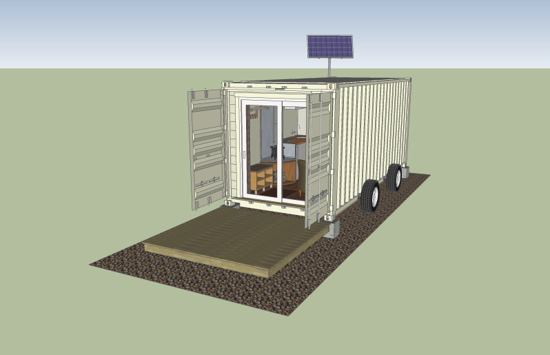

If you're only using a single container, you could always just put wheels on it - even if you never intend on trailering it. Much of the tiny house crowd builds their homes on a trailer to get around the building codes. With wheels, it's just an RV that the building codes don't apply to. You do have to be careful that you don't run afoul of restrictions on how long you can park an RV on your property though.
Here's a design I was working on that had wheels to deal with this exact issue.
