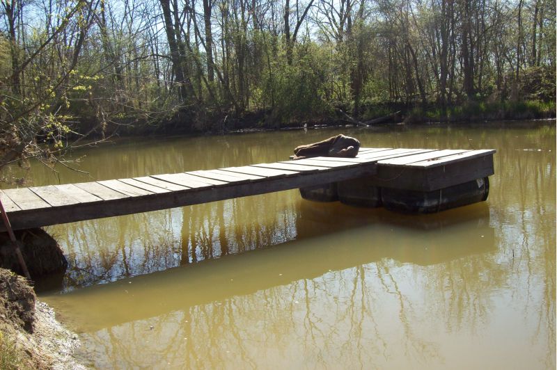

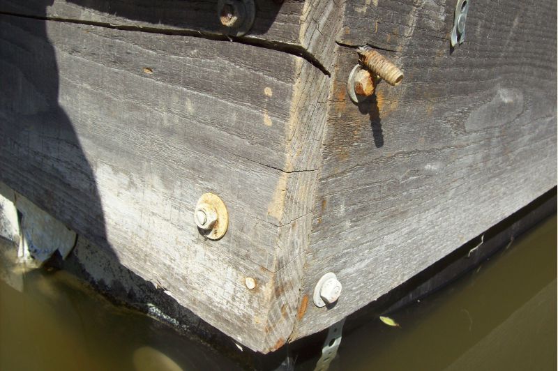

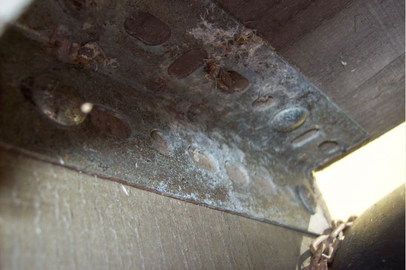

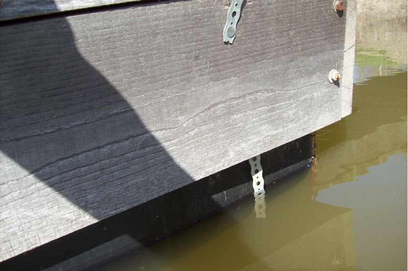

 built in 07 ,saw mill hardwood ,stock hardware 1  2ft 2x2 galvanized angal iron , 1 role galvanized straping  ,3 plastic drums 16 1\4 in x 2 bolts and washers . some galvanized nails.. we are also on a river so one boat  a day .take it out every winter. the water is about 6 ft deep off the end of thr dock . the end is chained to a submerged concrete block .

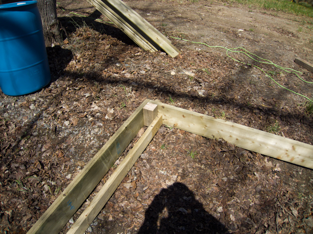

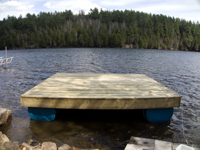

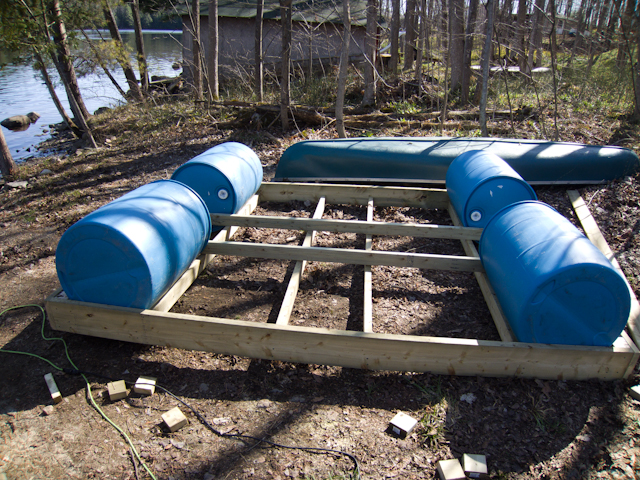

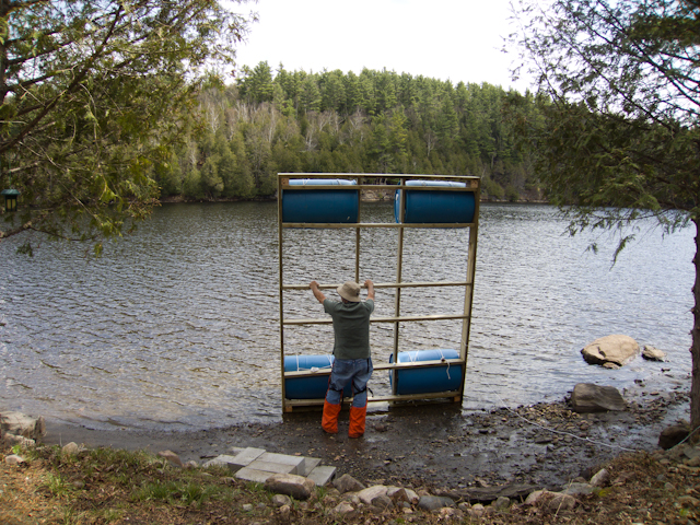

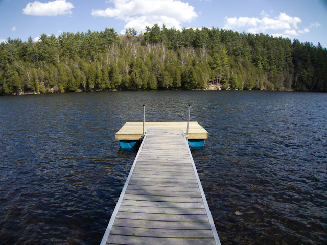

 Just finished building mine today. I used 4 - 55 gallon drums for an 8X10 dock. It looks great if I may so myself. Let me know if you want to see pics!
| bobrok Member
 | # Posted: 19 Apr 2012 09:04pm Reply
 I would!  I'm interested in seeing how you strapped the barrels to the underside.  Did you use rubber hose?
| mojo43 Member
 | # Posted: 19 Apr 2012 09:41pm Reply
 Damn, I forgot to take pics of the strapping. What I did is drilled 4 holes for each barrel and tied nylon rope around it. I figured the barrels aren't going anywhere with the braced wood around the barrels. I think it should hold up.... Let me know if you have any questions!

| mojo43 Member
 | # Posted: 19 Apr 2012 09:42pm Reply
 Here's the last pic

 Thanks for the info and pictures.  You did a nice job there!  Now the heat is on for me to build mine.
