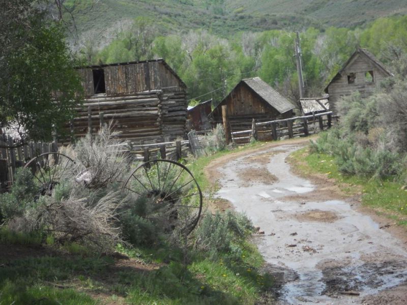

The ranch that has been in my family for 120+ years is being sold and I do not have enough $$$$ to buy it. I am, however lucky enough to be able to buy the one piece from that was set aside years earlier. On the ranch there are several old buildings including the old homesteaded cabin (built in the late 1800's) that I would like to use on my property if possible. Most of the wood is not rotted, but it is very weathered. Is it sound to reuse these logs to rebuild?

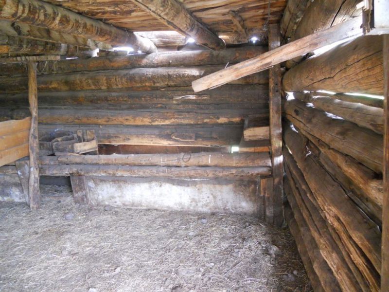

Here are some pictures. The original homestead and addition
|  Barn Interior
|  Old building used to store hay in recent years
|  The old barn

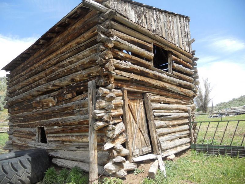

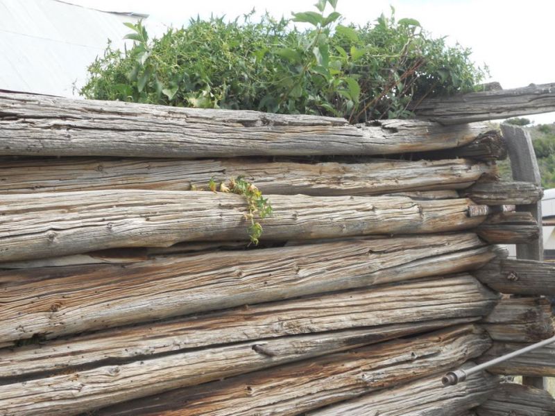

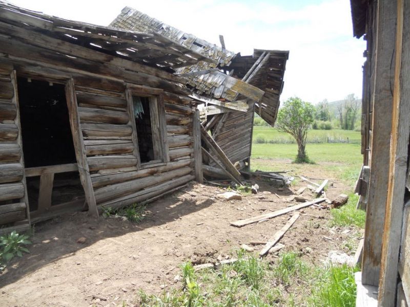

And a few more.
I would really like to use some of these to keep them in the family, but don't know if the weather cracks are a problem.
Thanks A look at some other buildings I don't have close pictures of

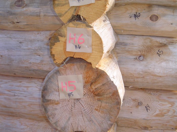

If move them, I've heard of people using a deck of cards, cutting them in half, and stapling the halves on the corners to get a match when reassembling. Use a suit per corner to keep it easy.
Do a google image search of "Old Trail Town", they have many old log buildings that were saved and relocated to their site. Your logs look fairly weathered, but usable. A few may need to be replaced or patched. The new chinking material (Log Jam)is very good about sealing up the joints between logs, and "Log builder" is a similar material that's good for cracks in the individual logs rather than the jonts between them. You'll need to get the logs off the ground, on rocks or other stable material to get a stable building and alleviate rot from the ground.

The cards should hold up OK for as long as you'll be storing it. Some of the card on the cabins at Trail Town have been on them for years and are still readable. Just staple them on with a hammer takcer stapler, or hand power stapler. I'd take digital pics of the corners after tacking the cards on. If you lose any of them, it will make more sense.
