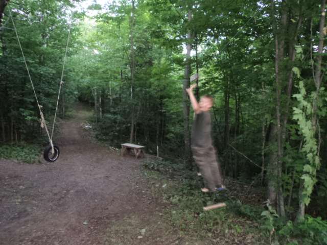

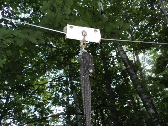

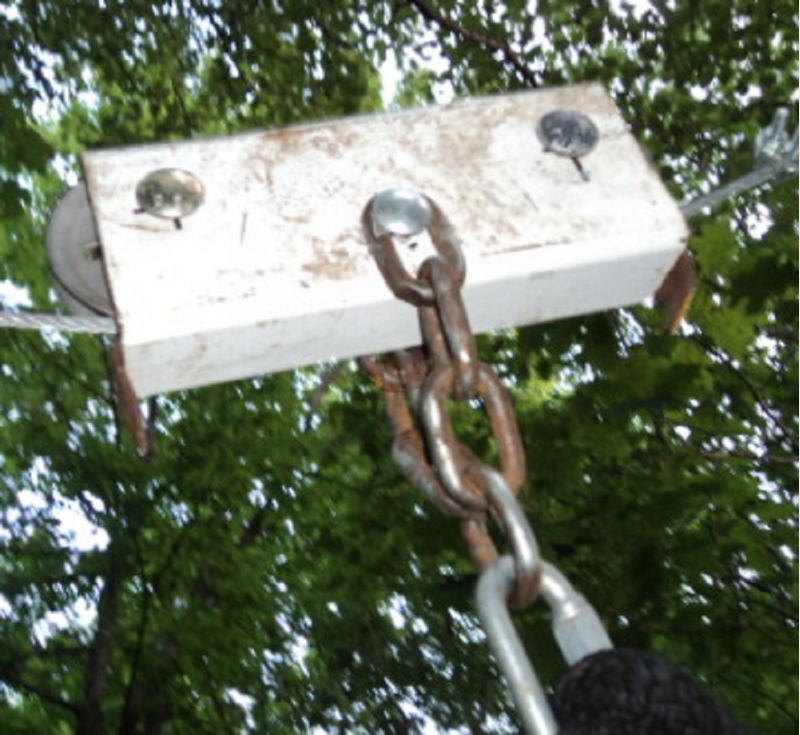

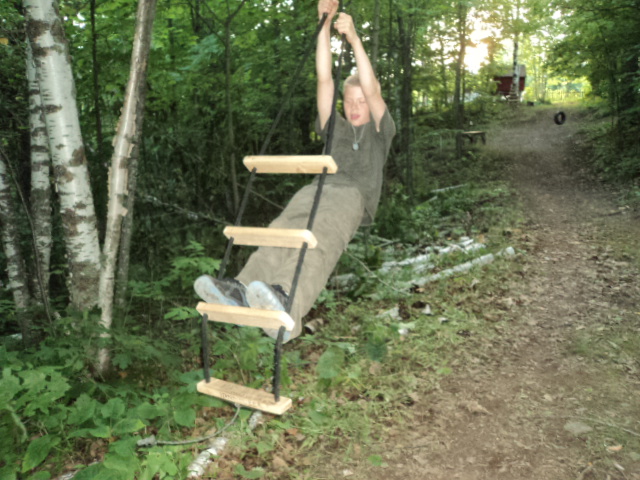

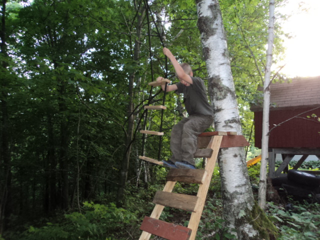

Ok here's what I learned. 3/16'' cable is strong enough for 200 lb. old man. Both ends should be high in the big trees and about level with each other. A drop line from the pulleys should be long enough to keep all fingers from the cable and pulleys. You will need ball bearing pulleys. I tried one from garage door supplys, but one wouldn't stand the weight. Then I used two. A channel iron of about 6'' long and an inch wide would be nice, but the one I had was 1 1/2'' wide and I used a lot of filler washers. The closed side of the channel should be facing down and when you drill for the axel bolts, have the pulleys very close to the channel bottom. that way the cable wont jump off. Some kind of heavier yoke hanging under the trolley would keep it up right. I'll take a picture of the ladder rope that I made as the drop line from the trolly. I made it that way so the kids could climb down a step or two to get on the ground. If the cable is level on each end the sag will give a good start speed and the sag will also slow them down on the oter end. I built a start platform against the start tree. It might be nice if you could use a valley between the trees. I used a garden hose around the cable to protect the trees and two clamps on each end. On the finish end, I used a 2 1/2'' wide ratchet strap to tension the cable. Actually I had to use another one to get it tighter then I could take off the first.
Owen taking off
|  trolly
|  on the way
|  fun

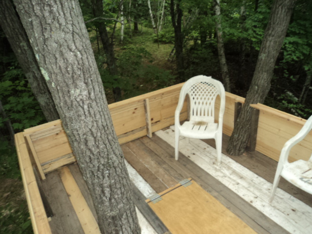

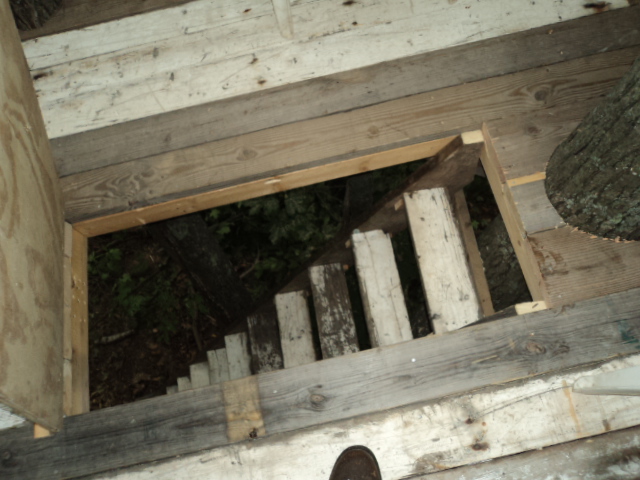

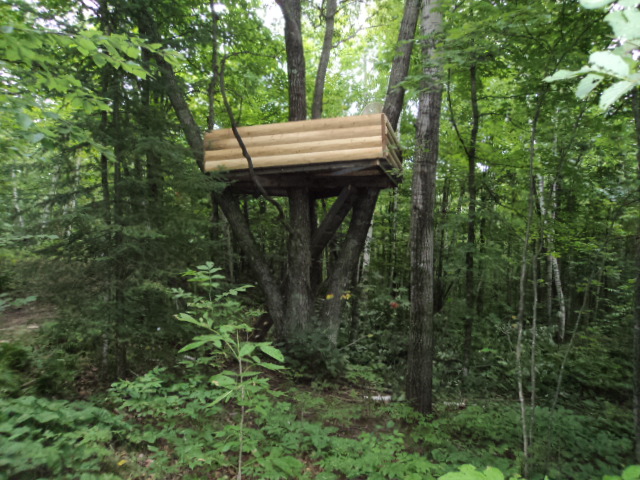

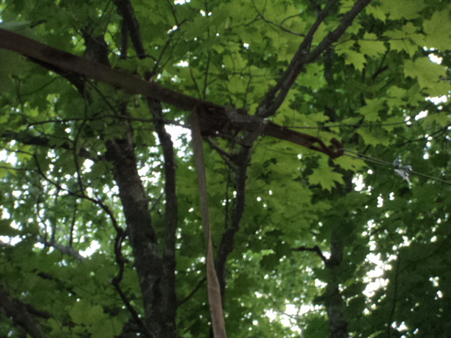

I used a ratchet strap to take out most of the slack. Then I used another one to finish. That put slack in the first one and I was able to take it off. I suppose you could substitute a chain or cable after tightening, but I just left it there. Maybe someday I'll need to slightly tighten it again. Owen ratchet strap
|  tree house
|  inside
|  stairs

Was hoping to see the pulley system.
# Posted: 10 Aug 2012 10:49am - Edited by: OwenChristensen
Look close at the trolley in the second pic. I found that two pulleys are needed, so I made a trolley to hold both. I got lazy and used a chain there. I should have put two metal triangle plates comming down to a single attachment holea few inches on the botttom.
