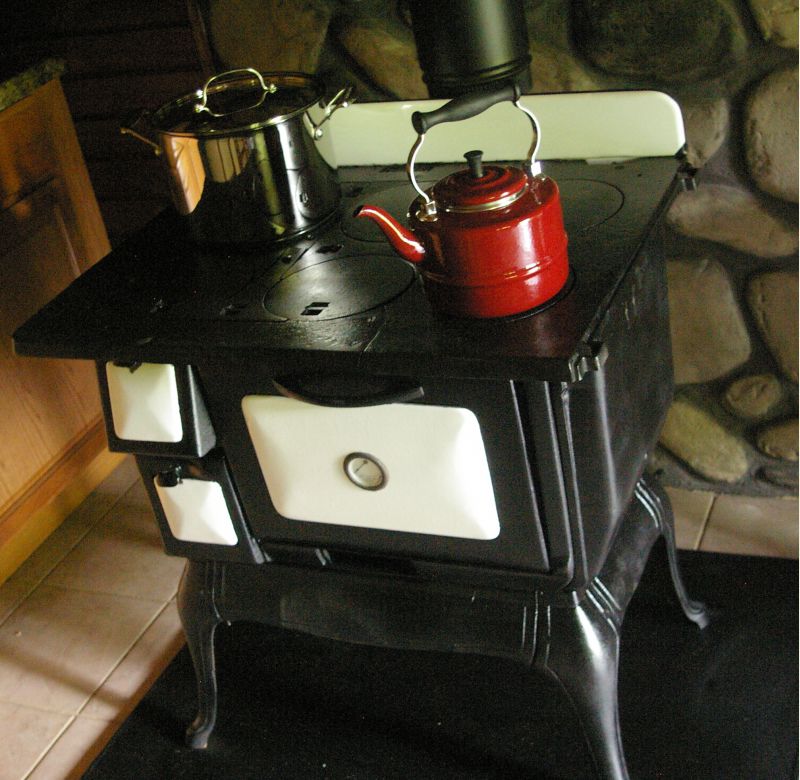

# Posted: 11 Nov 2012 08:38pm
This old stove was prepared with steel wool and then painted with high temperature paint.
reconditioned stove
reconditioned stove
