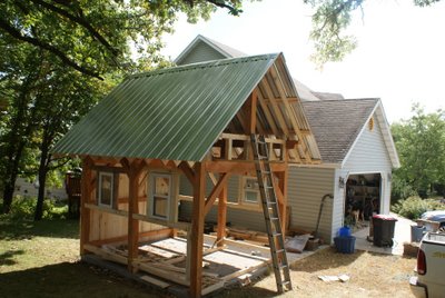

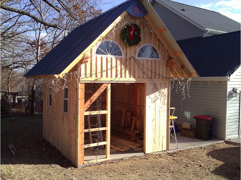

  You can use saw milled lumber for just about anything.  If you are building to codes you might need to check and see if the lumber has to be graded that could cost a little more.
  The photos below show a timber framed 10' x 12' shed I built with lumber right off my sawmill - rough cut.   The siding was board and batten as the I nailed it up shortly after cutting; the battens cover up the shrinkage.
  If you work with someone to cut your lumber, be specific in regards to size.  When I cut 2" x 4" on my mill, I cut at 2" not the 1 1/2" you get from the lumber yard.
  If you are going to use the maple for finish work you will need to stack, sticker, cover, and dry the lumber before you can use it.  Or haul to someone that has kiln.   Remember that you have to cut it a little oversized to account for drying. After the drying is complete you can plane it and edge it to the desired dimensions.
  If you plan to fell your trees yourself, make sure you learn a bit about tree felling before heading to the woods with your chainsaw.  DSC03490.jpg

  I plan on curing the maple boards for a year or so before using them. Stacking, stickering and covering will be in a wood shed I plan on building. I've been using a chain saw for decades, I'm no pro but I do pretty good. Cutting in winter will cut down on the amount of dirt that gets in the bark and cut down on wear and tear on the milling blades. I have a joiner but need to get a planner. Love the shed you built fpw. Trying to get a friends dad to help me when I start my build, he did re-builds of old log cabins and sheds, however he's semi retired and a home body and my land is 4 hours away. When I did ask him last year, the friend said I doubt it, but dad said.. you never know.. so there still is hope
