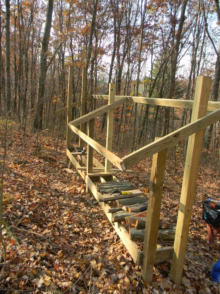

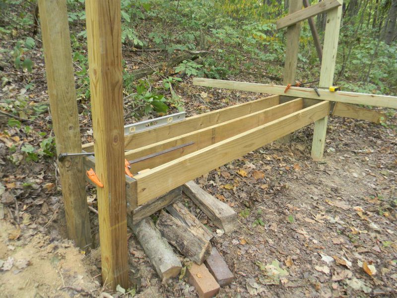

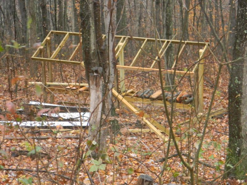

 My work in progress-  4x4, 2x4 and 2x6 pressure treated construction with uprights notched and connected with gavanized bolts.  Roof is oversized, will install minimal sides so that the wind can blow through but rain and snow will be excluded.  A lengthy project when you have "help" from kids aged 3, 6 and 9!
 |  Wood storage in progress
 |  Need corrugate steel roofing
 |  Another view

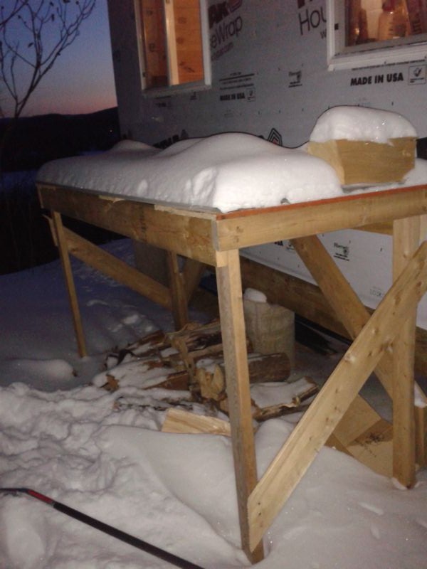

 We built this a few weeks ago.  Not very fancy or long term but it'll keep the wood dry!

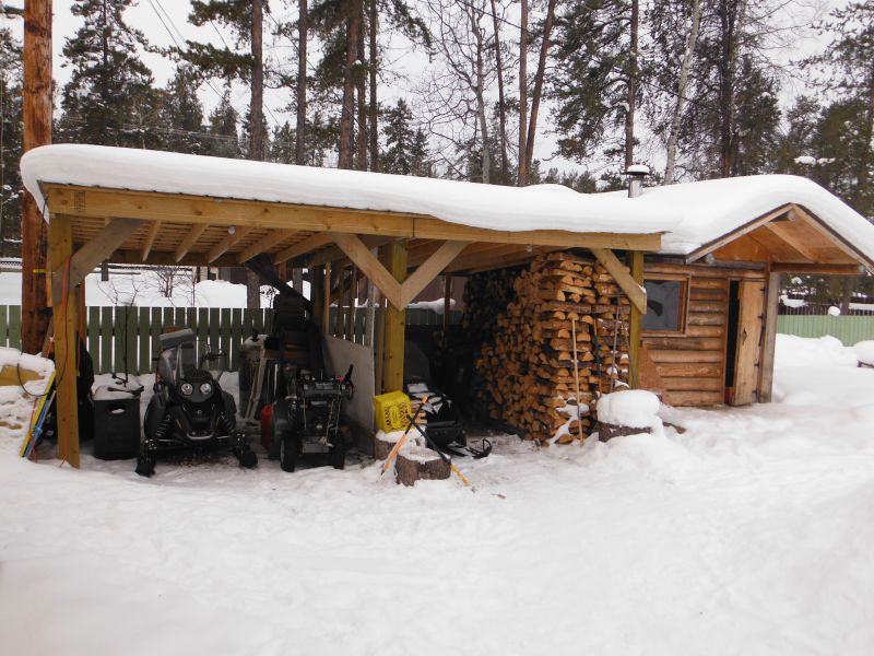

 Not at the cabin, but here is the wood shelter I built at home this spring.  The old one was a bit smaller and much weaker.  I would have to get up and shovel it off twice a year so that it wouldn't collapse.   The roof is salvaged aluminum siding.   The best part of this shelter is the 100 watt lights in each bay.   I still have one squirrel that insists on leaving presents scattered throughout the woodpile so now I can find them when loading wood in the dark.
 Now I just need to build another one because this one is supposed to be full of firewood and not other stuff.   (the building beside it is my sauna).
