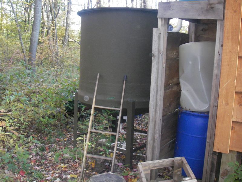

You can always catch rainwater like I do.
-The 500 gal fiberglass tank was free, a cast off from where my brother works, which I painted to blend in.
-Added a home made wooden cover with hinges for access.
-1.5" pvc pipe to the 50 gal barrel which collects water from the rain gutters and acts as a roof washer to collect sediment from the roof.
